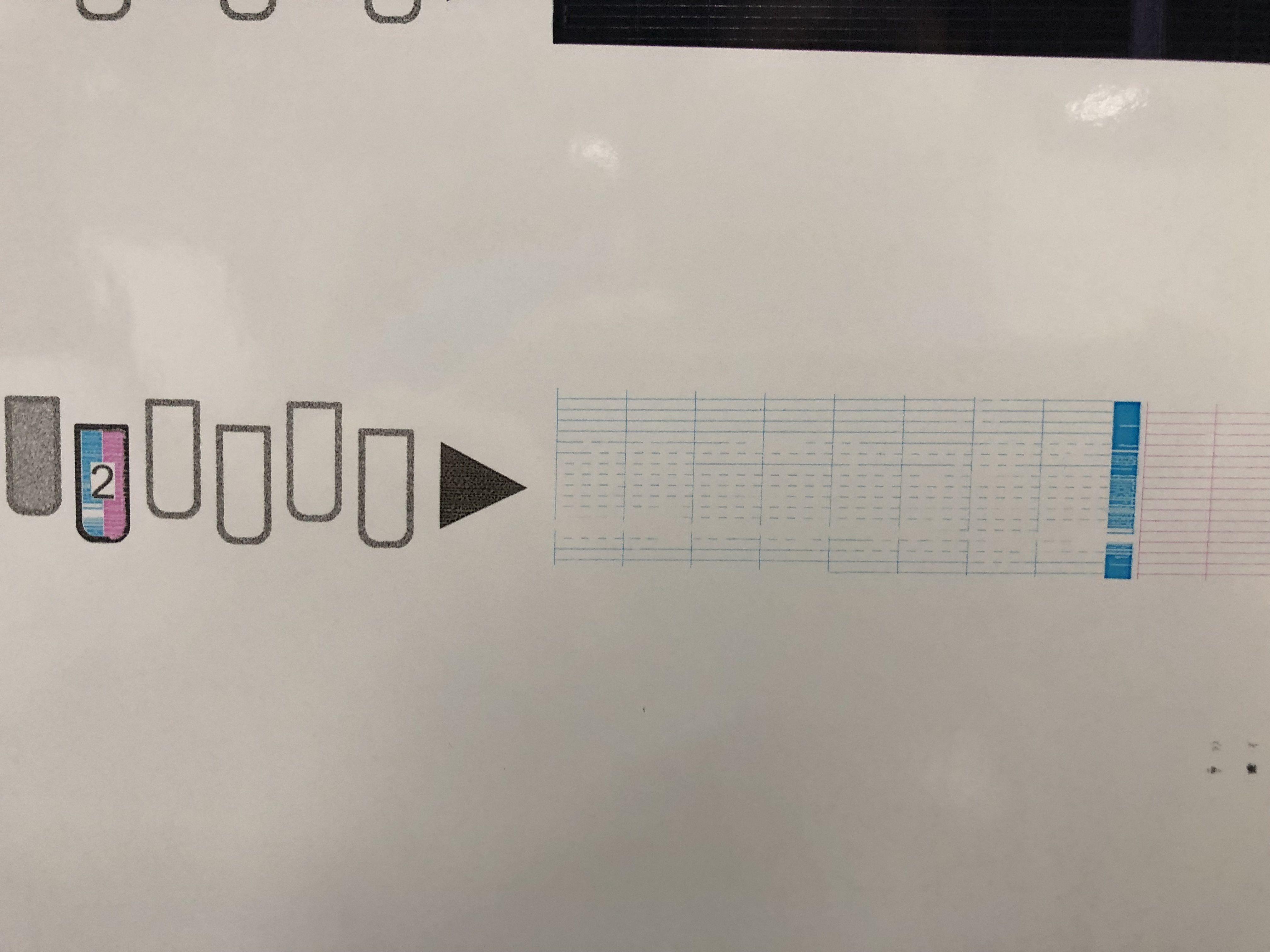

Looks like I need to replace a printhead, but just wondering which printhead #2 is?
I believe it’s the LC/LM
Am I right?
My prints started looking weird in certain colors.

Hi please be sure that you run the printhead cleaning test, also the printhead test plot. Also the screen on your printer will show you exactly what printhead is the issue.

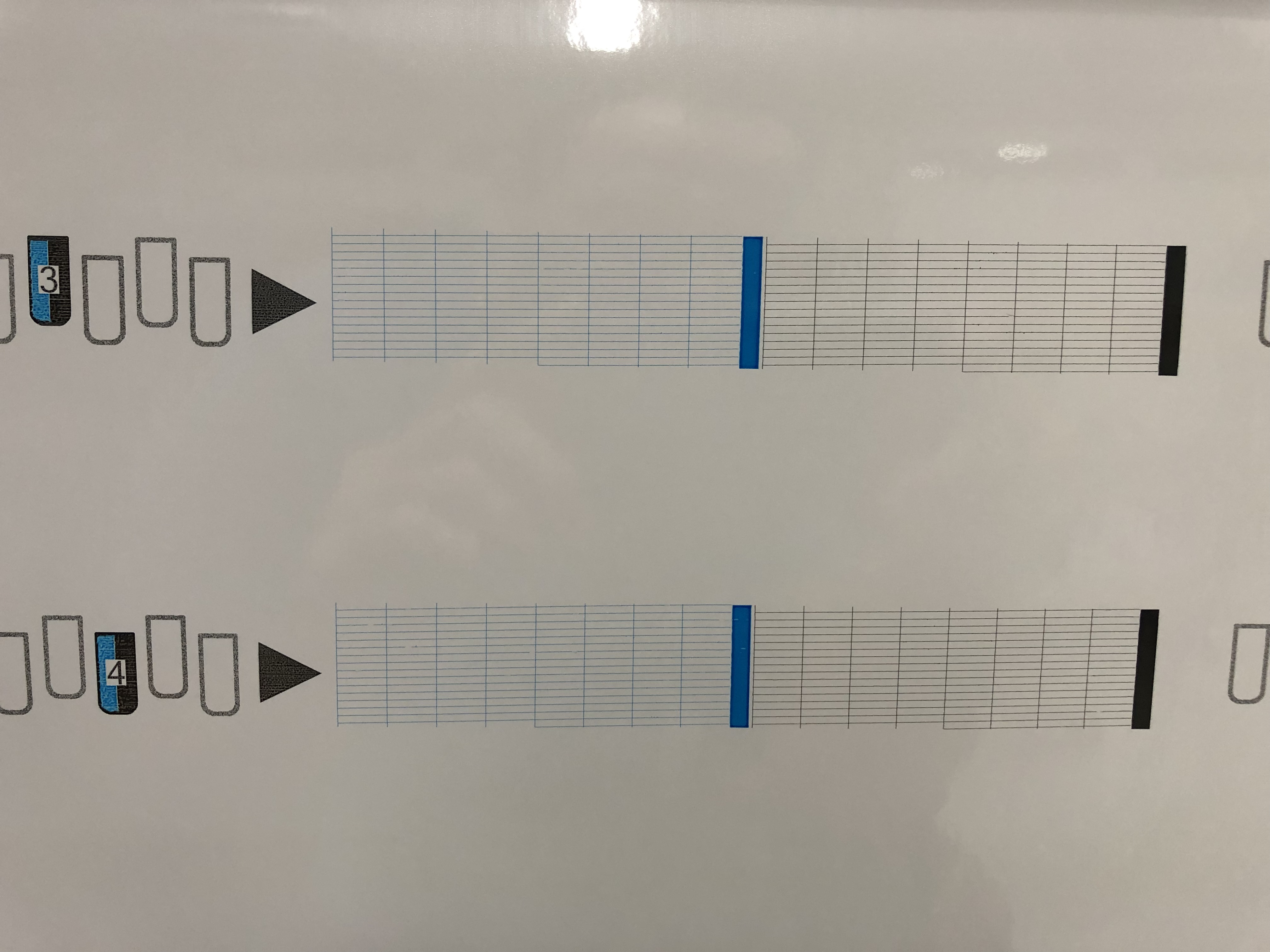

Well as you can see I ran the printhead test plot, as for the cleaning I ran two to no improvement, and the printer says printheads are all ok.
Ive ordered new printheads, so I will replace the bad one and have extras for when the others fail....
