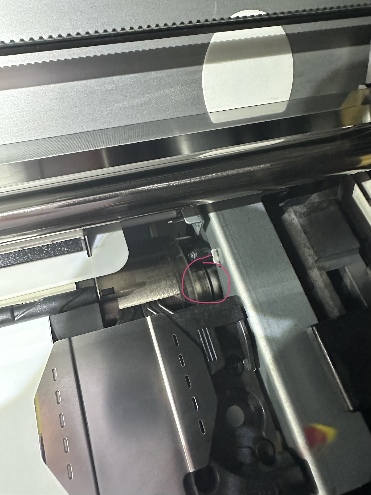

Ugggh turns out it wasn’t the spindle. My wife diagnosed the problem yesterday but when I came in to grease the spindle this morning I realized that the squeal is coming from the body of the printer.
Our HP techs haven’t been much help and my wife is on the phone with HP support but I figured I’d come back here in the meantime to see if I could find any more clues. I can’t find a parts diagram online so don’t even know where to start looking.
Fozkat
Ended up greasing everything we could and found the problem to be located at the end of the heavy metal roller. If anyone else ever has this problem, just a few drops of oil fixed it right up.
