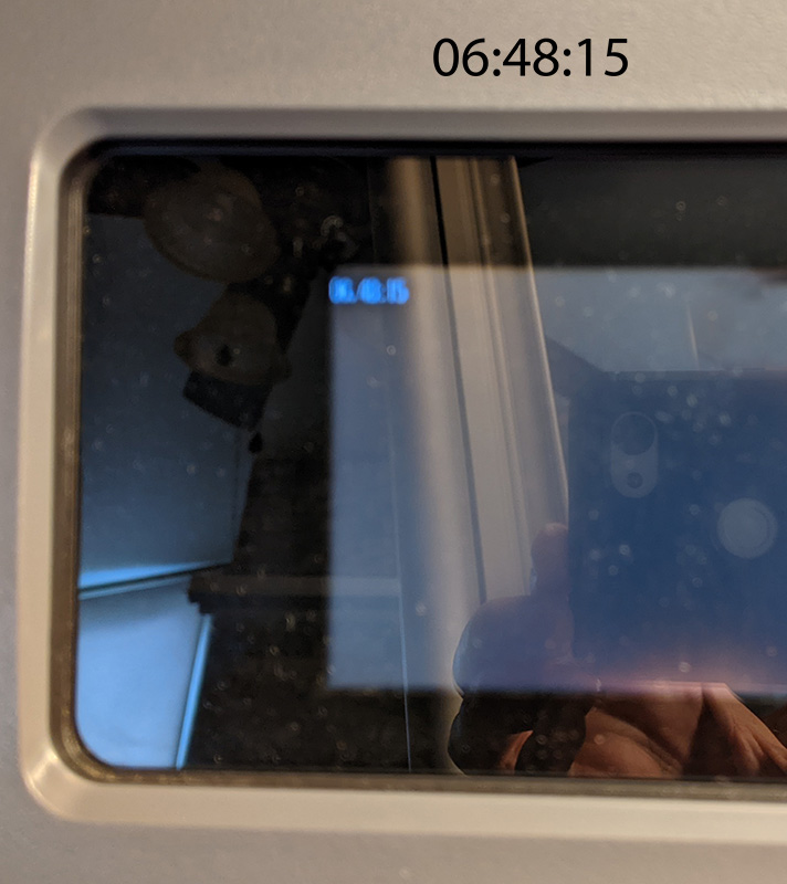

Here is the error that it shows after turning the power back on 06:48:15
I have tried to look it up and not found anything. In the past we would just call HP and they would have us unplug it and turn off the switch on the back, wait a little while and plug it back in and flip switch back on. I think that was all they had us do, which didn't always work on the 1st try. The last time I called they had me update the firmware which I did and then it worked fine. Until the power went out today and I now have the same error. I have tried unplugging it a few times, still getting the same message though.

How would I get to that menu? When the printer starts its just the HP screen and then a black screen with the error code on it. I was able to update the firmware to the latest using a usb drive plugged in the back. After it was done though it restarted and has the same black screen with the same error code. Any help would be greatly appreciated as the warranty has already ended. The printer has not had a lot of use so I am surprised we have had so many issues with it.
This is the first screen that shows up, you done get anything else on that screen and then it goes right to the next image.

This is what it shows and it just stays like that.

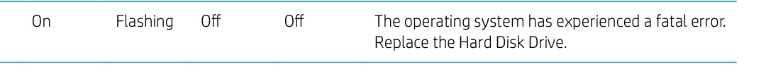

There's 3 LEDs close to the ethernet port. What do the LEDs show during the boot up and during the error?

The 3 LED light on the back going left to right. 1 is off, 2 is blinking, and the 3rd is on.

The order is opposite of what you said but this is the meaning.

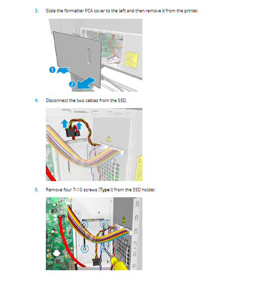

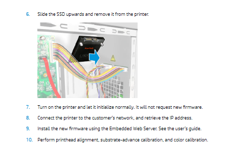

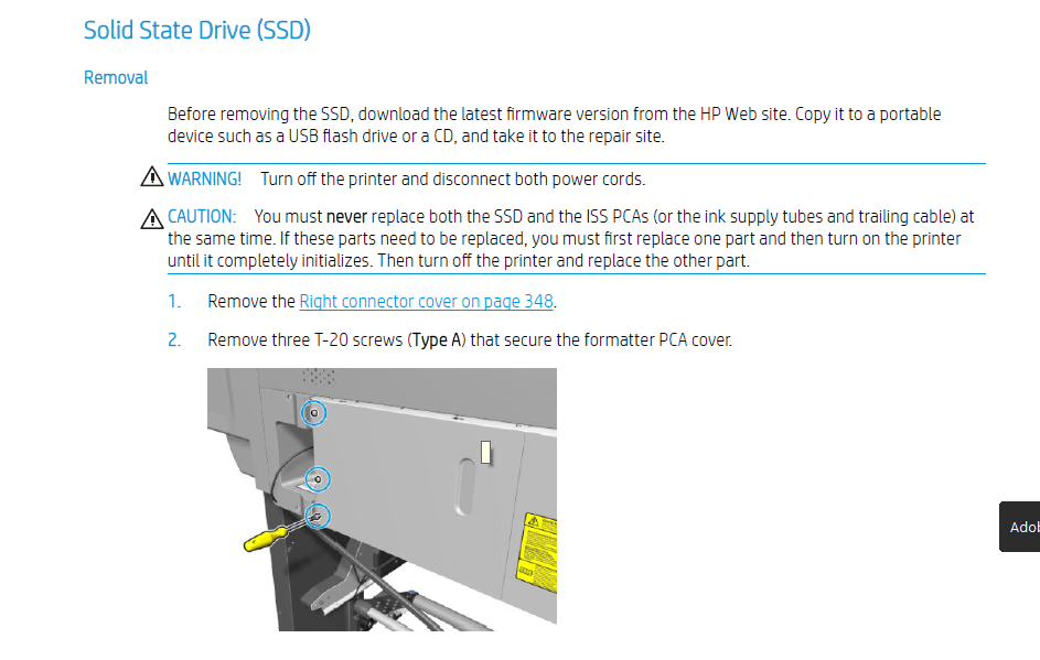

Is this it? Manual says to install firmware with the web interface but I would recommend installing firmware through USB
