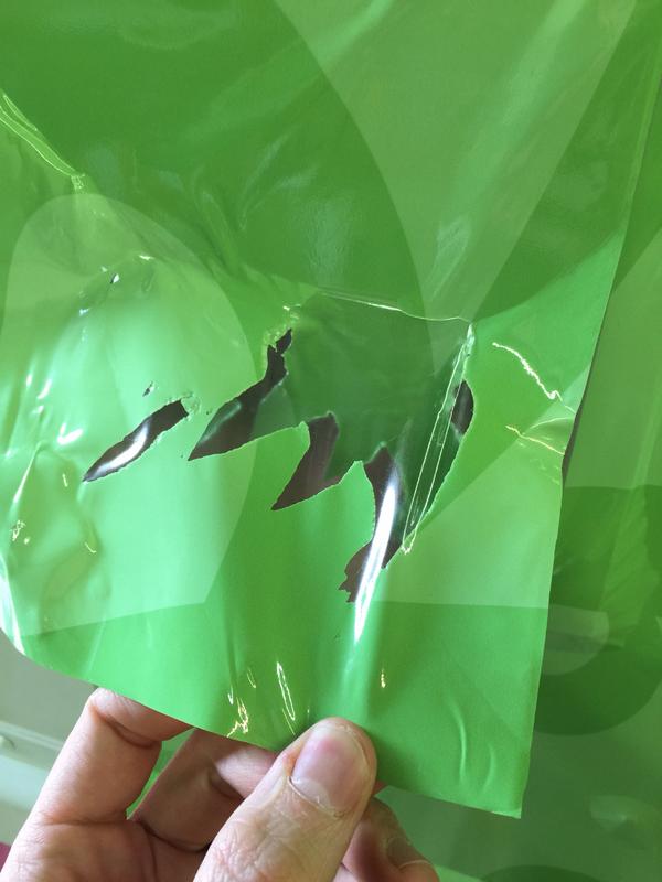

Would it be too difficult to post a picture of the problem???
I suspect the ink isn't fully cured, which can be tested by rubbing a wet white towel over the print to see if ink releases. Temperature alone won't cure the print if the profile is dumping too much ink. More passes won't solve the problem either if the profile is bad. I would not dismiss the possibility that there is a problem with the printer.

Here's a photo. Lamination comes off clean, leaves the printed vinyl behind. A real bummer when it's in the middle of a large panel!

Doubtful that it's the laminate since we've had 3 different kinds fail (Arlon, 3M, 3rd party). Could be but doubtful.

This is simply a matter of turning up the optimizer level. The optimizer "ink" is what helps the latex ink stick to the vinyl.
Actually, I found the problem! You need to cure it at a higher temperature. If you don't it leaves a "waxy" film on top of the print. Temps below 110 c should only be for aqueous receptive substrates.

My guess would be it has something to do with the way you are laminating the prints if everything is cured fine.

The canned profiles are a good starting point but we need to build our own profiles to create uniform output across all of our presses. We use an i1pro2 with an i0 table to build all of our profiles. We should be able to lay down as much or as little ink as we want (within reason) and still get usable output off of a latex. That's one of the big draws to latex is the ability to oversaturate prints, especially for backlit applications. Also being able to tweak profiles to hit stronger reds, etc... as long as the ink is dry, we should be able to laminate in my opinion. Granted I'm kind of new to latex but I have quite a bit of experience building profiles and printing with solvent, eco-solvent, aqueous, and UV printers. The darn wildcard is still the optimizer, I'm almost convinced our issue has something to do with this new addition.

When you start losing detail with higher ink settings that is a clear indication that your OP need bumped up a little. There is a nice onboard test that will show you what effect different levels of OP will give you.
Back to your laminator are you sure you don't have a flat spot on your rollers? Is the delimitation area random or is there a pattern to it like the circumference of a laminator roller?

No pattern to the delam, I think the laminator is good. When it fails, it's usually in a ripping pattern similar to the photo. I know what you are talking about though, we used to fight a flat spot on our old laminator that drove us nuts in the old print/lam/mount days before we bought our flatbed and new laminator.

I think you need to fully investigate every part of your workflow. Is the material stored correctly? No source of heat hitting stored rolls, like the Sun or a space heater? Is ther a cat on the premises? Any way that contamination is getting on the prints? Since you are the only one with this problem and it doesn't matter which material you use, it leads one to suspect that the problem is user related and/or environmental. Could be an install issue, perhaps the material is heated too much with the torch in some spots that then later fail.
FishnSigns
Super clean shop, our entire facility is HVAC controlled, hate cats, no dogs (love dogs), our post heat/torch process hasn't changed in 8 years (could be a fluke but we've laid down a lot of vinyl). Good ideas but I think we are covered. Has to be a printer/install/profile/ink problem in my opinion. I'm still open to trying different things to solve the issue, just seems like everything we try/adjust doesn't fix the problem. I'm hoping for a reply from HP after ISA. They have material samples in their lab and have their experts looking at it. Fingers crossed.
