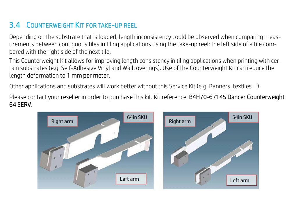

Has anyone used this extra kit to his 360? They call them Counterweight dancers or something. Anyone? Impressions?

So they discovered them after releasing 365. Users with 360 do have problems? They are extremely expensive as I checked

We have a 360 and it was retro-installed for free as it was still under extended warranty. I know it was intended to minimise the fluctuations in print length over multiple tiles, but to be honest it didn't make a noticeable difference. It seems to me that the weight of the take-up is only one contributing factor - even when not using the take-up there are issues with panels not lining up.
Unfortunately, there was a massive negative that results from the counter-weight - now the media moves around A LOT on the take-up roll. It seems that the original heavier weight of the take-up bar helped the media run straighter. Without it, the media moves around side-to-side, to the point where, without constant intervention, it'll cause one side to be so much looser than the other that it lifts and causes head strikes, even with the edge holders. With the counter-weights removed, you can let a full roll run overnight without issue.
TLDR, I wouldn't buy them if I had to pay for them, and they were more trouble than they were worth.

If you do paneled graphics, they help a lot (along with rotating every other panel 180*). It can cause the take up to shift side to side if you don’t load the media perfectly since it makes the dancer bar lighter.
We found them invaluable when we had several wall and vehicle wraps over the course of a couple of months. We used long run preheating, rotated every other panel, and placed them on the take up reel as straight as we could, and we ended up with very little to no uneven stretch on the seams.
We didn’t pay for ours either since we were still under warranty, but if I had to pay for it, I would. The frustration of panels that don’t line up is way more nerve wracking than shifting take ups to me.

So all these line up problems on paneling is a HP "feature" as I see. With solvents there are no such thing lining up panels etc as far as I know. Why all these happen? Also HP as I see are like macbooks. Buy the Mac and then the adapter to the adapter for the adapter. All these counterweights, output panel covers, too many things to have a good result.
