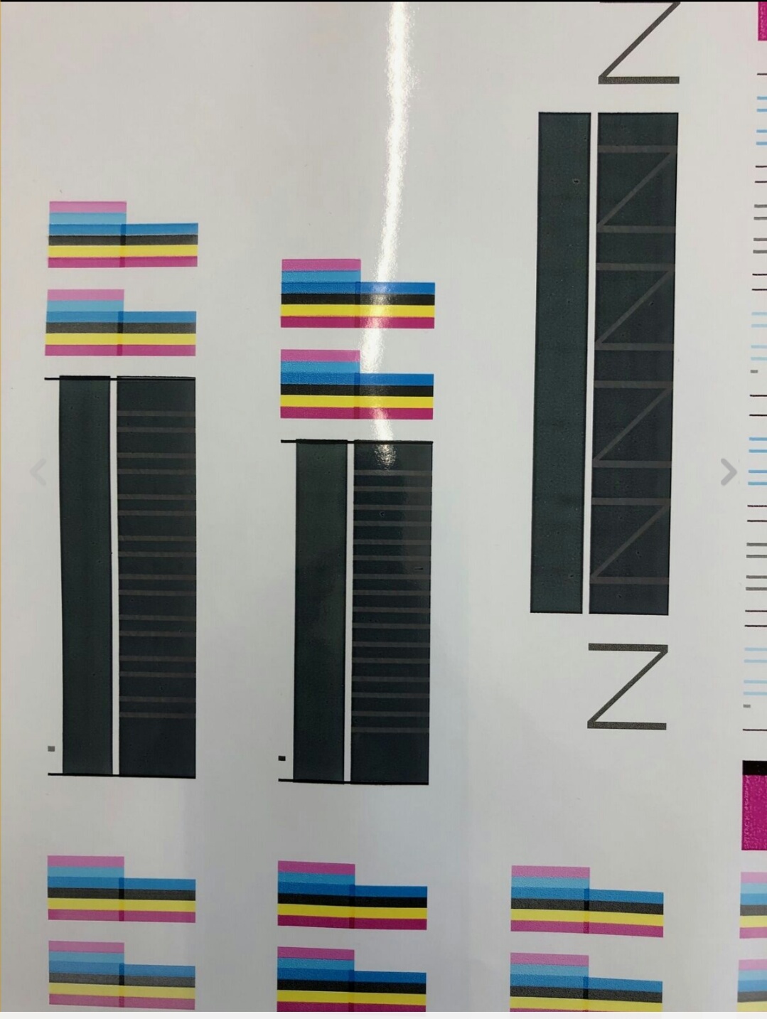

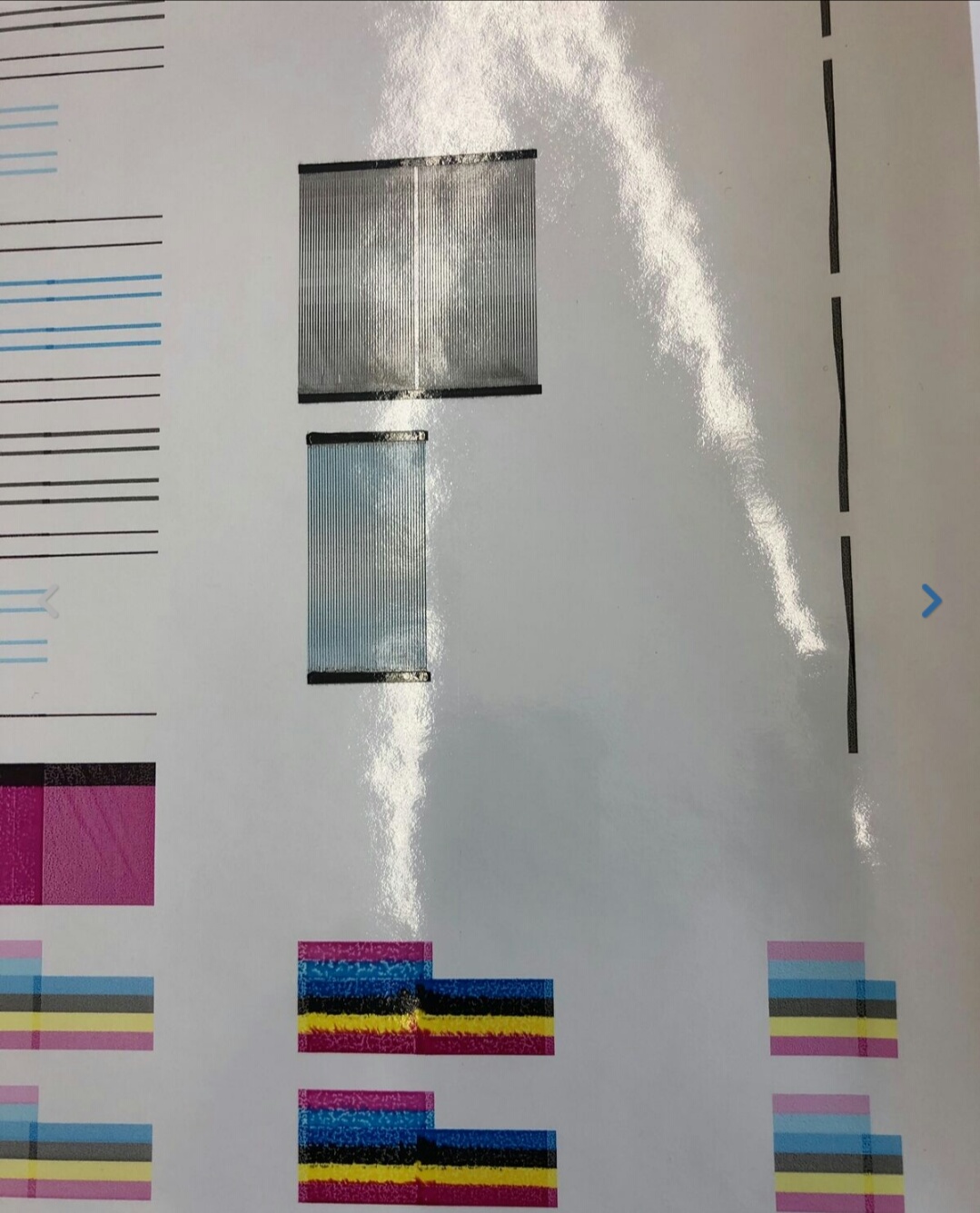

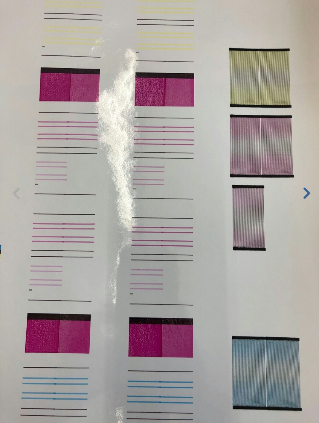

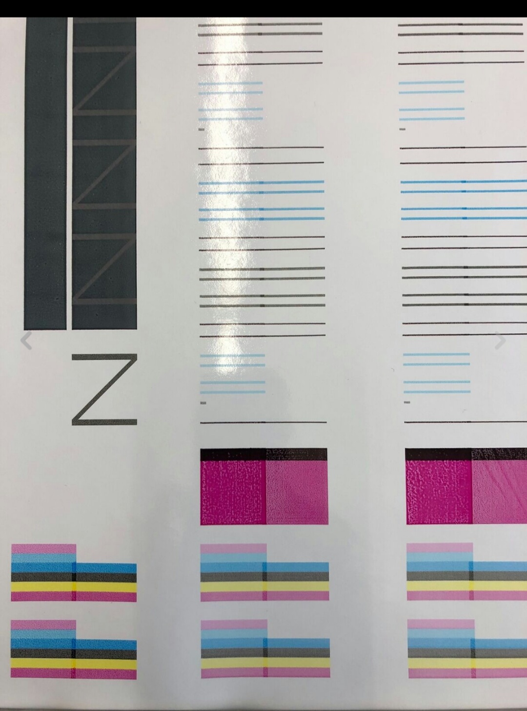

Hello I am about to buy a used 360 latex. I attached photos of the print test. I would like from owners to tell me if the test is ok or has problems. It has 40.000m² printed and 280.000ml ink. Are these huge numbers or normal? Please reply asap!
Thank you in advance

looks relatively normal. i run a 560 so unless its wildly different, which im fairly sure it isnt, it should be okay. keep in mind those heads are user replaceable and cheap so you may want to drop a new set of heads in there to start fresh at 0 on everything. id watch it in operation if possible to see if there are any strange happenings.

Thanks for replying. 38.000m² is it normal? I mean would it go more?
Also in photo 2 and 4 there is something like fading in the middle of the horizontally lines. Is it normal?

The print head alignment looks normal.

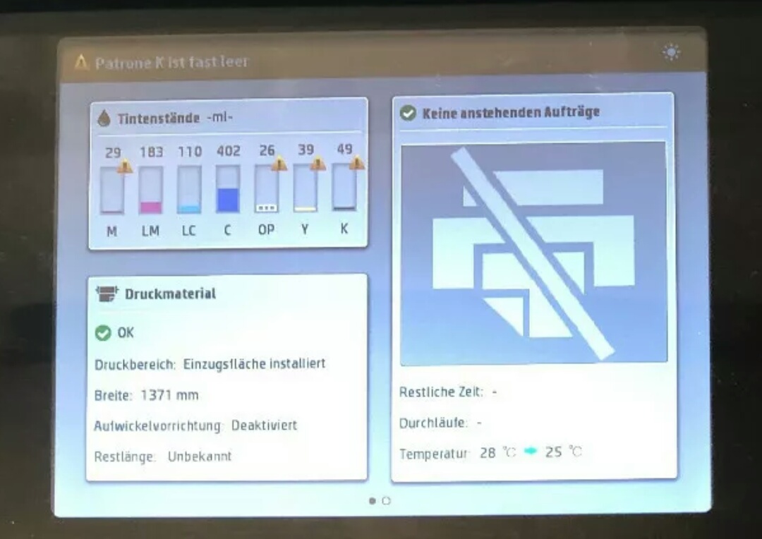

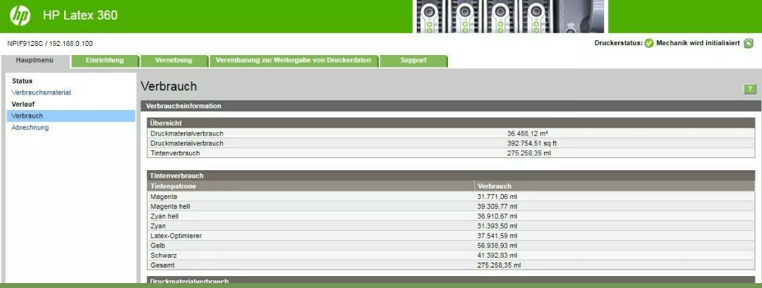

I've uploaded some info from the server. Please check and let me know
(They are in German but I think someone owns this printer will understand)

Service Maintenance Kit 2 is 15% and Kit 3 is 44%. Both of these numbers will vary depending on your usage too. Click the usage tab to get ink and substrate usage to date.

So the 15% and 44% are good? Meaning it has life to print? Sorry for my questions but it's the first time with latex

Yes .. you still have print life before changing kit 2. We had service done for kit 3 so they did a thorough cleaning at that time. I would also recommend extended warranty as parts can get costly. My next assessment would be the cleanliness of area kept in and general cleanliness of the machine itself. The cooling and heating fans should be kept as dust free as possible. We are very happy with our printer to date.
