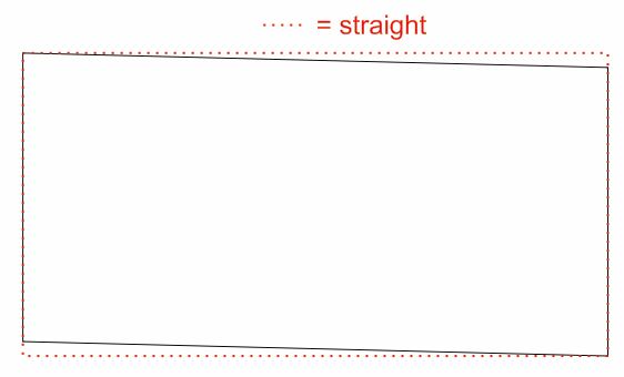

We've noticed that our HP 360 prints are out of square. Serious problem when making double-sided signs.

You just have to print and examine the output on where it goes wrong. Does it skew the material too much during printing or did you load it too skewed? Is something terribly out of spec?
