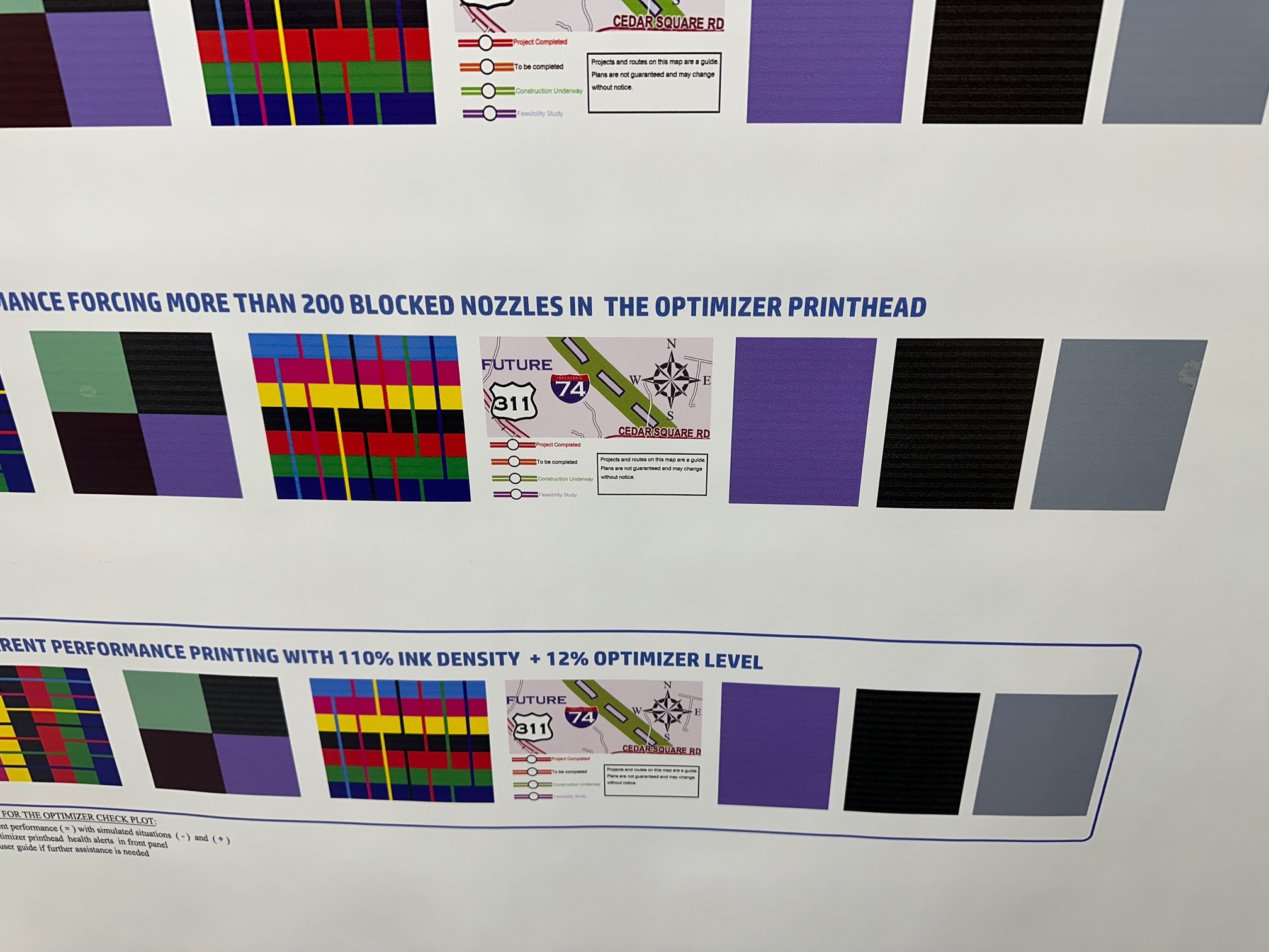

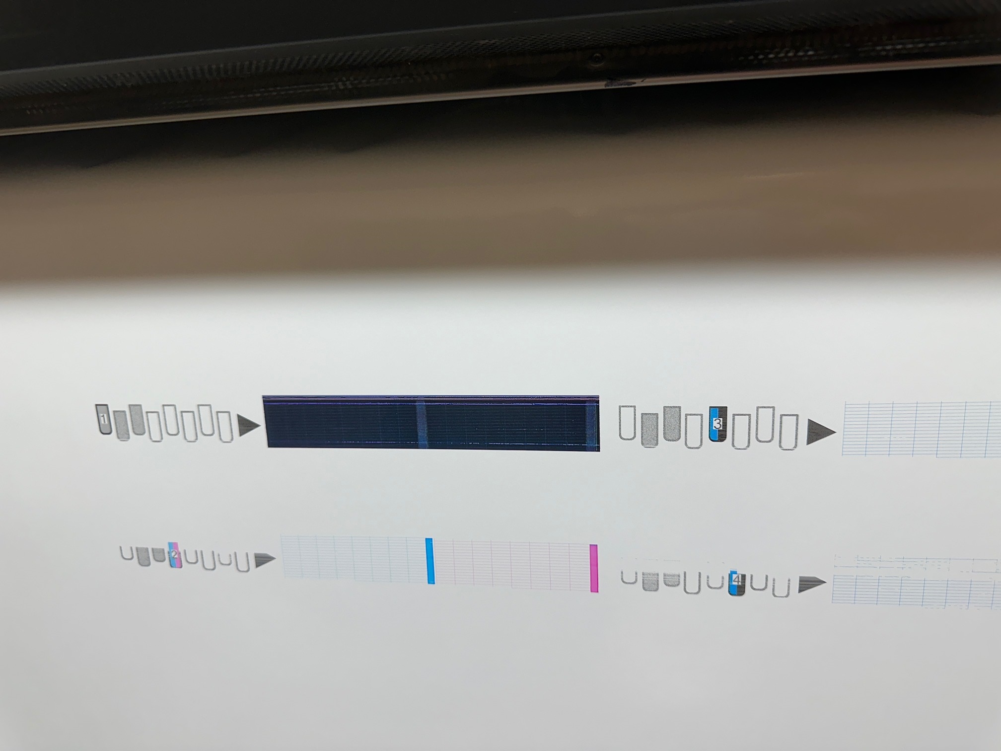

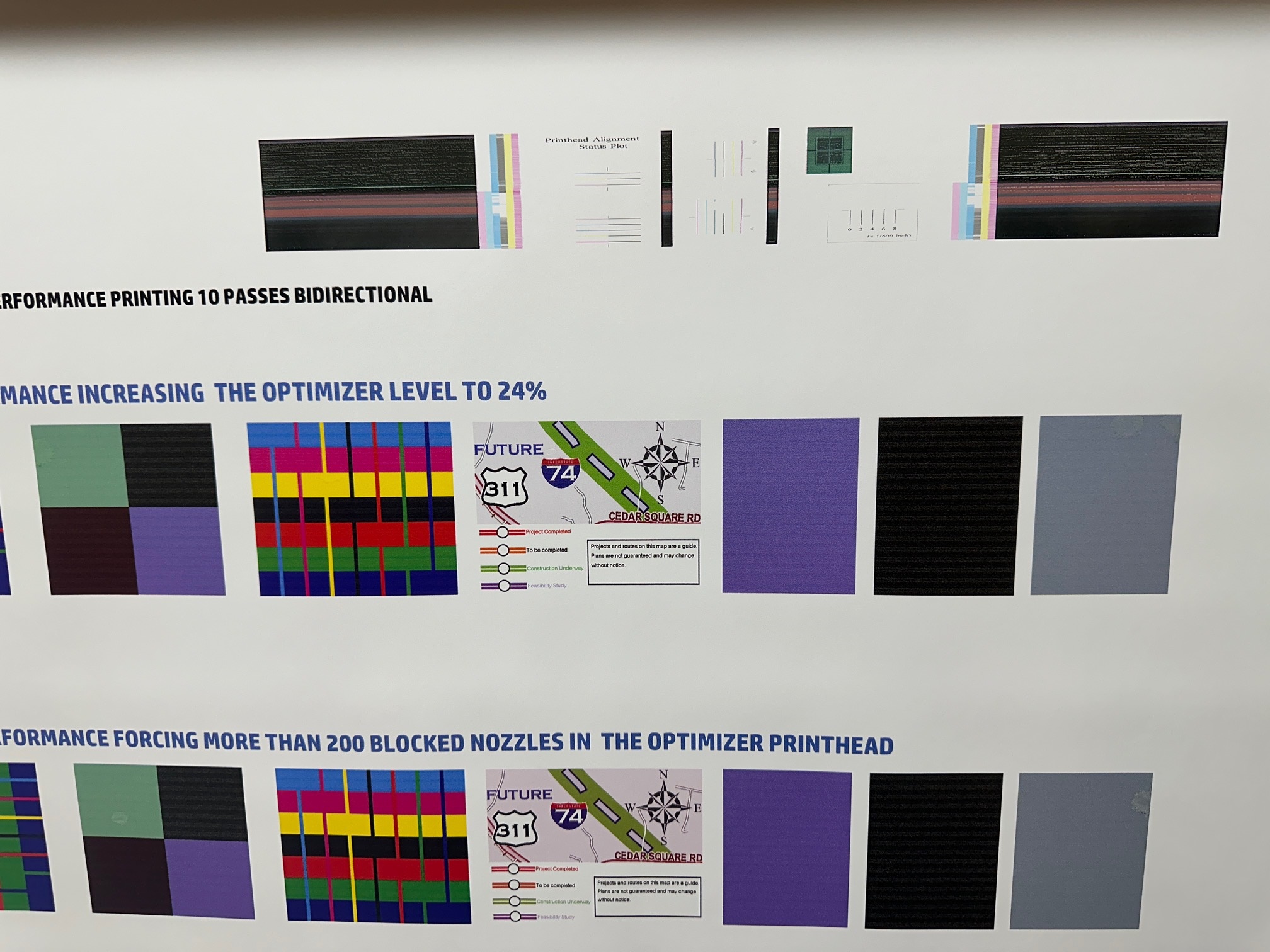

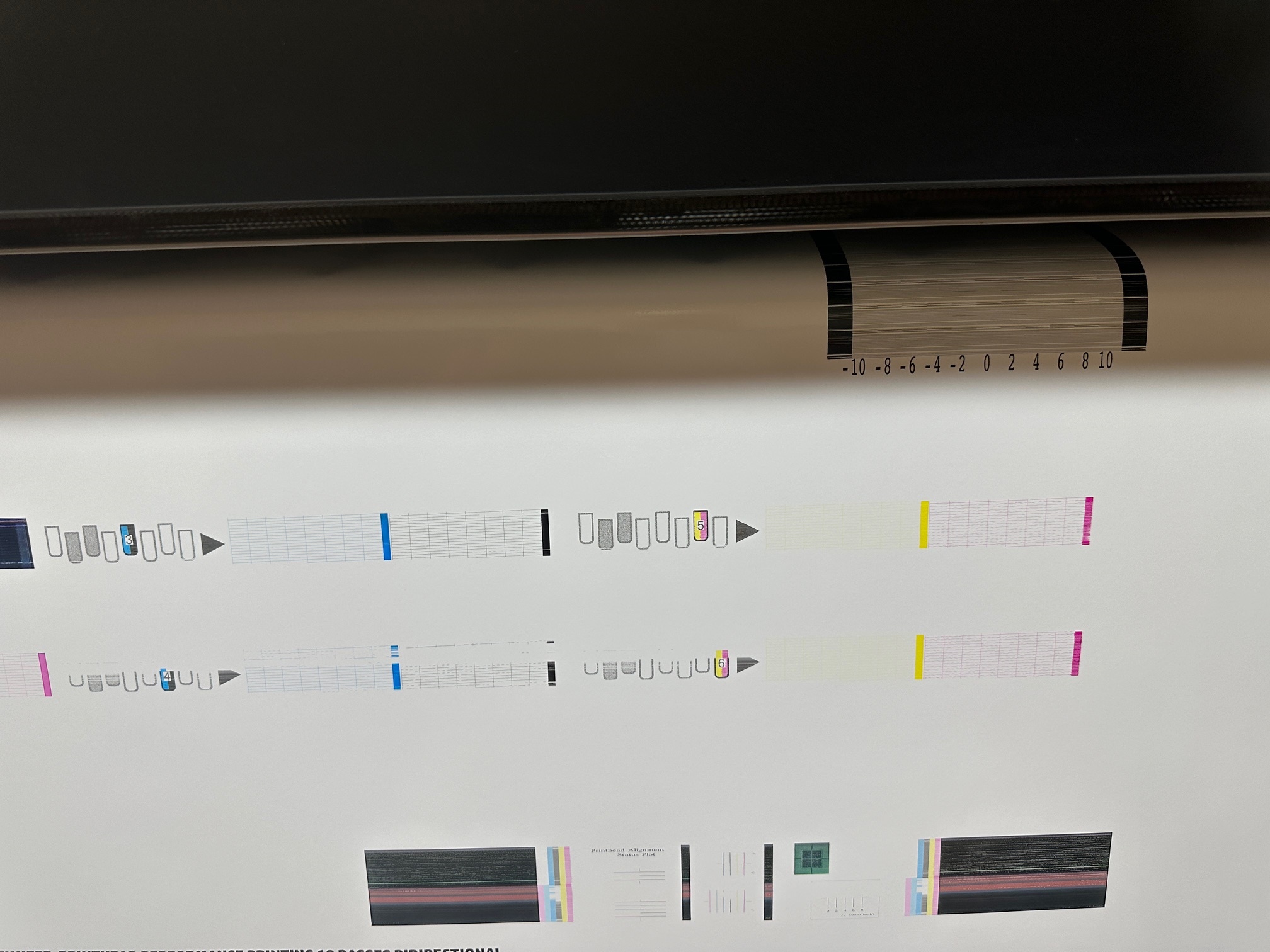

I had some bad banding after I printed 6 IJ35 48 x 48 pieces today. It started in the middle of the 7th sign, banding on ALL colors out of no where. Very mild banding on the 6th sign.

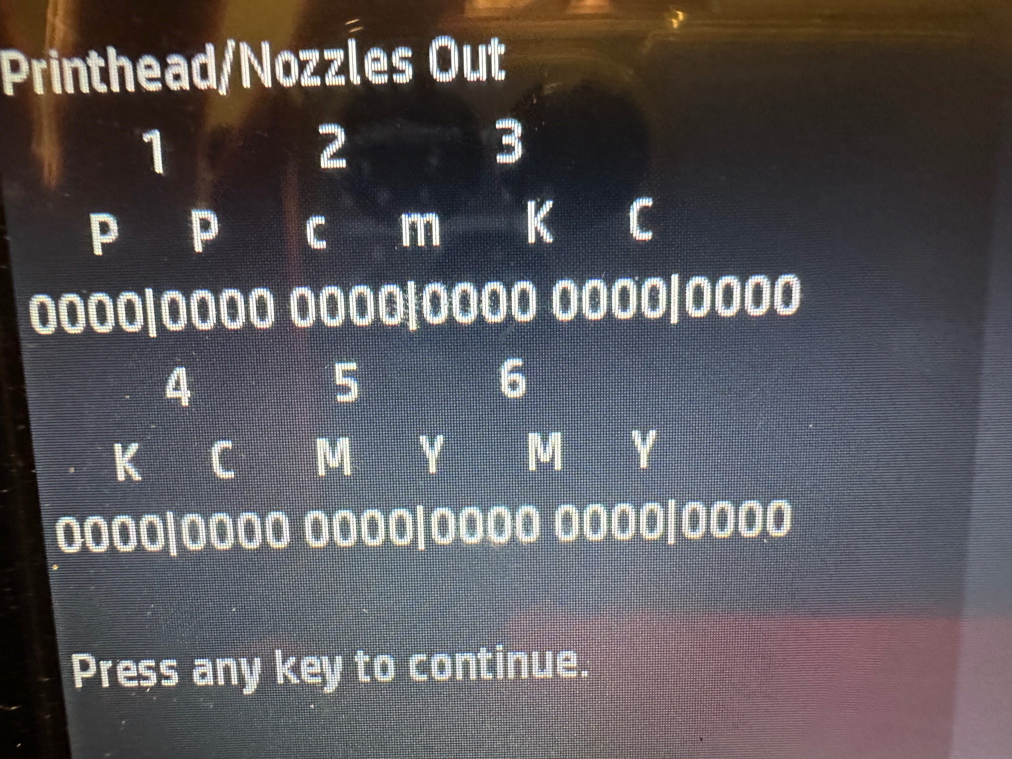

I replaced all the print heads, saw banding on the alignment stage. Still have bands on my test print in mainly the Blue and Black. I think did a Force drop detection and showed no clogs.
My SMk 3 is do for replacement. I am at 108% on it.
We did lose power her last Friday and had an AC die, we replaced it yesterday, I am in Houston and it was 88-92 in the room for 4-5 days.
Here are the prints of the forced drop and the service menu tests.
Any ideas?
I got a call into my service people but they cannot make it until next week.

Run the Test Print (under the Settings, Image Quality Maintenance Menu) and visually review the pattern. Horizontal banding is almost always directly tied to nozzle performance or media feed. It is also unusual that the force drop would show that every nozzle out of 12,672 nozzles across 6 printheads are jetting. It is typical that a few nozzles are out - makes me curious if the ODD is working.
