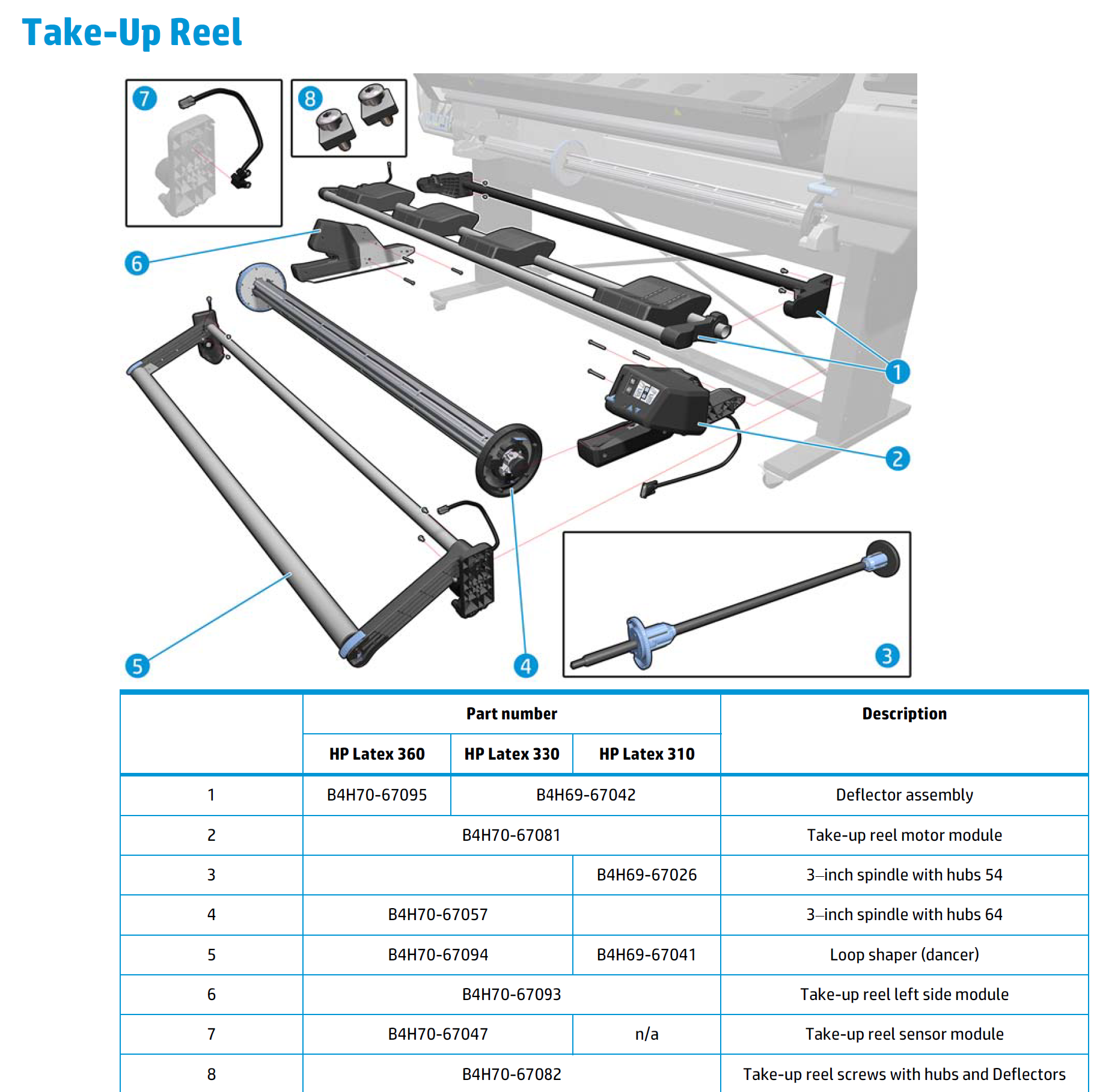

My 310 doesn't have the take-up reel assembly and wondering if I can install the one form the 360 on my 310. (Obviously with the right size spindle.)
Part numbers seem the same for most of it aside form the wider pieces.
It might be possible to modify the wider pieces to fit the 310.
Only exception seems to be the take-up reel sensor module which shows as n/a on the 310.
Wonder if there's a need for some sort of firmware update for the reel to work or if it will just sense it's presence when plugged in.

You can just transfer it and plug it in. Works straight away. All the parts are same excluding spindle and those two shafts.

Can you tell from that photo what i'm missing so I can be sure to ask about it? Spindles not shown but they're there.
I didn't think to but i could check the parts list in the manual to see what's missing.
