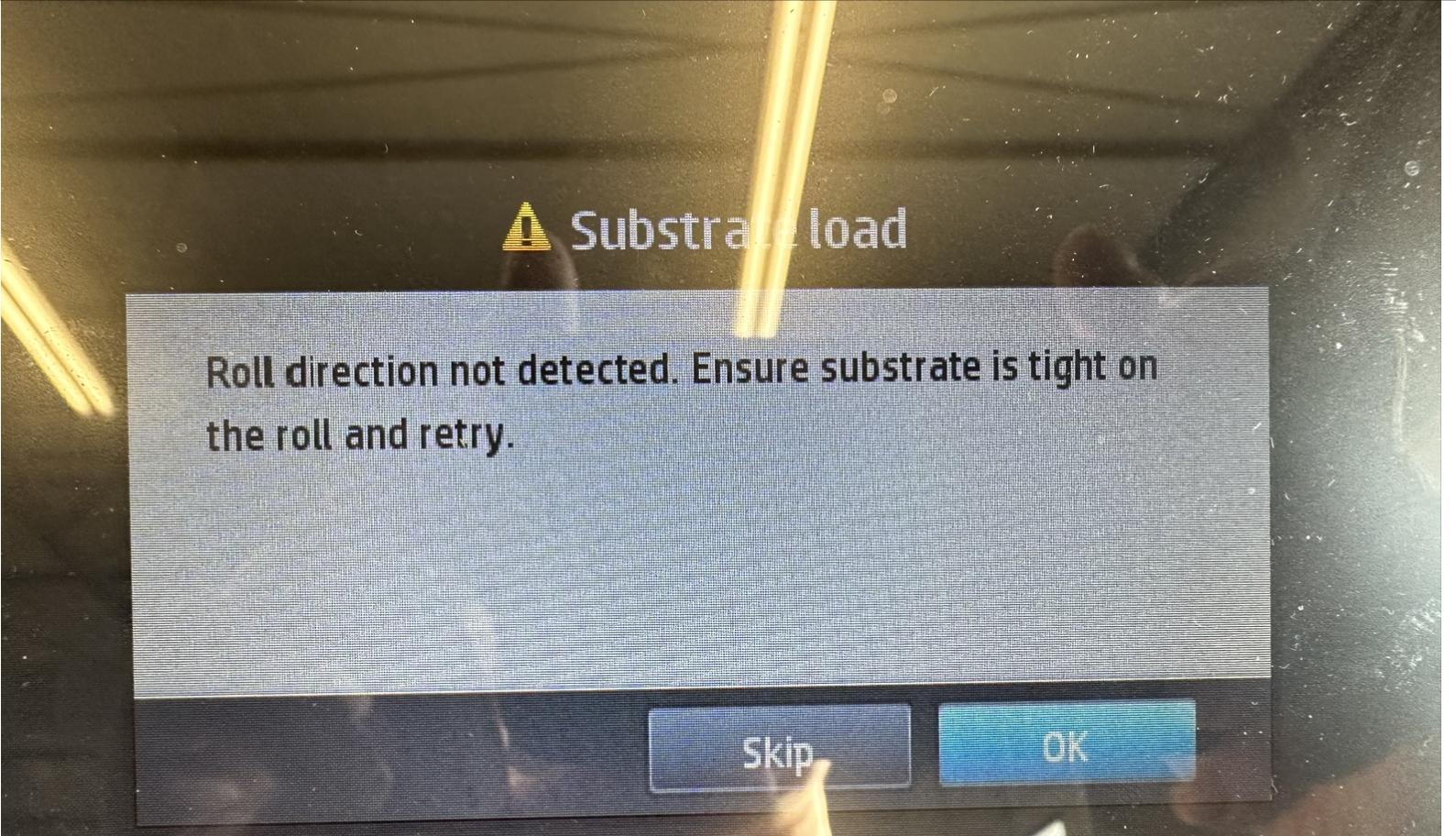

Hi! Having an issue when loading the 365, hopefully nothing broke... Just to make sure, I tried 2 different substrates, but it's showing "Roll direction not detected. Ensure substrate is tight on the roll and entry". I have had that message before, but easily fixed by manually winding or because it was at the end of the roll. This time it is not responding, and not rewinding.
I was able to print some, but the advance was not as precise as normal, so the 3' banners turned out at least 1/2" shorter than they should.
Of course, before I start taking the whole machine apart, I would like to see if any of you have had this issue and how was it solved, or what part did you change.
Thank you!

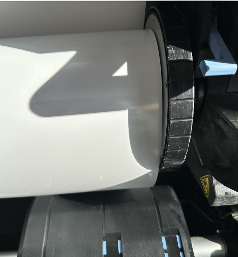

I have had this error with numerous media types. What I've been doing is putting my hand on the spindle wheel and give it a jiggle while the machine is reading/spinning. Usually works like a charm. I honestly just thought my spindle wheel was getting worn down.

Just to make sure it wasn't the spindle, I changed it to the take up reel. In any case, so far, the change of the rewinder motor part is working, must have been the motor, as the gears look pretty as ever.
