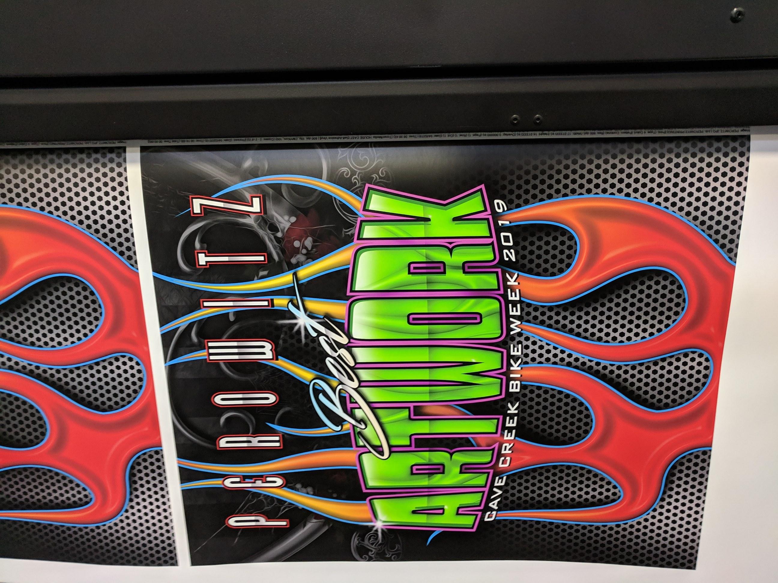

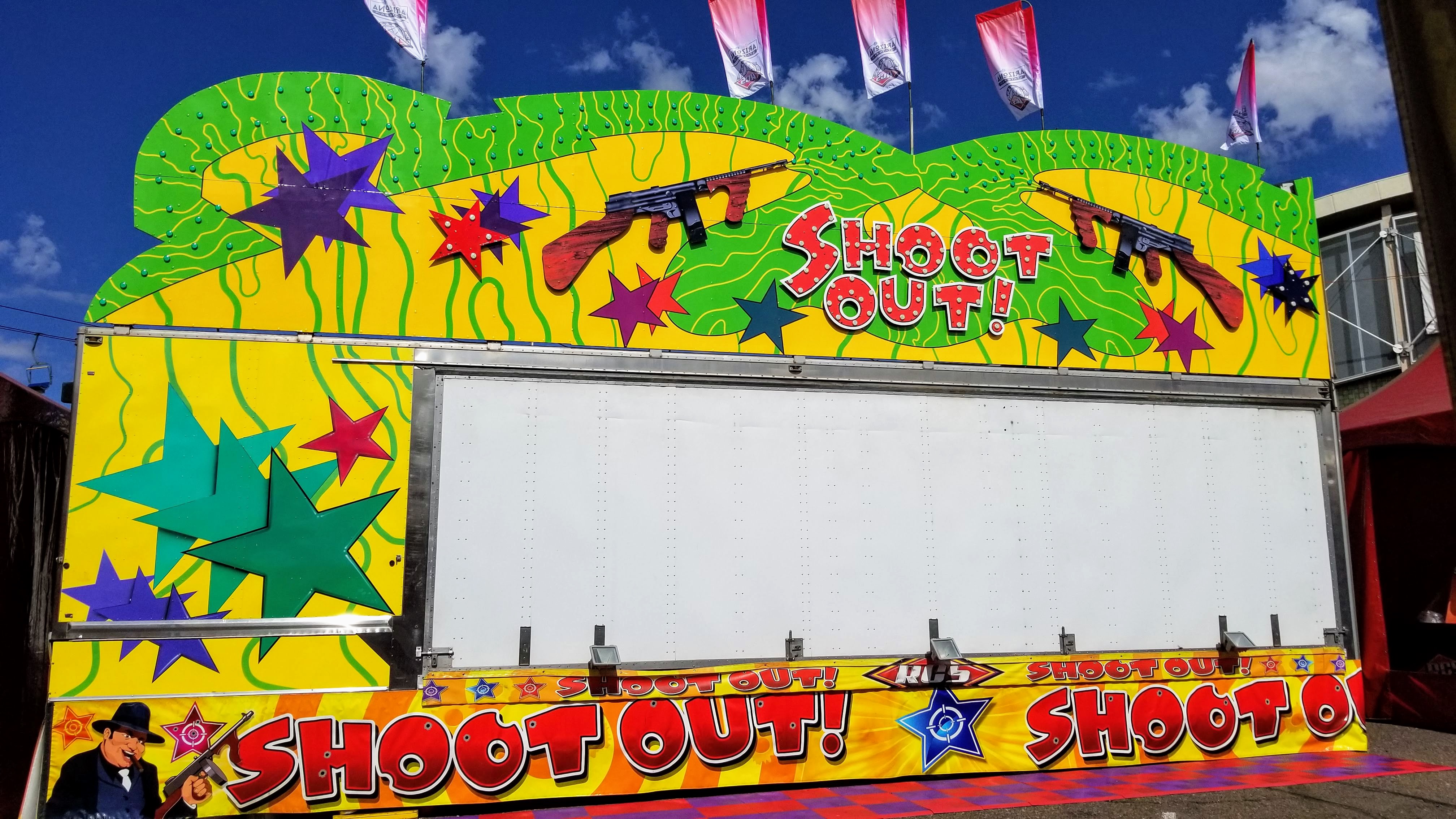

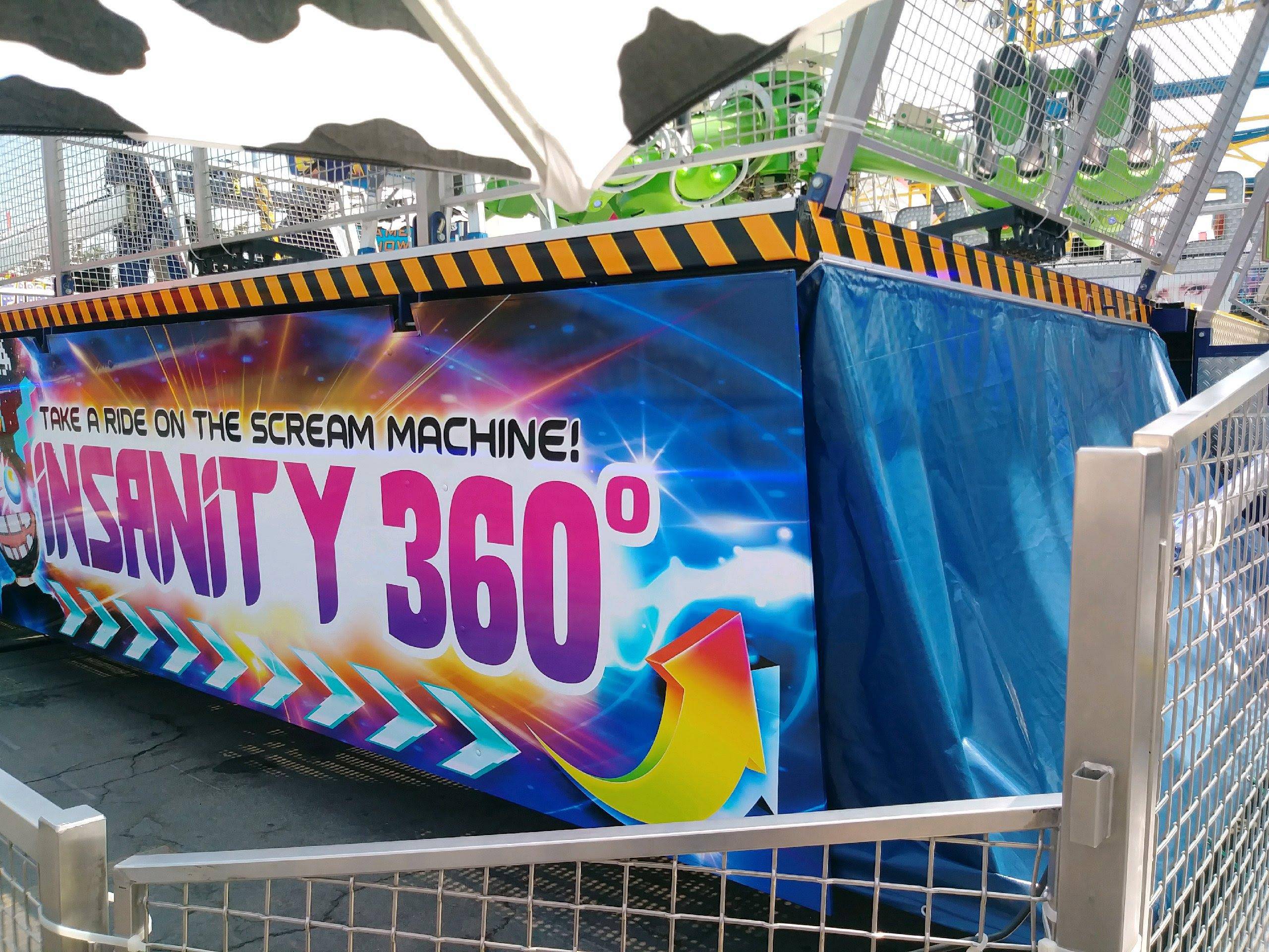

Yes and No, our 6 pass profiles have been highly successful for us and 8 or 10 pass is only really needed for super vibrant rich colors. Our default is our 6 pass and now with our better profiling process it's even better... We can hit almost all of the popular PMS colors except for a few brighter Magenta heavy colors due to the HP Latex limited gamut in that realm.
These are all 6 pass on the 570s
