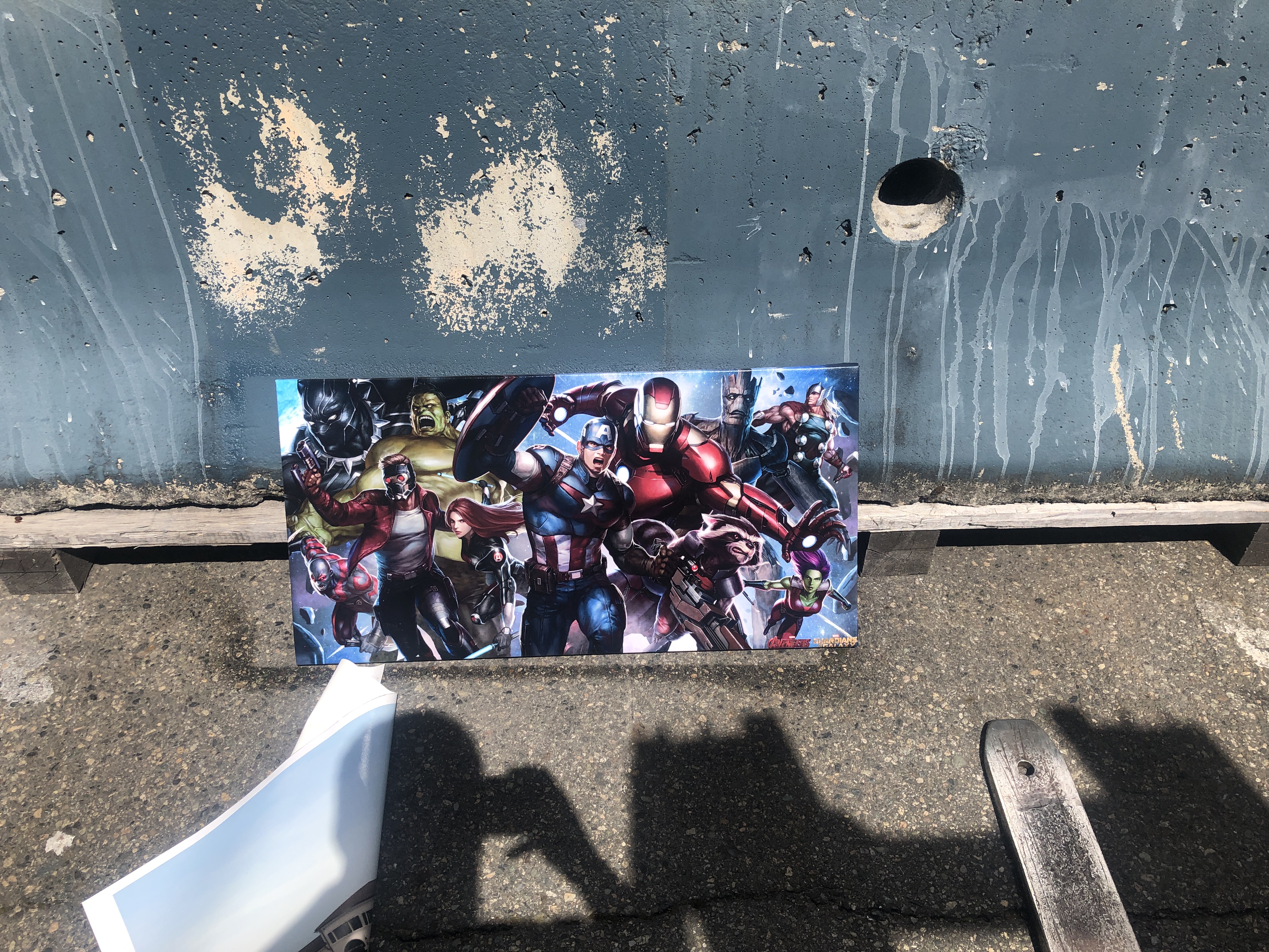

I used vivid colors on a canvas actually. Think I maxed the ink out... It turned out so glossy. I tried to replicate it on the 110 and couldn't. It's hard to see from this picture... But it looks like someone lacquered the canvas. I was pretty impressed. It was the first thing I printed on the 560... Did it for my kid just to see how it'd look. So while it's obviously not going to be used a lot... Vivid printing is kind of nice!
