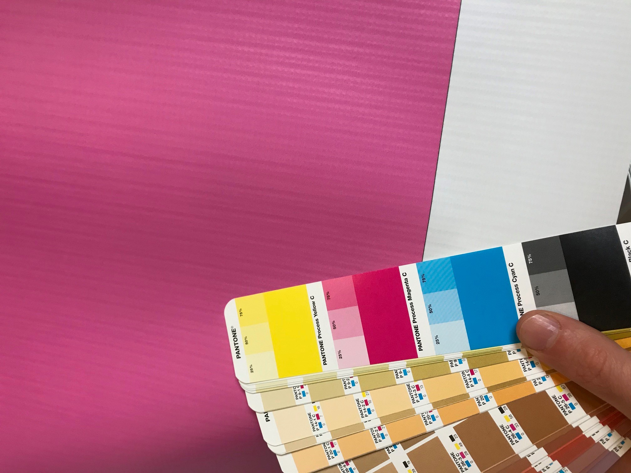

We just replaced a new large cartridge on our 370 with a full one. The printer seems to think it's empty. We've tried unplugging and replacing multiple times, but the screen keeps saying 0.0L and "Empty."
Anyone have any experience with this? at the same time our color seems to be significantly altered (lacking magenta of course).

The printer is now outputting a soft, pastel magenta. I've inserted a new cartidge, one that was accepted, but I'm still stuck with this, which is throwing all colors off...
