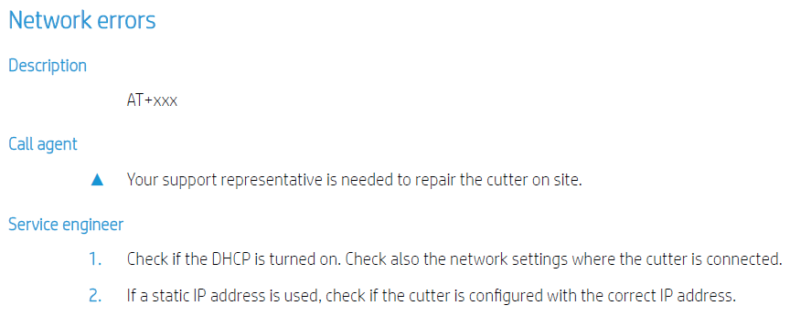

i press through all these (can’t find ANY information on what these mean, and i feel like i’ve done a thorough search but i would love for someone to show me the page i missed) and i load a roll of vinyl and attempt to send it a job.
no ethernet connection, no light when plugged in , nothing.
reinstall up to date firmware through “HP cutter control app” , no fix to the ethernet issue.

oh also this is my code when i go to configure ethernet connectivity, but that’s not even a concern of mine, i’ll USB my jobs old school if it’s what’s gotta happen to keep printing n cutting…
configure IP
enter+at
at+wann failed
