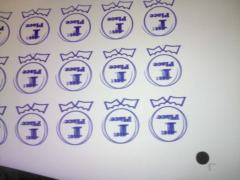

So the printer was giving some printhead path (2?) errors so I decided to clean around the belt and encoder strip. Now I am getting a double print where the bi-directional printhead paths are not lining up. Any ideas?

I had the same issue. Look inside the printer, if you see what looks like eraser shavings then you need a new drive belt.
A new drive belt solved my problem. I changed it myself, it is fairly easy. You can either purchase the drive belt by itself (around $50) or get the kit ($129.99).
I got the kit which included all the tools and the instruction to change.

I had no problems installing at all. I followed the instruction step by step, and when I was done with the install, turned the printer on, calibrated as per the instruction and everything worked perfectly.
It might seem scary when you first look at the instructions but it really isn't hard. One step at a time.

Thanks, I went ahead and ordered it. I was actually looking at that page before you replied haha.
I just think it's wierd that it went from working fine one print to being screwed up the next print. Wish it was an easier fix...
