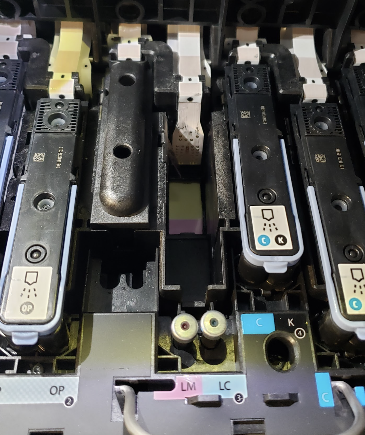

Hello, I am having a print quality issue. I did a force drop detection and I am not getting ink from Light Magenta and Light Cyan. I have replaced the printhead and still getting an error. Both printheads look good to me. Is there anything I can do before I need an HP service rep? My printer is out of warranty.
I have already tried
- Printhead cleaning
- Trying new ink cartridge
- New Printhead

Hi, how do I clean the printhead connection? Are you referring to the area that has the gold pins where the printhead sits into?
Yes. You have a tool for it in the cleaning kit, the black one that looks sort of like a tooth brush.
Put a cleaning pad on it (also in the kit) and clean the connector in carriage. Use it or IPA for example on the printhead.
Wipe both with clean cloth before inserting back.

I cleaned both the printhead and the printhead connection. I still am not able to get a clean print with light cyan.

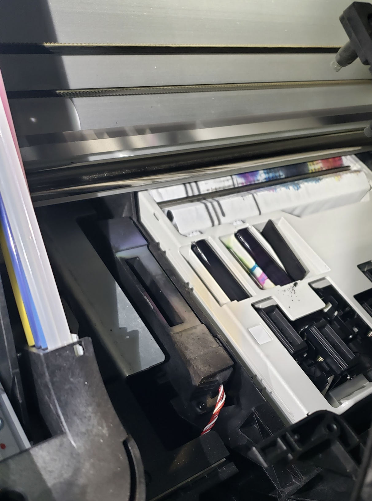

Is it possible for you to get your phone inside the printer and take a photo (flash will be required) of the drop detector ? I want to make sure the drop detector is clean from dried ink.
If you dont know where is it located, it's between the service station and the platen.

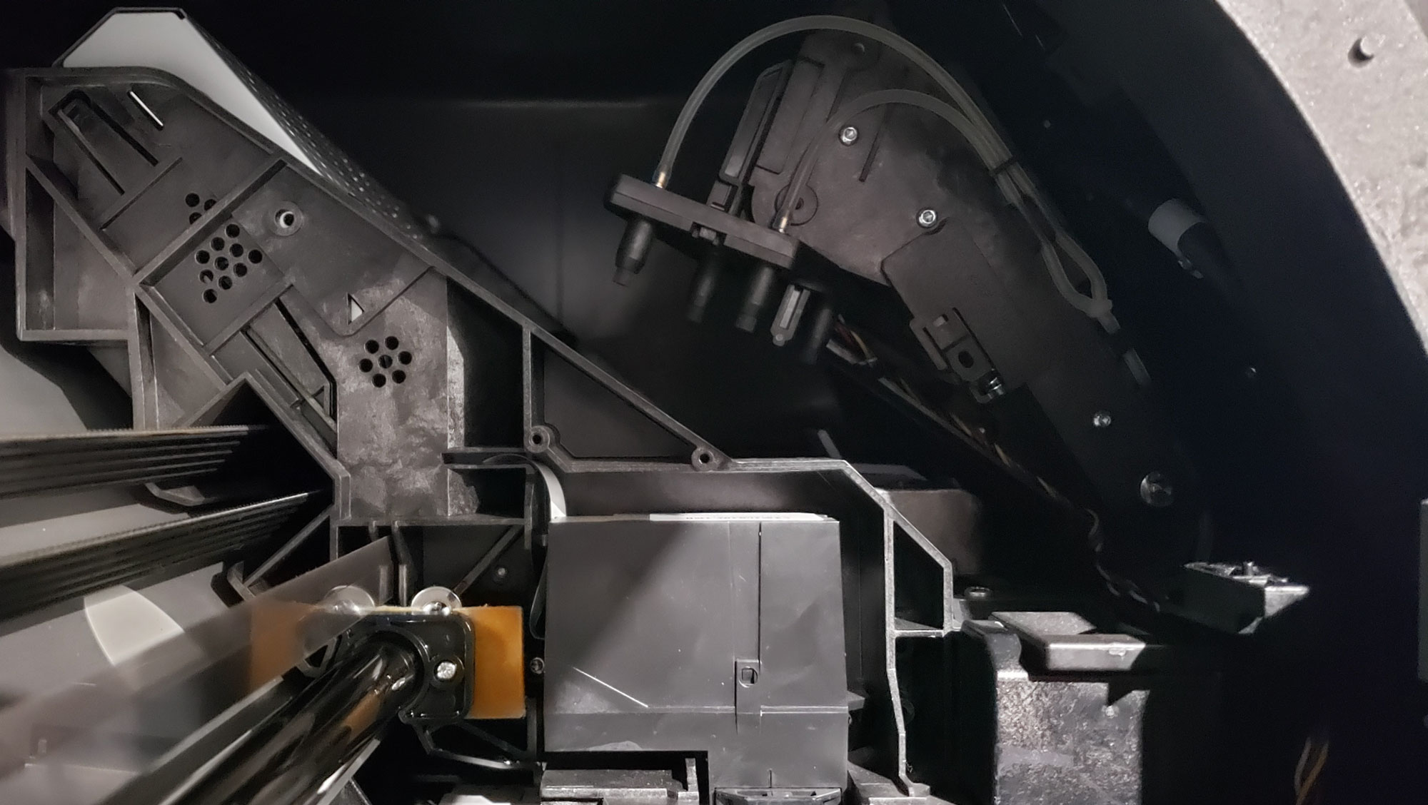

The drop detector looks pretty clean to me. I have also attached a photo of the hoses on the right side.
