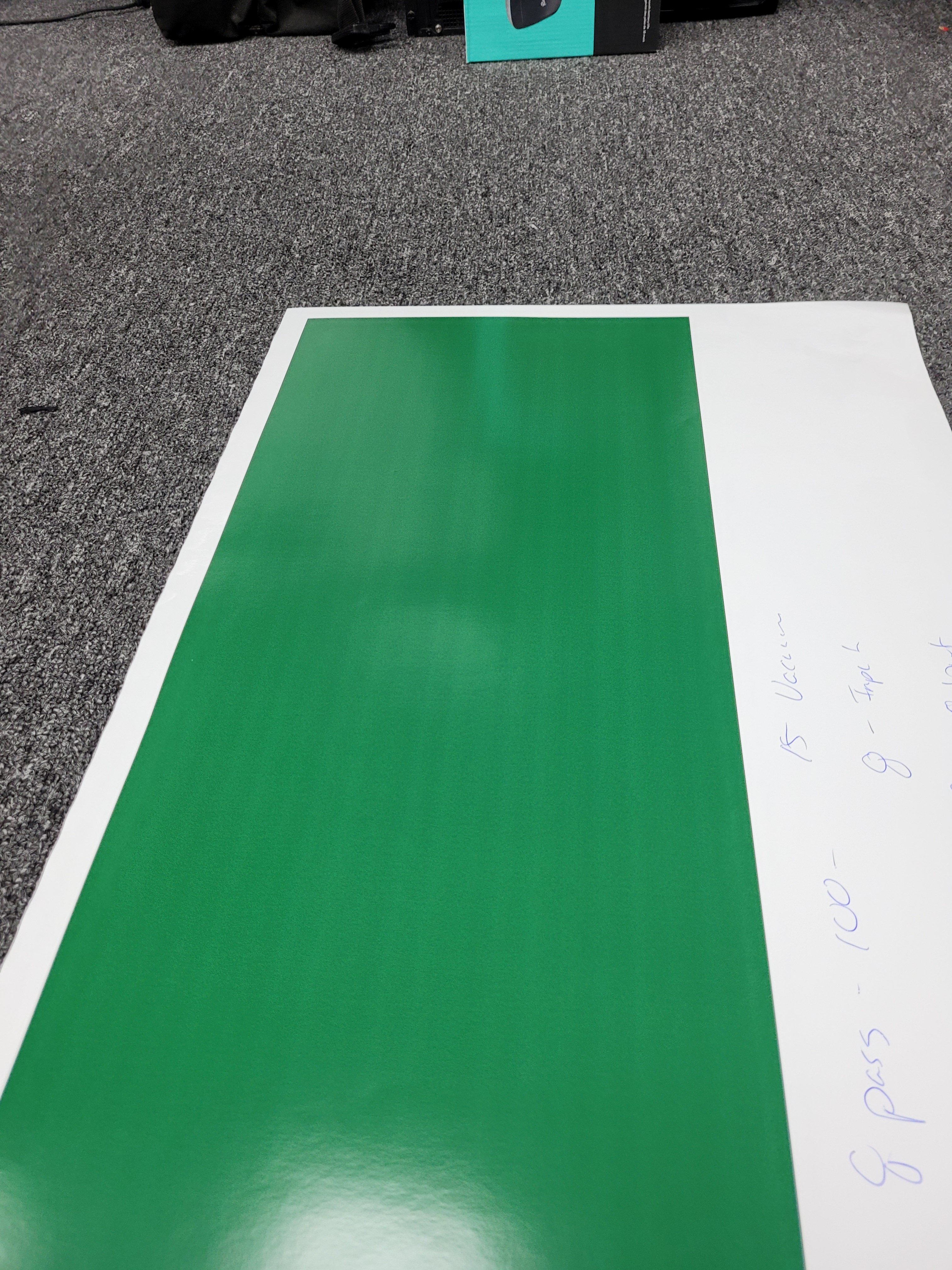

So I got my 630W and I can’t get my first print on point damnnnn
This is at 8 pass and 12 pass. Substrate advance calibration looks good. Lightest column is the 0 column…
Also after printing on 105cm and switching to 152cm, the 50cm extra will leave traces. I have to clean the wheels….

Interesting, I wonder if you got a bad optimizer printhead straight out of the box. It's a little hard to see from the picture.
Are you sure your alignment is done well? It should be done on glossy SAV.

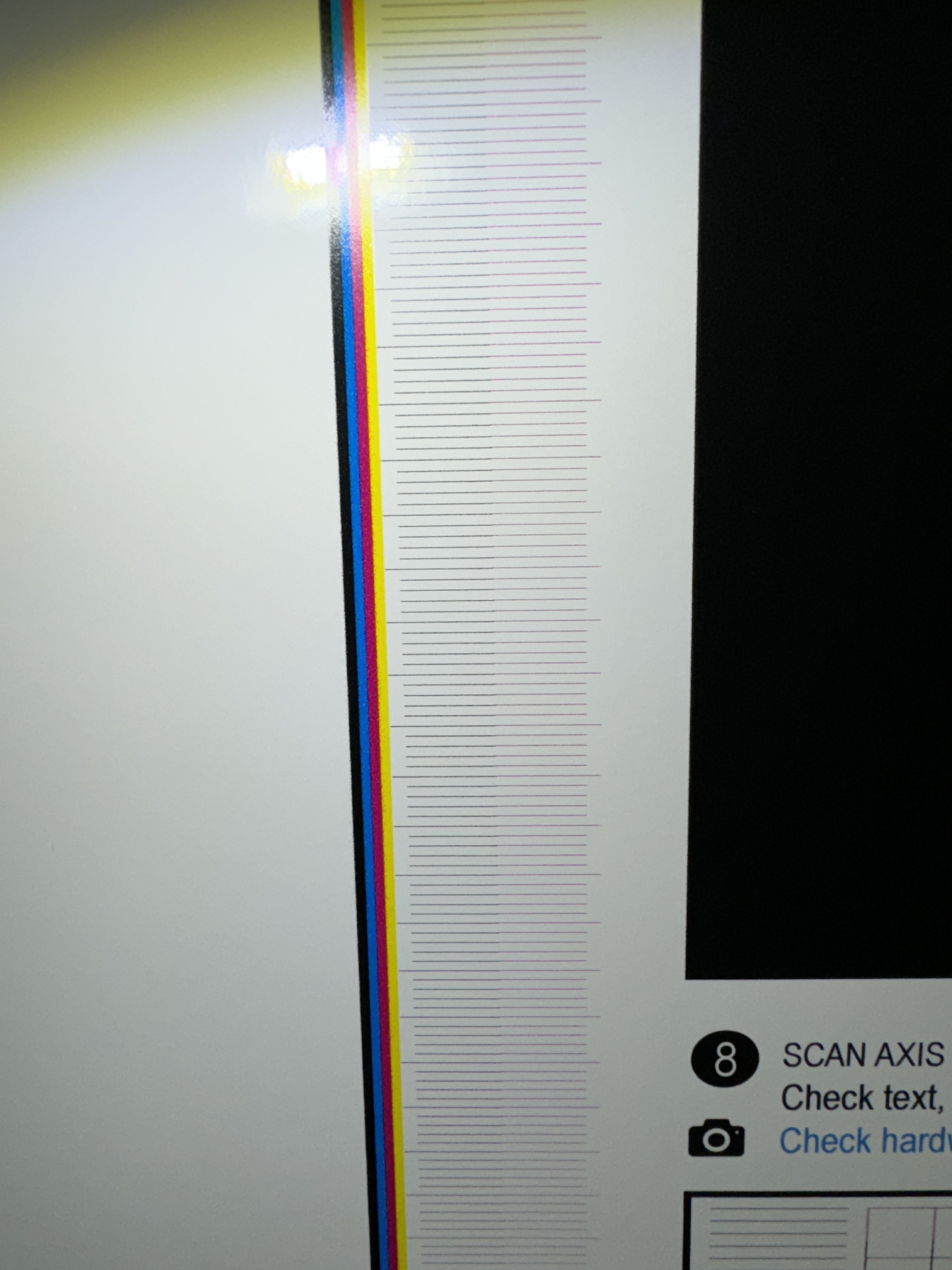

Also you should maybe print the Tools > Troubleshooting > HP Control Print and see if there's anything wrong on that.
One more thing you can try to add the spit bars from your RIP so see if it makes any difference.

U think it could be the optimizer?
Printhead alignment looks pretty good to me yea. And I did it on glossy vinyl.
I'll try a control print...
Disabling the substrate advance wheel made it better, but not good enough.
Edit: hp control print looks perfect to me

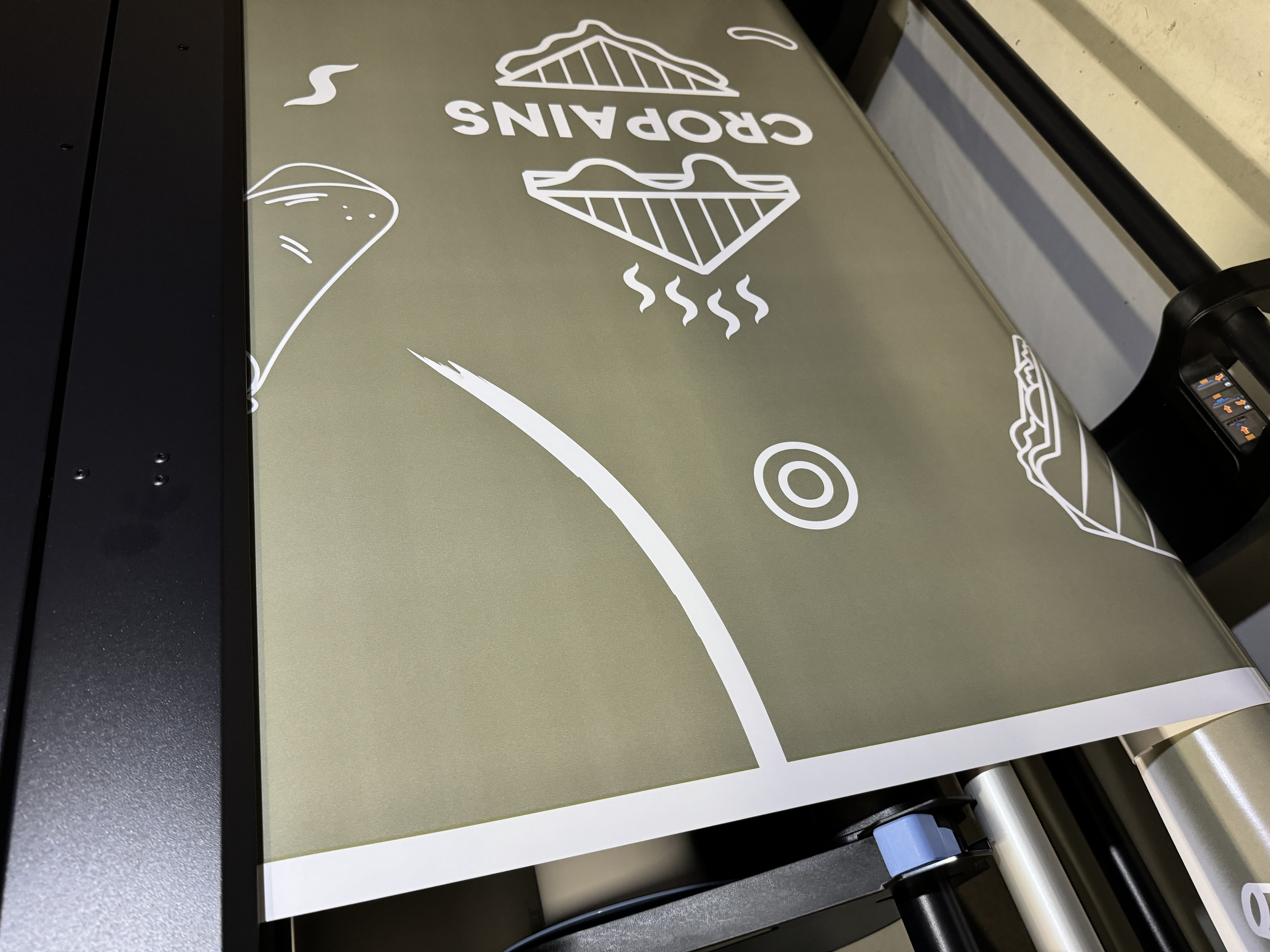

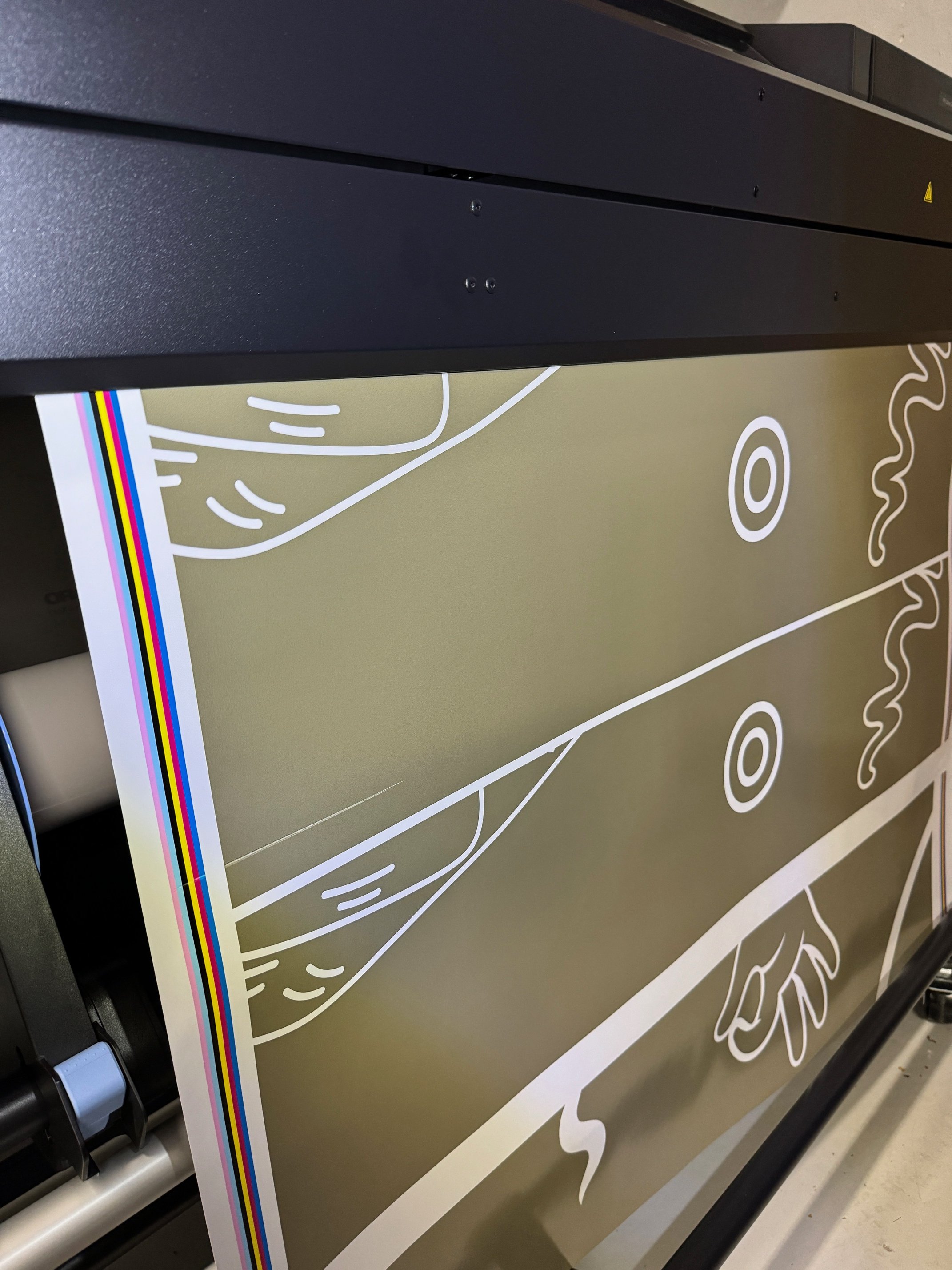

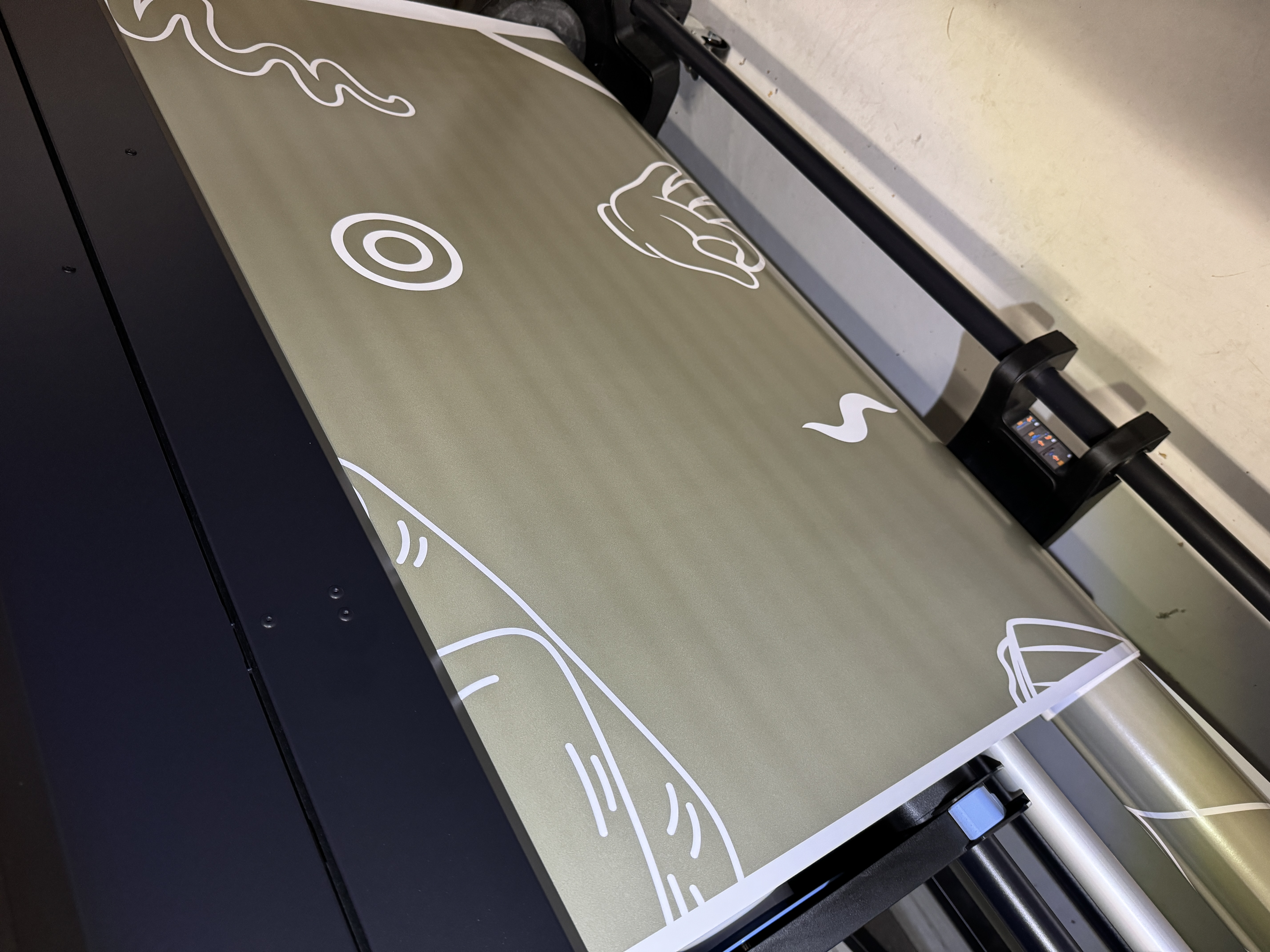

After spending hours and meters of vinyl I gave up today.
Will contact my supplier tomorrow and go from there.
Some more images

On first sight, it looks like a feed problem. But then, there are no signs for it on the control print.
I wonder, if it could be ink pressure related. The L630 (and new L700) don't use intermediate tanks anymore, so the pumps need to pulse all the time while printing to keep the ink pressure at the heads constant.
