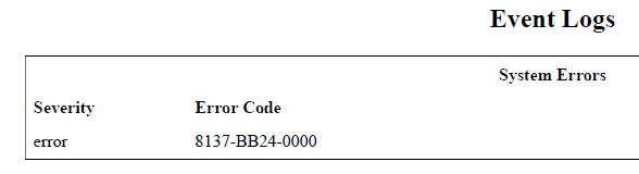

I had this error in the morning on my HP 700W: 8137-BB24-0000 and now printer is not detecting both white print heads. Removed them, cleaned, placed back. No results.

Replaced head number 10 and everything back to normal so far.
