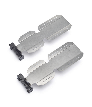

The edge guards will destroy your printheads if you print on thick materials like reflective or photoluminiscent vinyl.
There is no Printhead Carriage crash sensor. ( Really???? )

And he is right on some things. The edge holders is not something that should be used unless absolutely needed.
My point is the edge holder issue has been valid since their introduction and OP is coming from a 365. We leave ours on on our 360, and have had one major crash that I would imagine would turn most people off from using them. We've decided their usefulness exceeds the risk, but that's just us. If you tell me that the edge holder system has been redesigned and is more problematic now, then that's something I was not aware of.

Yes it's a little different now. Twice or more the size, twice as flimsy.
These ones you should put on the shelf and let the dust gather.

HAH! I would never run something through my old 360 without those edge holders. Now (800w)... I just want to take them off. They do nothing but ruin prints!
