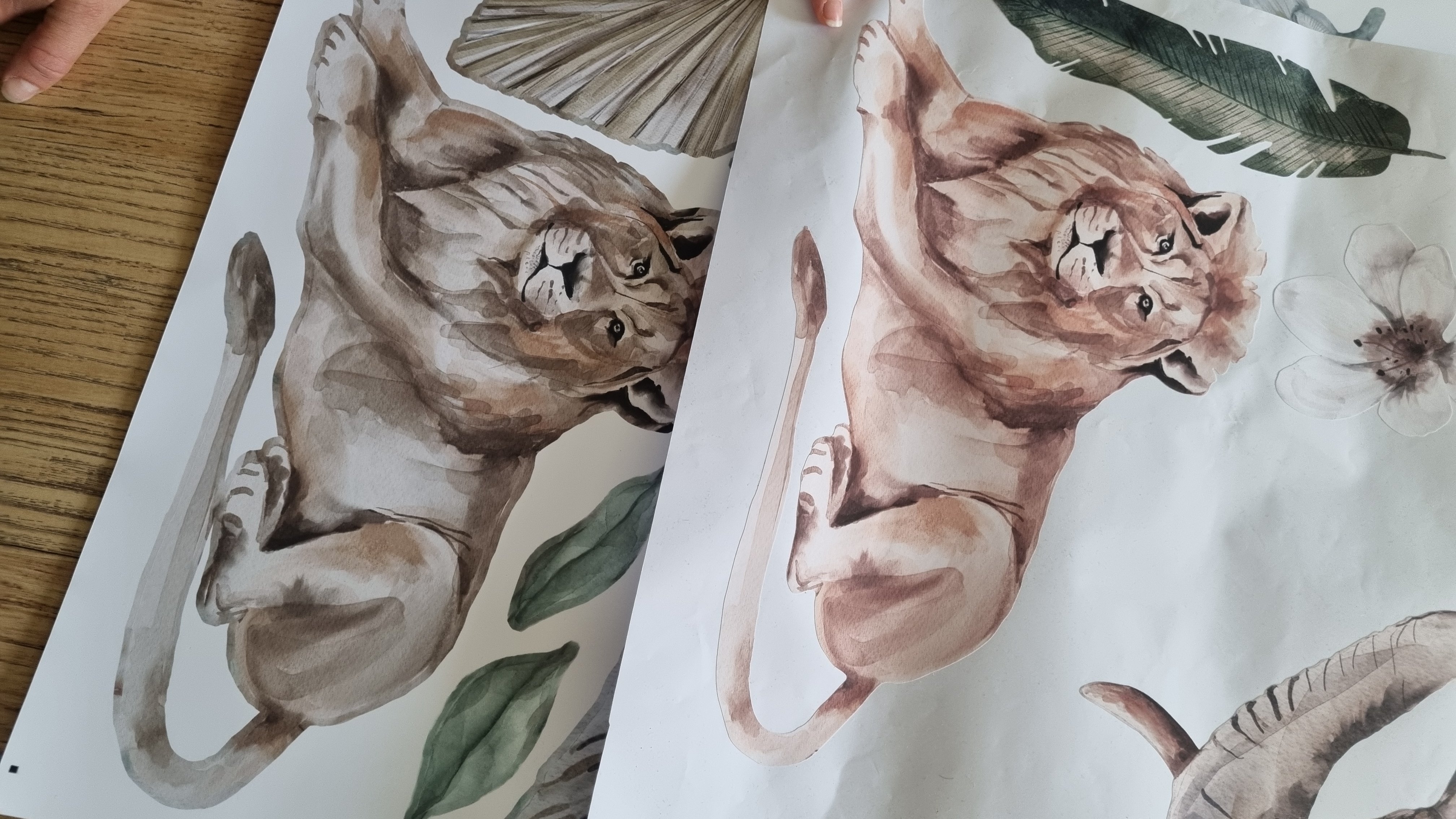

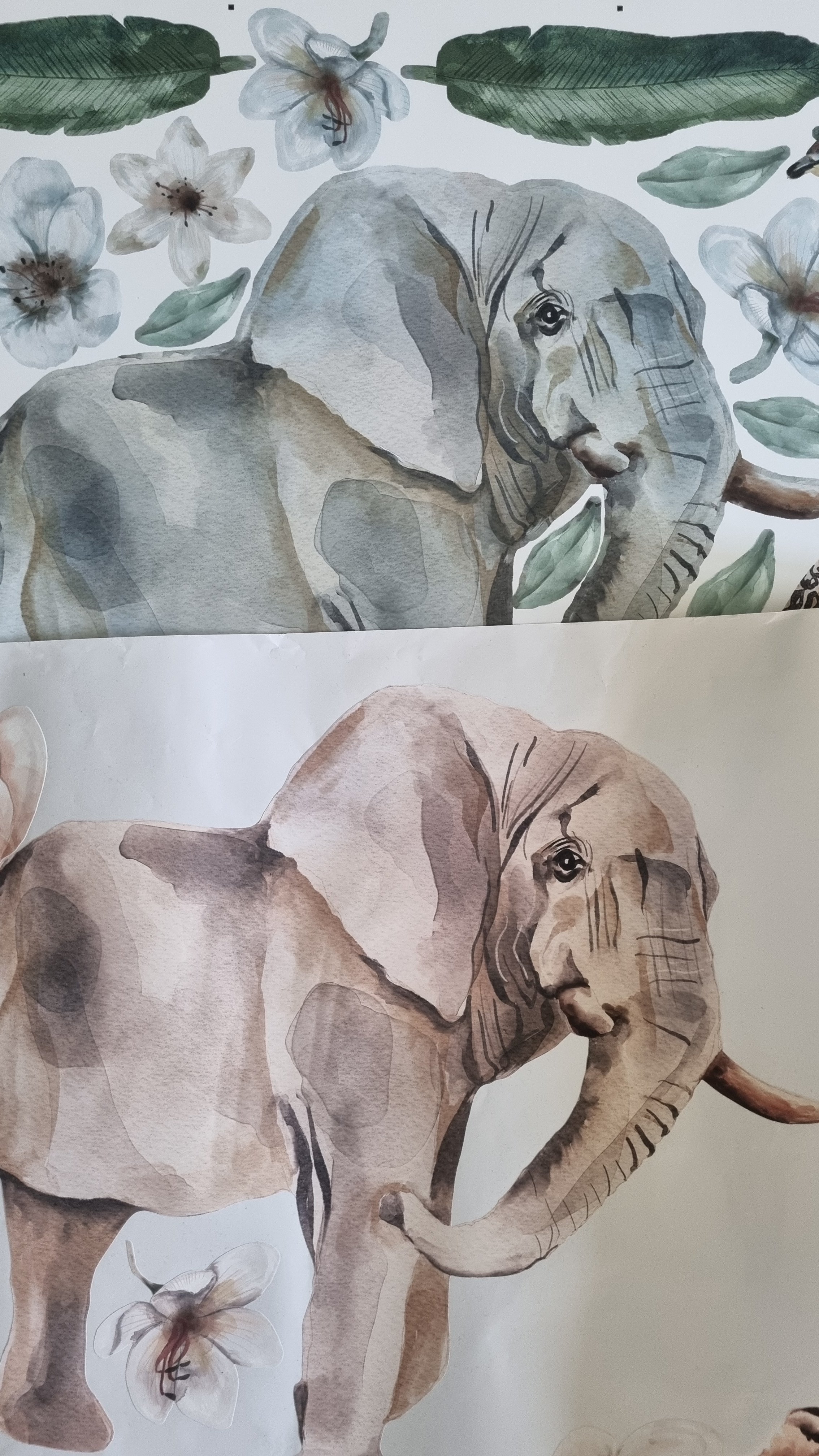

Hello there! Really hope someone can help. I have printed on the HP Adhesive Repositionable Fabric on two seperate latex printers with the icc profie downloaded from the Hp website and i've got two different results. I have a latex 310 and don't know why. All the colors look a little different, but the browns are really different. What should I do? Do you have any piece of advice? The difference is very visible when looking at the elephant ( other than scaling the art, the files are the same).

Have you done color calibration? What other printer do you have? Does it have spectro?
Export the "working" profile from that printer, import it to 310, do color calibration and see how it looks after that.
You may have some printhead that is not performing as it should.

It does not have a spectro. Thank you very much for the quick answer, i am really grateful. I will do a color calibration on the substrate. I am a newbie hoping to print some beautiful fabric decals and this forum has been of great help!
