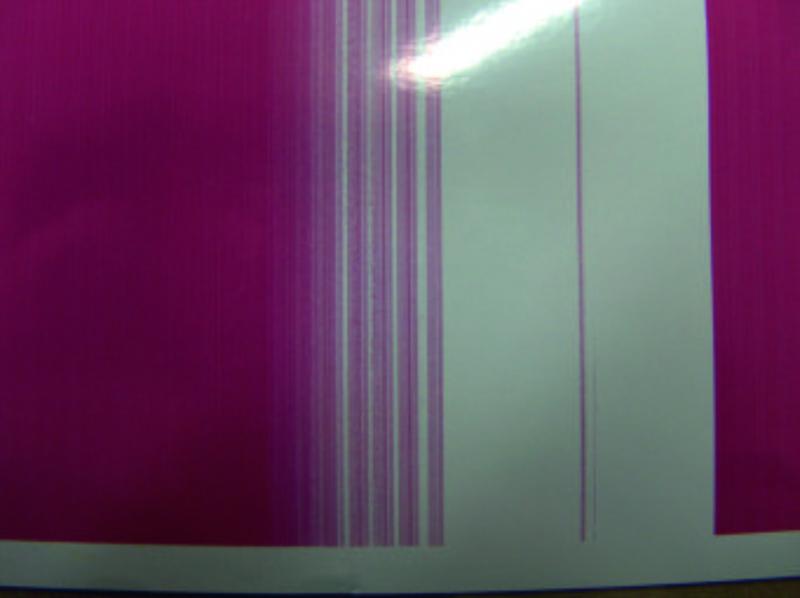

magenta printhead leaves a thin magenta line in colors with magenta mix
