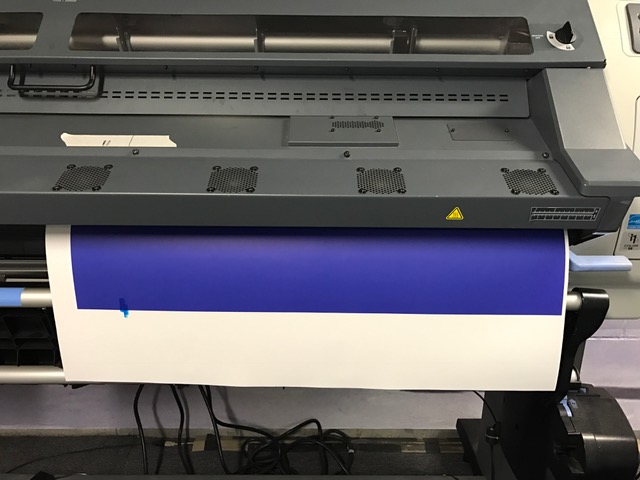

Over the span of the last 3 months our wonderful printer started to develop this disgusting habit of printing Cyan Blocks randomly in the upper quadrant of our prints. When I say Blocks I mean perfectly sized Cyan/Light Cyan Print head shaped rectangles. Not a head strike.
At first it would only appear on our large substrate +36 Inches. It would appear at random in the start, middle and or end of a run. The size of the job did not matter. On small jobs under a few feet in length it might hit or it might not. It normally will hit the substrate anywhere on the left 20"on the substrate. Anything under this is perfect.
It will happen on test prints sent from the printer display, on the image being ripped from Flexi (our jobs) and printed or in the white dead space away from the prints.
It is never any other color. Both cyan/light cyan print-heads have been replaced and this did not correct the issue.
We have spent thousands to have Maint. 3 performed by an HP rep. with-in the last month and this did not correct the issue.

Update: After attempting to work out the problem I found the name of the part missing the little rubber gasket is called a Primer Assembly. It was more likely than not bumped while the carriage rail was being lubricated causing the 2 cent rubber stopper to pop off and disappear into oblivion or the long since replaced cleaning kit. I pulled the print heads and cleaned the contacts on the station. Nothing seems to be working.
Is this being caused by a bad electric connection shorting out the Cyan Heads in the trailing cables? It's so random It's hard to put into words. After cleaning the cyan/lc many times and sending a block of dark blue I found that the fouling increased to about the size of a business card with Wet Stains of Cyan.

I dont see how the ISS or primer has anything to do with this issue
We usually see what you have but jetted across the entire scan axis. A carriage board usually solves this.
I would put a loaner board in and let the user evaluate what happens next
