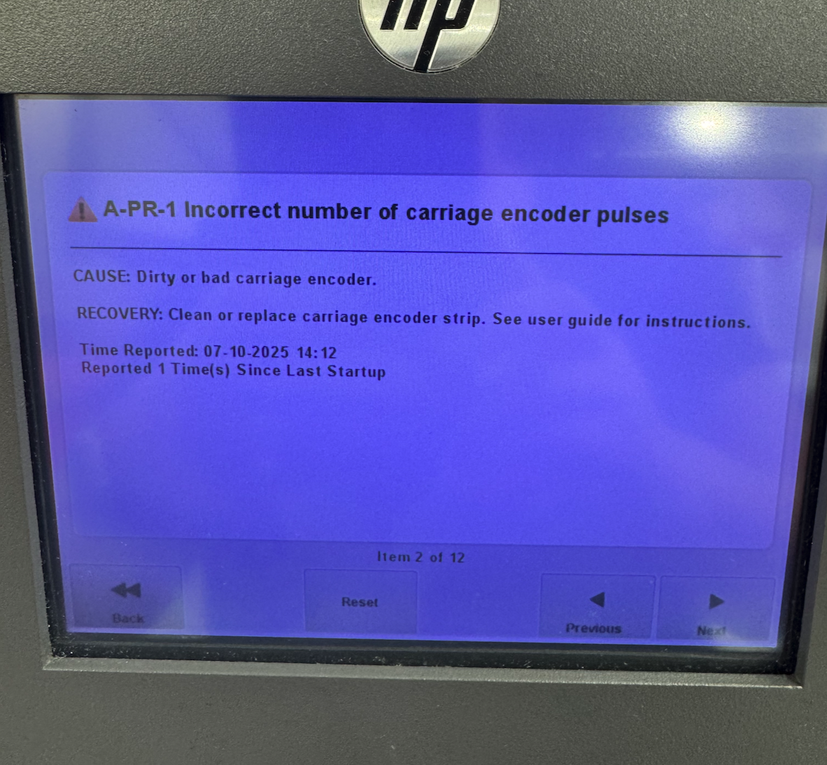

Hello. I am getting a-pr-1 incorrect number of carriage encoder pulses error even after replacing encoder strip.
1 I replaced the encoder strip and cleaned the reader.

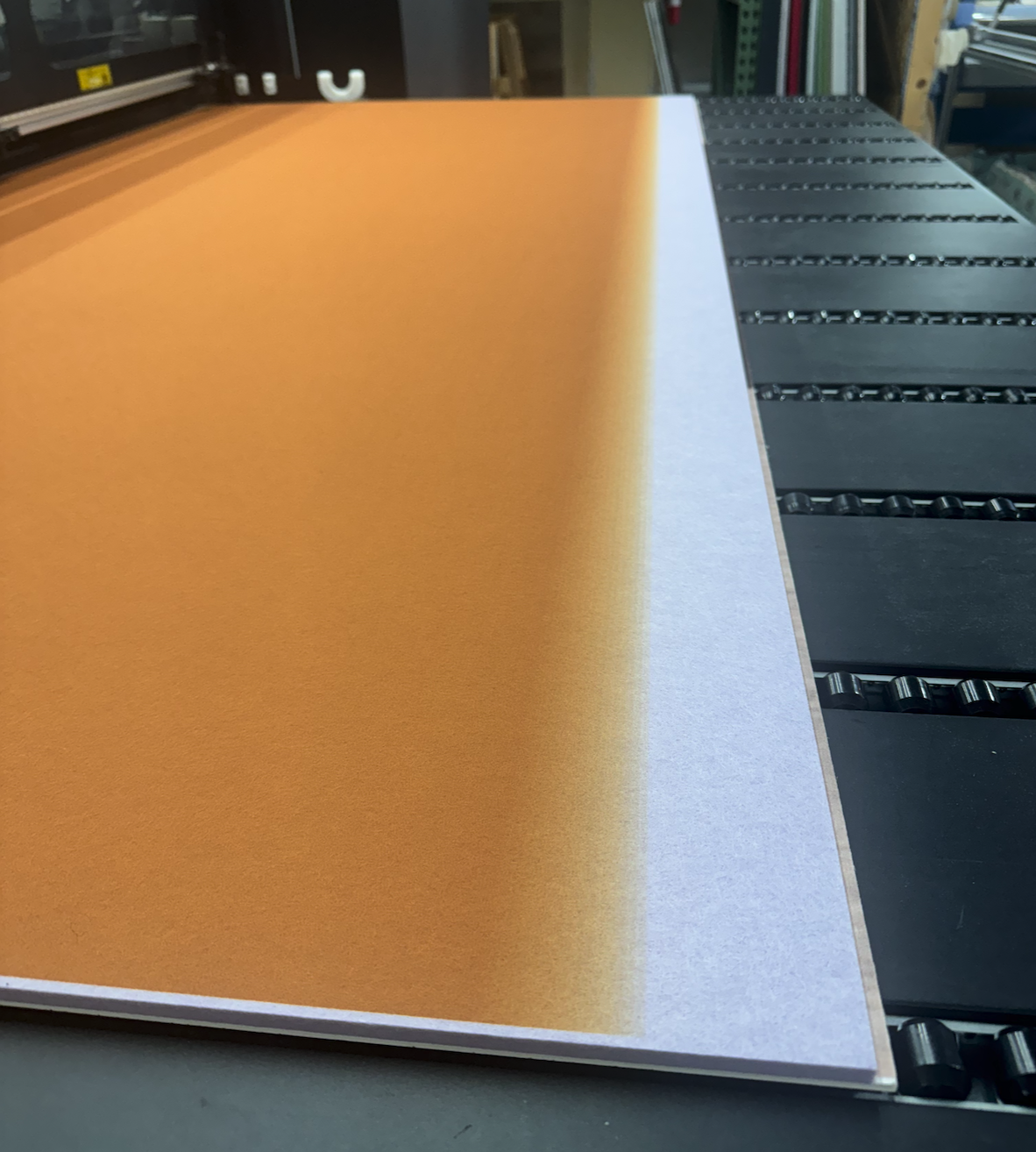

2. The problem only occurs when I am putting down a lot of ink (see pic below). So I would think then that it is related to ink and not something else (pulleys, belts etc), but I don't know what else to do.
3. It seems to stop when trying to print more ink and on larger 4x8 sheets. If I print lighter prints I can print a lot more before the error, but I can't even print one with more ink coverage. I am printing on porous felt so probably more ink going down than on paper, but shouldn't the printer be able to at least print one full sheet? I used to be able to print quite a few before I needed to clean the encoder and this is a new encoder strip.
4. I added more fan suction to pull the mist and odor out from under the cover, but that didn't seem to help this problem.
5. Today I tried reseating the LVDC dad cable connection. I found a memo online you have to unplug this cable sometimes to reset it. That didn't help either.
Does anyone have any recommendations of other things to try or check? Thanks in advance.
