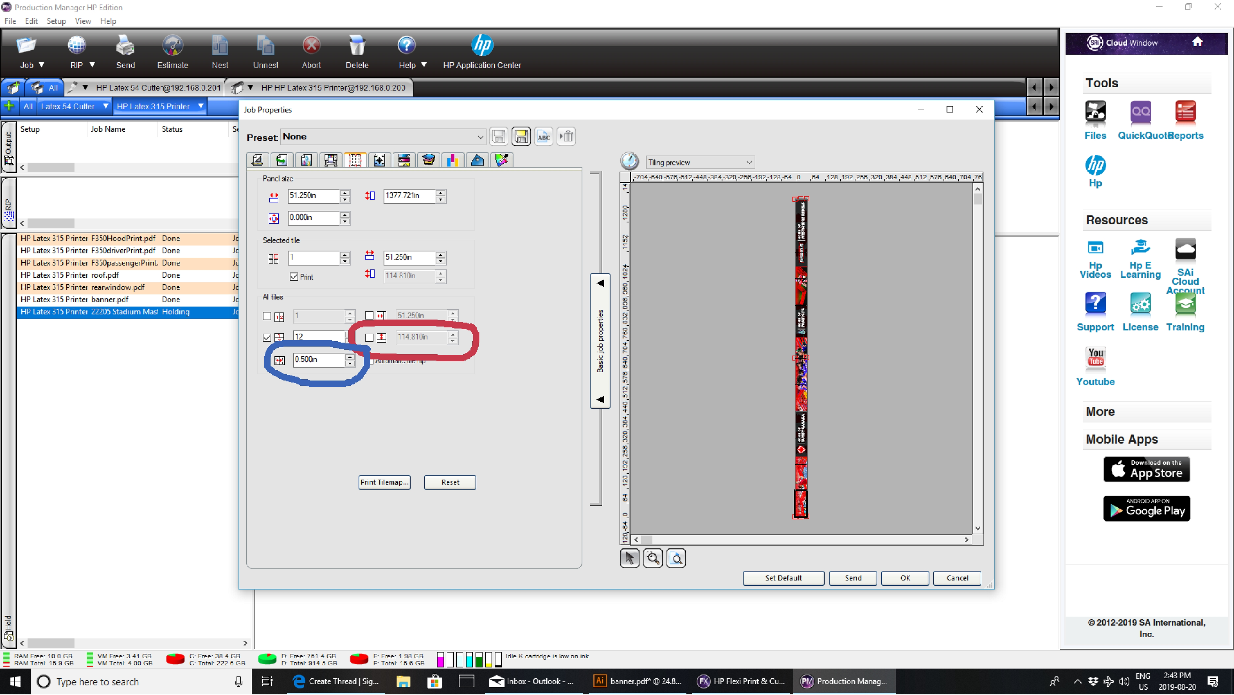

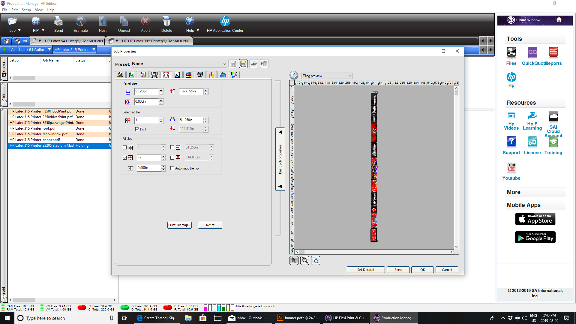

So normally when im tiling its verticalpanels and setting the overlap is simple. However this time im wrapping a big wall that is going to be 4ft x 115 feet so I want to print it horizontally, since im not about to do it in long 115 piece I want to break it up in to 10-12 foot sections, but the production manager is not giving me the option to set overlap this way.
What am I missing?

bannertime
Uncheck the box with "12". Check the box in red, set it to 120. Set blue box to how ever much overlap you want.
That will give you 51x120 panels to install with an overlap, which is currently 0.5in.

Jb1983
Ok, thank you, I guess because the arrows were pointed left and right I didn't think it was doing my overlap as im printing up/down.
