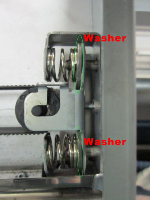

Alright,
We seemed to have fixed the the belt issue by creating more tension on the belt by adding washers behind the springs.

signswi
We had the axle on the tension wheel shatter like Sign Eagle's on Monday, be careful about putting too much tension on it. The HP tech said his replacement is beefier than the one that ships with the machine, but who knows. Took until today to get a tech here and it fixed because Monday was a holiday and HP service wasn't open, kind of annoying. The fix was quick though, we were up within an hour and the tech looked at a few other things for us. One service call in five months, not terrible so far.
