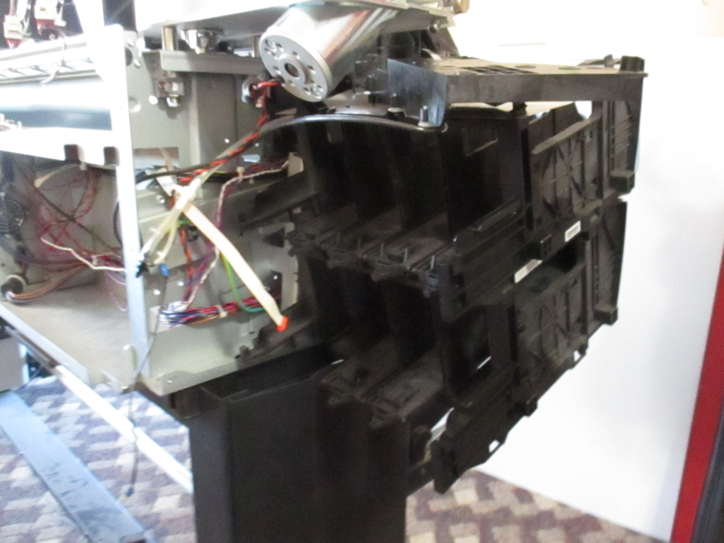

upload_2021-1-18_13-42-59.jpeg upload_2021-1-18_13-46-47.jpeg upload_2021-1-18_13-47-48.jpeg
The guys taking apart the L260 for disposal! It was awesome seeing how it was put together. One issue we had was the L260 was giving a "LM Cartridge Missing" message which would not allow printing. When taking it apart we removed the left side of the housing that exposed the back end of the ink cartiridges. It was a broken plastic piece that was about 1" long that kept the back end of the ink housing tight when inserting the ink. I guess it just snapped from the "rocking motion" that these did in operation.
We could have used duct tape or laser cut a new plastic part had we known.

Save the other clips because you can have the same part broken in the 365... Nah don't bother, very easy fix with zip tie.
