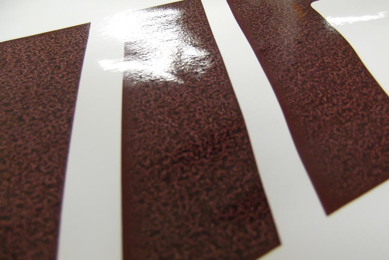

Hi all,

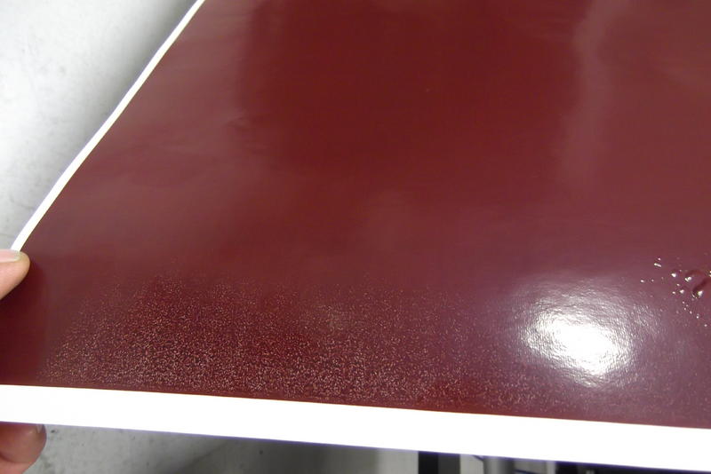

Our HP L26500, six months old, decided it needed a new heating unit last week, and showed the typical behavior by printing two or three feet of a print, then shutting down. We had the heating unit replaced yesterday, and afterwards, printed a dark burgundy car-sized wrap on Avery Easy-Apply RS perfectly. This morning, however, it will not do the same. See the pictures for the first print of the day...terrible. so I upped the drying and curing temp, and managed to get a good burgundy as in the second pic, but the speckled nastiness is still present but only at the edges of the media. Any ideas? I expect it's another expensive repair, but I thought I would run it by you guys n girls in the forums first. Thank you in advance. Frustrated Gary The HP Owner.

I've not tried a different material because the Avery is what we predominantly use on this machine. It worked absolutely perfectly before our heating unit went boom-boom. It's now printing speckled at the edges for the first 12 inches, then it prints perfect across the whole 54 inch width. I've adjusted the warm up offset and the cure offset in our Onyx 11. still the same.
