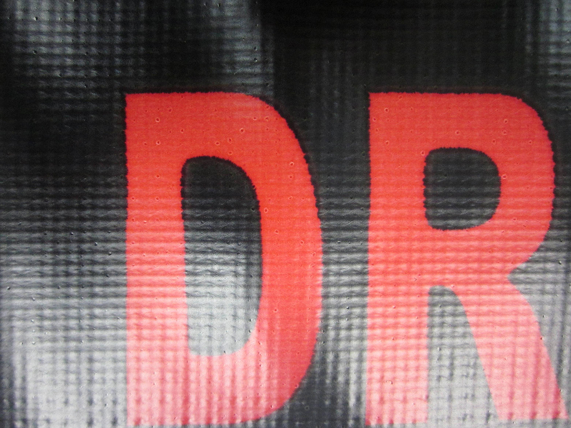

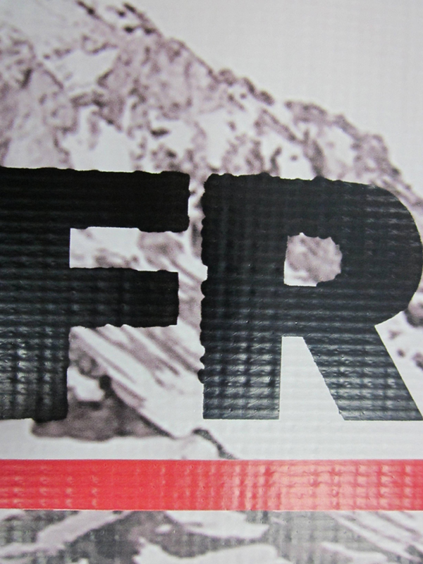

HP L26500 Ink Issue
Freese
Only happening on Banner...tried a few diff kinds and manufactorers...and diff artwork.
Using Flexi 10.5...check the pics. INcreasing dry and cure heat only waved the material...ink is still dry regardless, but thought increasing temp would help adhesion.
Anybody got any suggestions?
See pics
:thumb:
Slamboni
DEcrease dry and cure heat in increments fo 5 and increase vacuum and passes. We printed on that stuff last week and with those tweaks it ended up looking fine on zeelon.
