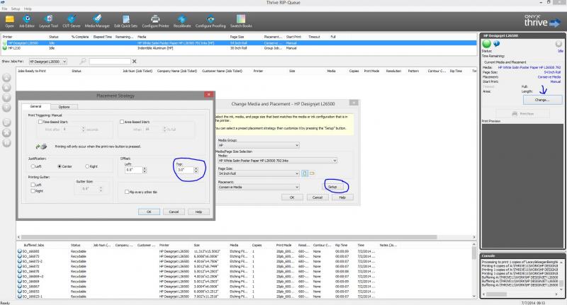

Ditchmiester
In the printer settings in the rip you can set the front edge feed. Or it can be set from the printer front panel but I'm not in front if mine right now and can't remember where if is for that setting.

This is how I change the setting.

CES020
You're right, it's at the top, it's the bottom I can't find the place to control that, so it cuts off about 1/2" from the bottom. Is there anywhere to change that, that you know of?
Ditchmiester
On the printer menu. Go To Media Setting > Substrate Handling Options > Extra Bottom Margin
From there you have a list of options you can select. Hope this is what you are looking for.
