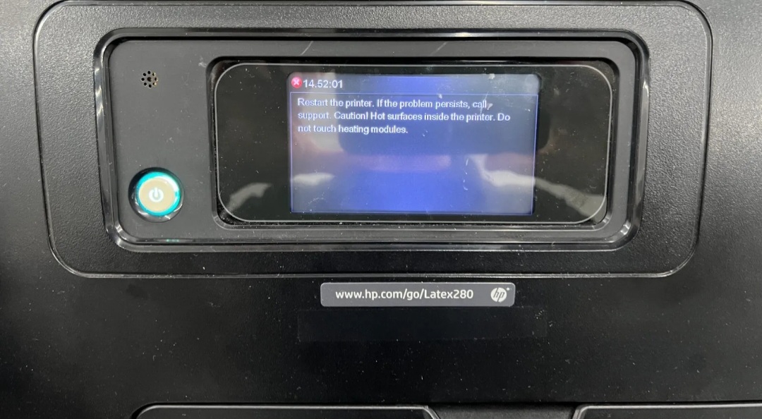

So I purchased an HP L280/L28500. It has an error code of 14.52:01. According to HP that means...
  • Code: 14.52:01
  • Description:Overdrive power regulator V null and fault
  • Causes:Overdrive power regulator V null and fault.
  • Remedy:1. Switch the power off at the rear of the printer, wait briefly, then switch it back on again. 2. Run the Monitoring Sine-waves and Resistances diagnostic test. 3. Check the Residual Current Circuit Breakers. 4. Check the input voltage.
I really want to fix it so we can run banners on it exclusively. Does anyone know a trick to fix it or can repair it? We are in Charlotte, NC.
