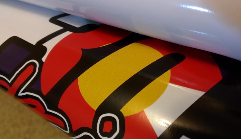

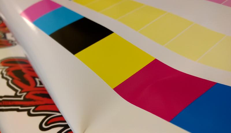

I'm running into a constant issue with the yellows on my HP L310. It's been like this since day one, and I have no idea why nothing I've done won't get around it. It's real... spotty. Doesn't matter what media, what profile, or if I send CMYK or RGB data, I get the same results. Yet, when I print a color calibration, it has a nice clear vivid yellow. For what it's worth, this is on 3M IJ35C (gloss). I've also tried increasing optimizer to 24, and have tried 10/12/16P, no change. RIP is Flexi. Any ideas?
Nice clean color calibration yellow:
The yellow/spotty issue I'm experiencing:

I'm having the same issue with Red, and my yellow looks fine, tried what the HP support reps said, no help. Spent a couple hours on the phone with Flexi, no improvement.
If you figure out your yellow problem, please let me know so I can see if it helps with my red problem.
Good luck!

In the color setting box under rendering intent
I have set vector, text and gradient to no color correction for CMYK values.
This I believe this makes the printer print the percentage values you choose.
If you choose 100% that is what you should get.
I to have a 310 and I am very pleased with my color.
So far I am reluctant to install the latest firmware update because I like my colors,
but you say your printer has always done this so firmware probably is not the problem.

What RIP? SAI? If so, SAI is RIP only with no real color mgt. Might consider upgrade to SAI PRO or purchase Onyx or Caldera!
401Grahics: If you delay purchase, delay just long enough to save an additional $5K to purchase L360 instead! :)
Either way, you will love your latex ink printer. :)

Flexi Cloud, which is the top end version for print/cut/rip.
Love the printer, just having an issue getting red dialed in, I'm sure it can do the color, I just haven't figured out the magic sauce for it yet.

I wouldn't - it's just getting the thing dialed in still. All my colors are great except for yellow, and I'm positive it's just a settings issue I need to work out.

Thanks! I will give these a try today.

Flexi Cloud here as well. Interesting!
