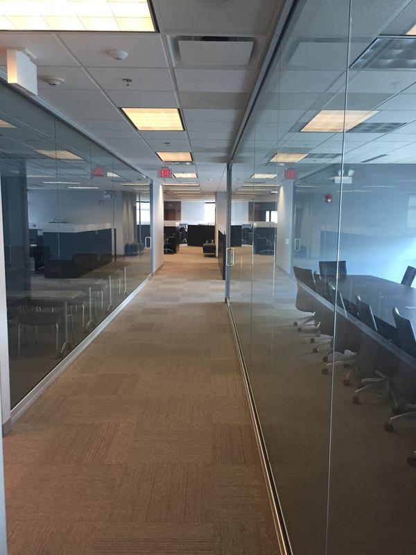

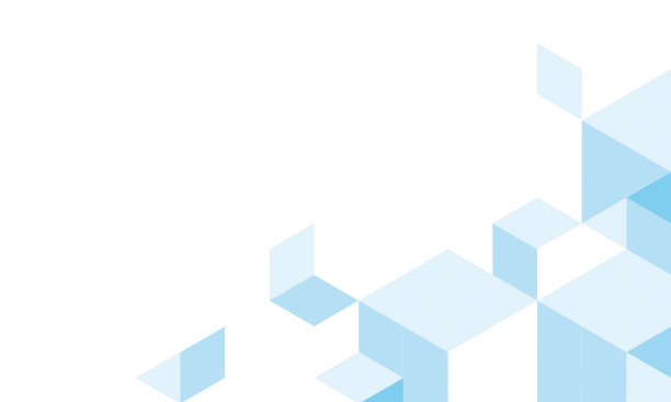

I have a project coming up and I'm trying to figure out how to accomplish it. This customer wants the attached pattern minus the white background and similar variations of it applied transparent to the glass walls in the attached photo spanning both walls. I've thought of transparent colored vinyl, but I can't find those exact 3 PMS colors and it would be a PIA trying to apply all those individual contour cut colors like a puzzle on that glass. So with that being said, is it possible to print on clear vinyl with the L360? If so, what vinyl do you recommend that works well with the L360, has air release or can be wet applied to the glass? I think printing the entire pattern, contour cutting it as a group, applying application tape then applying would be the way to go. Any other tips or suggestions are much appreciated! Thank you!

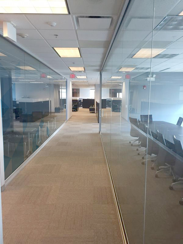

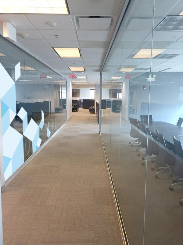

Just making sure you understand the colours will be washed out? Because CMYK inks are translucent, they effectively multiply over whatever is "behind" them - be that a white print surface, or whatever image comes through a clear glass. Think of it like an overhead transparency film.
So it won't look like this:
It'll look like this:

That is the effect that you'll get. As was mentioned above, you may need to bump up your ink density to get enough saturation, otherwise it may end up too subtle. Since there are a lot of Windows, I'd suggest you do some small trial prints and stick them on the customer's glass before you do the full run. Maybe run it on a normal Poly SAV setting, and also trial using a backlit setting. It'll be slower but will give you approx twice the ink density.
