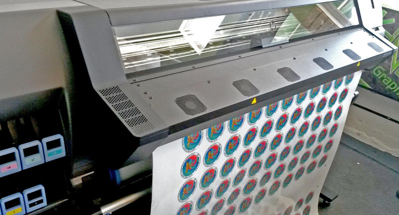

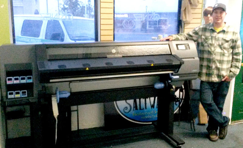

Yep this thing rules. Got it through a small (33") door on a furniture dolly. Set it up in a few hours. Downloaded flexi and had to wait for ink over the weekend.
Loaded 54" poster, and did a calibration on the optimizer ink. Looked all burnt up, but that's what it was looking for I guess.
First test print: A 30mp photograph @ 53.5" wide. Came out so nice, and fast at 600x600. I couldn't scratch the ink off without tearing the substrate.
First job. 2,000 Stickers. 4" x 4" die cut circles. Printed them on Oracal 3651 using the default "Generic Self-Adhesive Vinyl" profile. Cut them with my roland 30" in sheets of 100 or so. Came out so nice!

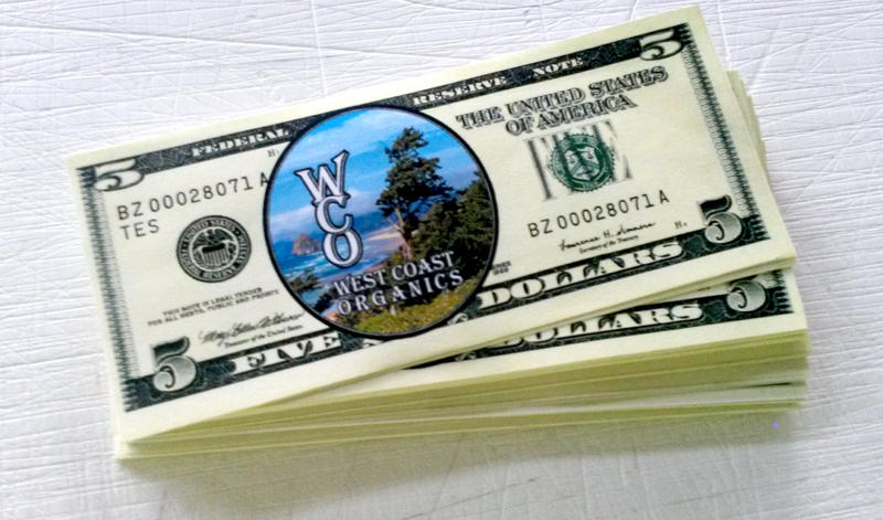

Second job. 16 posters for an organic soap company (27" x 30" printed 2 wide @98% scale). Pantone colors matched and everything! Ran some gift certificates also but they took a while to separate (was worth it for the 500 shirts in the order).
Third job (2nd day printing) 2 Banners. 3x7 and 2x6, full color. Generic media and profile untested. Came out flawless! Also ganged up a bunch of bumper stickers and nested a sheet of "minimum orders" on the 3651.
Wiring up the (2) 220v outlets is not that hard either.

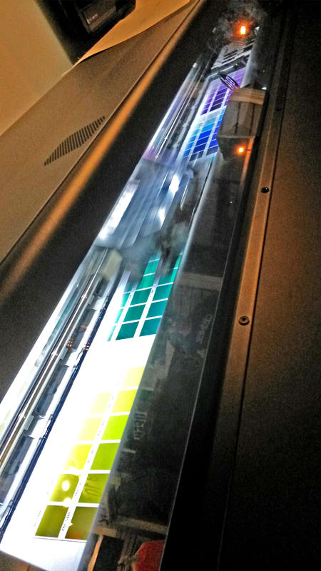

I can't wait to laminate some of these other random prints (like a Pantone chart) and take some orders for canvas and wallpaper!
I have calculated that I am using 1ml ink per sq.ft. full coverage, and half that for normal printing. Hoping for some bulk latex soon.
Scratching the ink is not possible, I can stretch stickers till they rip and the color remains opaque, right to the edge~
No Fumes or none of that solvent nonsense, and no waiting 24 hours for outgassing.
I upgraded from a HP 5500PS UV (aqueous) 42", haha. Have worked with Mutoh, Roland and HP but HP is always the best. Just don't use their media, and wait for bulk inks!

Before the questions arise, this machine does not come with ink. Nor does it come with a print/cut solution. You actually have to cut the media roll inside the hot machine with a box cutter in a small track to separate a sheet. I am using roland cutstsudio plugin within Illustrator for my print/cut.
I made a template that is 720mm x 1290mm and this fits sideways in my roland 30".
This machine does not come with a pantone chart. You can make your own like I did, or just (google: pantone chart; filetype: eps) something.
No money/gift certificate/anything come with the software either (these are one sided and not to scale if anybody is worried). These might be considered advanced techniques.

It's great to hear that you are so pleased with your HP Latex 110 printer. Just a couple of points that I would like to clarify:
1. All models of HP Latex 300 Series (plus the 100 Series) print at 1200x600 dpi at pass counts up to 16, and 1200x1200dpi at pass counts greater than 16.
2. Rather than cutting the print off the roll inside the print zone, I might suggest advancing the media (from the Front Panel) after the print is complete, and cutting it outside of the printer. You can always move the media afterwards to your desired position for the next plot.
3. You are able to use all Media Presets for the 300 Series on the Latex 110. You can obtain them directly from the printer's front panel (Media Library), or through the Embedded Web Server interface (browser-based).
Enjoy!

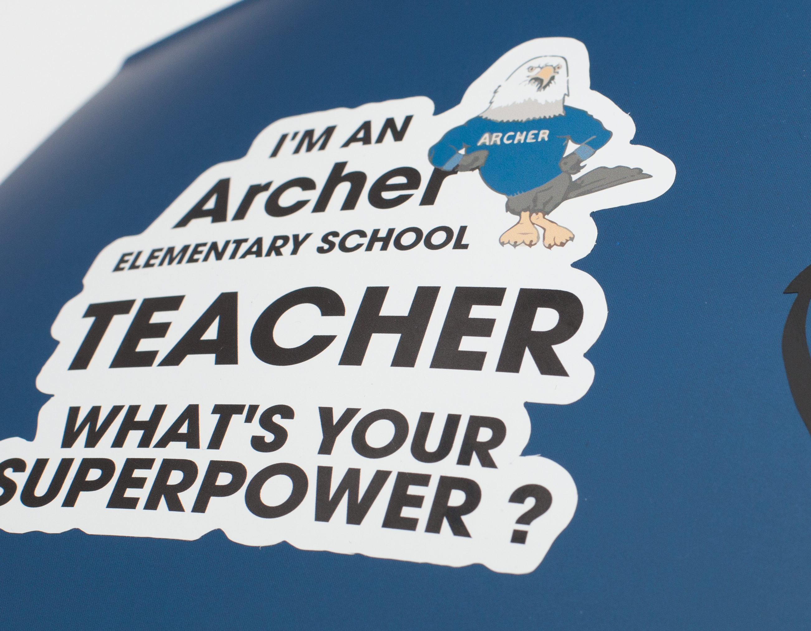

I just love how people start to downthumb me when I say solvent is so much higher quality than HP latex. On the attached image you can compare the printed blue t-shirt graininess with the background's blue surface that is printed with an ----OFFSET---- printer and it's actually more grainy than the digitally printed one :D (download the image to zoom in)

Weird, I print lots of 600ppi canvas at 600dpi and have never had a grainy print. Charging $12 sq/ft. for printed 21mil canvas all day long with multiple photographers.
Printed 384 sq.ft. of IJ-35C today for a furniture store at 600dpi from 50ppi images and they had zero graininess...
Latex is not the problem.
Literally scroll up to the top an see my original images of $5 bill gift certificates. The detail is insane, an printed in latex...
Are you kidding right? You can print canvas with a 11.5 feet long $5000 chines banner printer and it'll still look pretty good. Try printing GLOSSY vinyl to see what a grainy print looks like.
There is nothing wrong with latex and instant dry can give you considerable advantages over eco solvent, but for fox sake please don't tell anybody that Hp has ZERO graininess. It has acceptable graininess for you.
Cheers.
