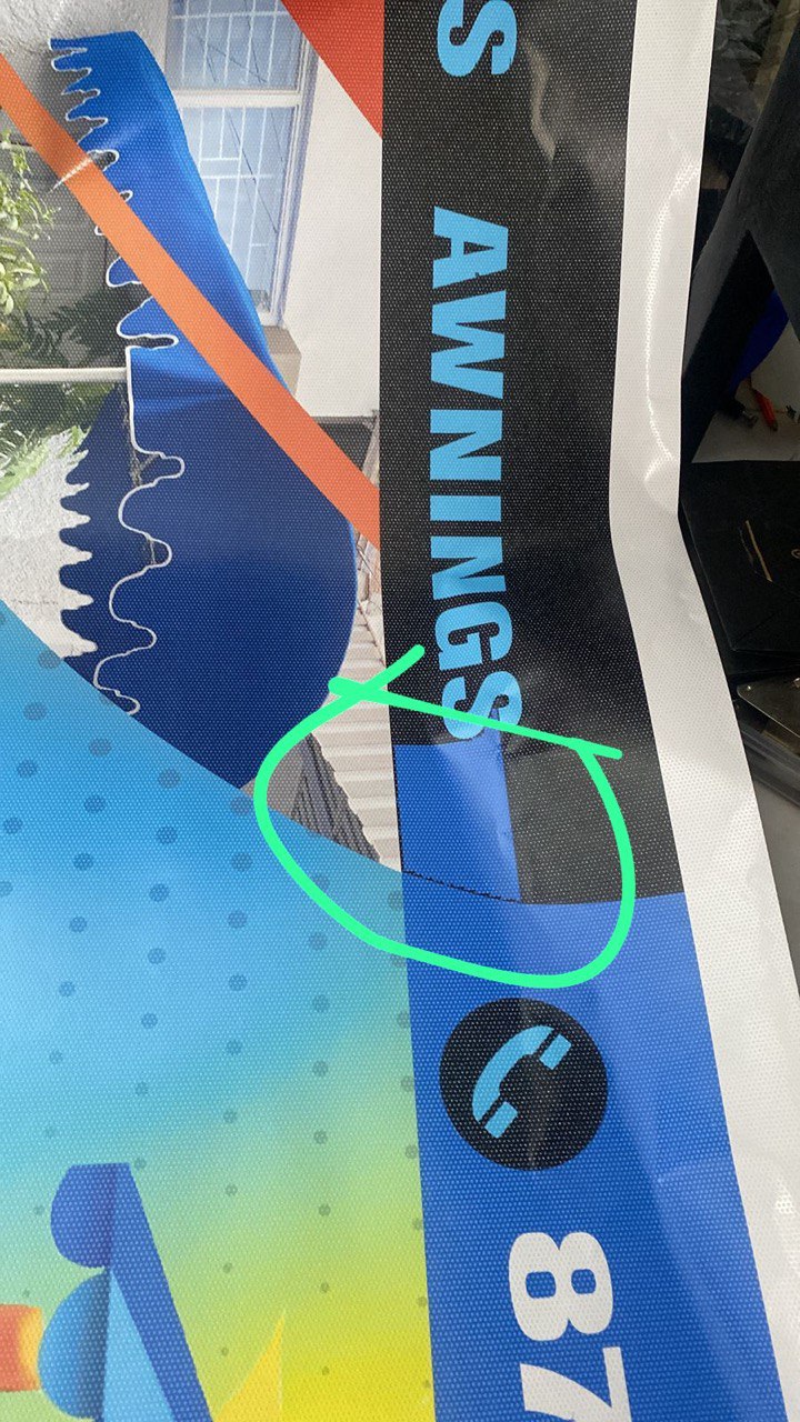

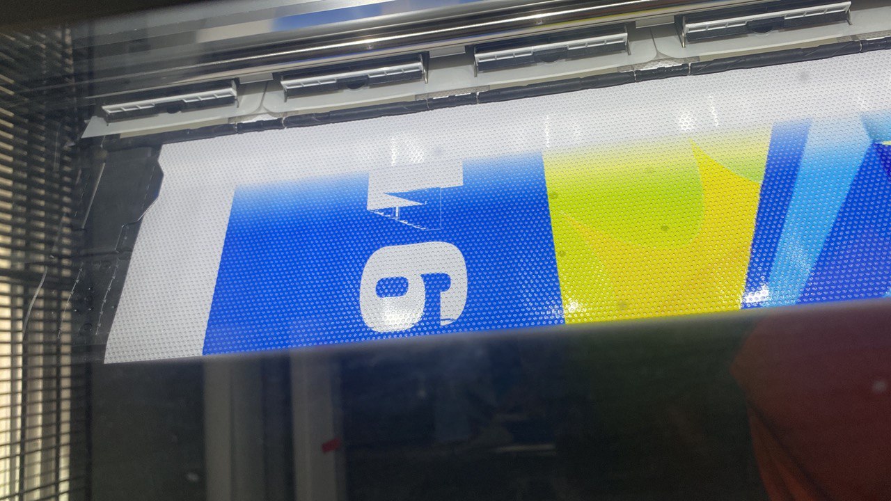

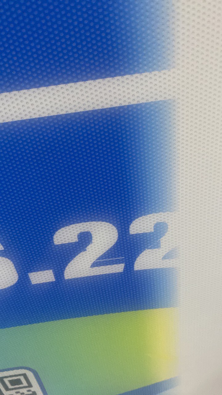

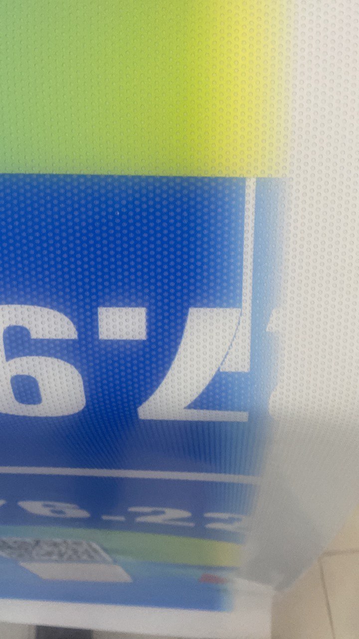

The printer is getting some horizontal banding and also laying down ink where it's not supposed to as shown in the image attached.
What's bizarre is that it will print a perfect white "Letter A" and then a few inches down the print it will mess up the other A by applying partial color to that white "Letter A"

Do you happen to use Flexi RIP?
That very likely comes from your file/RIP and has nothing to do with printer.
