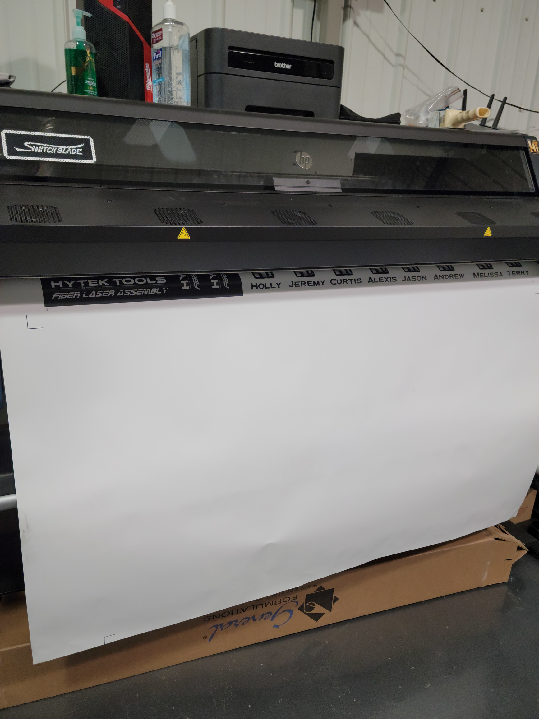

Just wondering where to adjust so that I can use the first 12"-24" of substrate. The printer just seems to never want to use it.
Like this:

Go to settings and substrate settings. Remove the front lead (0).
Check your rip that there is no front margins and remove them if so.
Lastly before you start printing make sure the leading edge is far back enough (I recommend just inside the heater).

Our 560 always has to start OUTSIDE the heating zone....just below the flip-up access door on the front. Otherwise, it gets jammed typically and just causes head crashes or the material to buckle and rub on the heater above. Not worth fighting with it to try to use the "x" inches.
