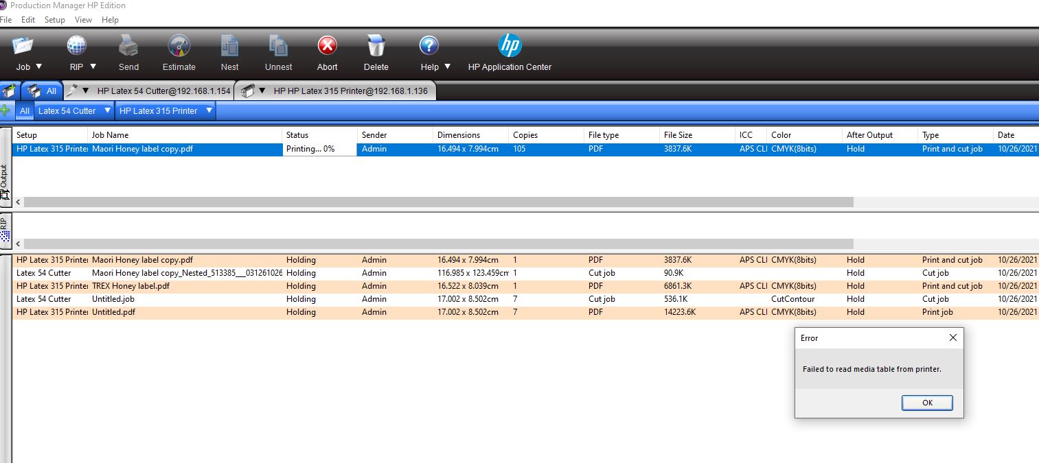

I'm having an issue with the SAI Flexi Production manager software not being able to read the media size from my latex 315 printer, it's just started happening, was working perfectly. I have uploaded the latest firmware and its coincided with that, I think!
We get the message “failed to read media table from the printer”.
Anyone got the same or the answer to fixing it. Or any idea how I can do a factory reset?
close out production manager alltogether. Don't just minimize it or say done.
I close it by doing a "Control-alt-delete. Open task manager - go to processes and click on production mgr and delete it
Send the job again, It will go through the questions such as "on this computer or the network"
It should work. I would generate the file from flexi again and not select the old file from production mgr
Ezek0
If you dont mind loosing job's history, I would just reinstall the program. That most of the times helps. Good luck

Turns out this was a simple IP conflict, the nasty BT router that came with our broadband hit a snag and that was all it was. Changed the IP address and bingo, away she goes. Looking at a new router that i can lock the IP address down.
