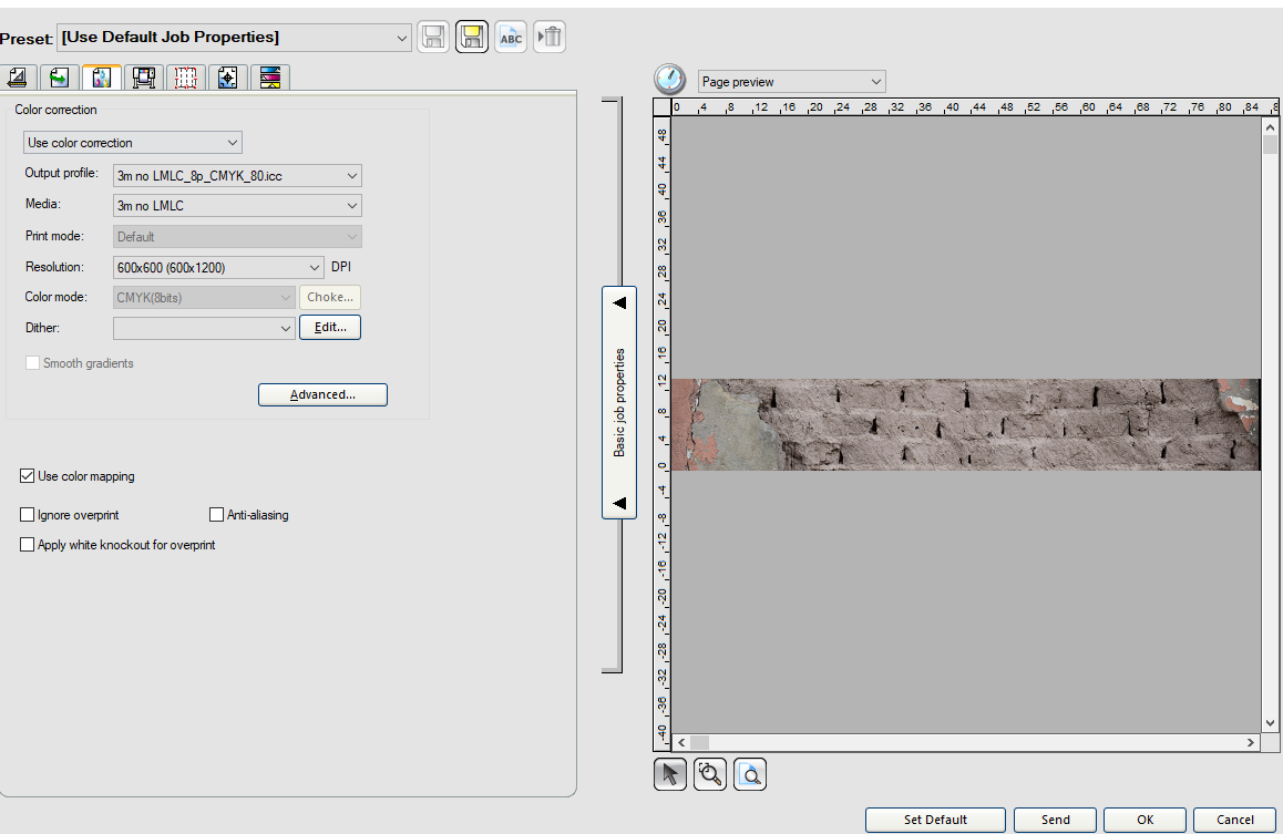

Ok I printed my problematic print and its still pink, I used color correction though. So in my RIP how do I copy that ICC profile? In Flexi I selected the MEDIA ad the .icc is automatically selected to that media too. Is that what you mean by copy? In Onyx it does it all automatically....
I think my LMLC may be the culprit too, it is out of warranty but installed 6/24 and about 1400ml fired.

If you see the pinknes it that preview, you know for sure you have something messed up in your workflow / color correction.
What if you turn color correction OFF and see how it looks?
depps74
I did try that and it printed more grey..... I set up that profile, it was a little less pink, so I replaced the LM / LC and of course now it seems to be fine, however this head was installed 6/24 and had 14 ML. It was reading out of warranty, but the date on the head is t through 6/24. Do heads normally go this quick? My shop can get pretty hot during those heat waves, but in my experience the heads go during a long run of prints.
