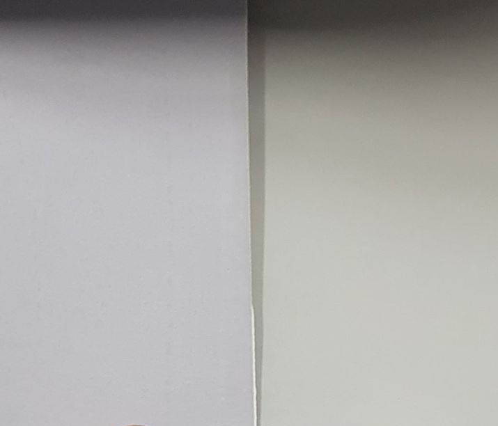

I have thought that i have things sorted out with this machine. I had this profile with perfect greys for years but after switching all printheads to new ones besides the OP one in a span of one week i got a color change and now my profile with a perfect grey has a yellowish tint on it. I tried doing a new media profile from scratch, all sorts of color calibrations/ICC profiling within this profile aswell as on the settings menu aswell. Nothing helps, the yellow is noticable on all new profiles i make.
Any thoughts. Thanks in advance.

How is the nozzle check? All open?
Did you do the automatic printhead alignment? Went ok?
Did you try to do the colour calibration on that original profile of yours? If it even had the calibration done on that before.

All printheads new, except OP. Printhead aligment done. I ran the color calibration and ICC profiling at least 3 times on the oryginal profile and nothing helps. On the left is my old grey, on the right the new one.

Yeah I know, new heads. Still it's best to check that the nozzles are open, it can affect the shade of the colour. Even new ones can have stuck nozzles.
You could try to clean the line sensor and re-do the printhead alignment.
There's lost of different possibilities for this. You could have a dirty white point in the spectro etc etc.
