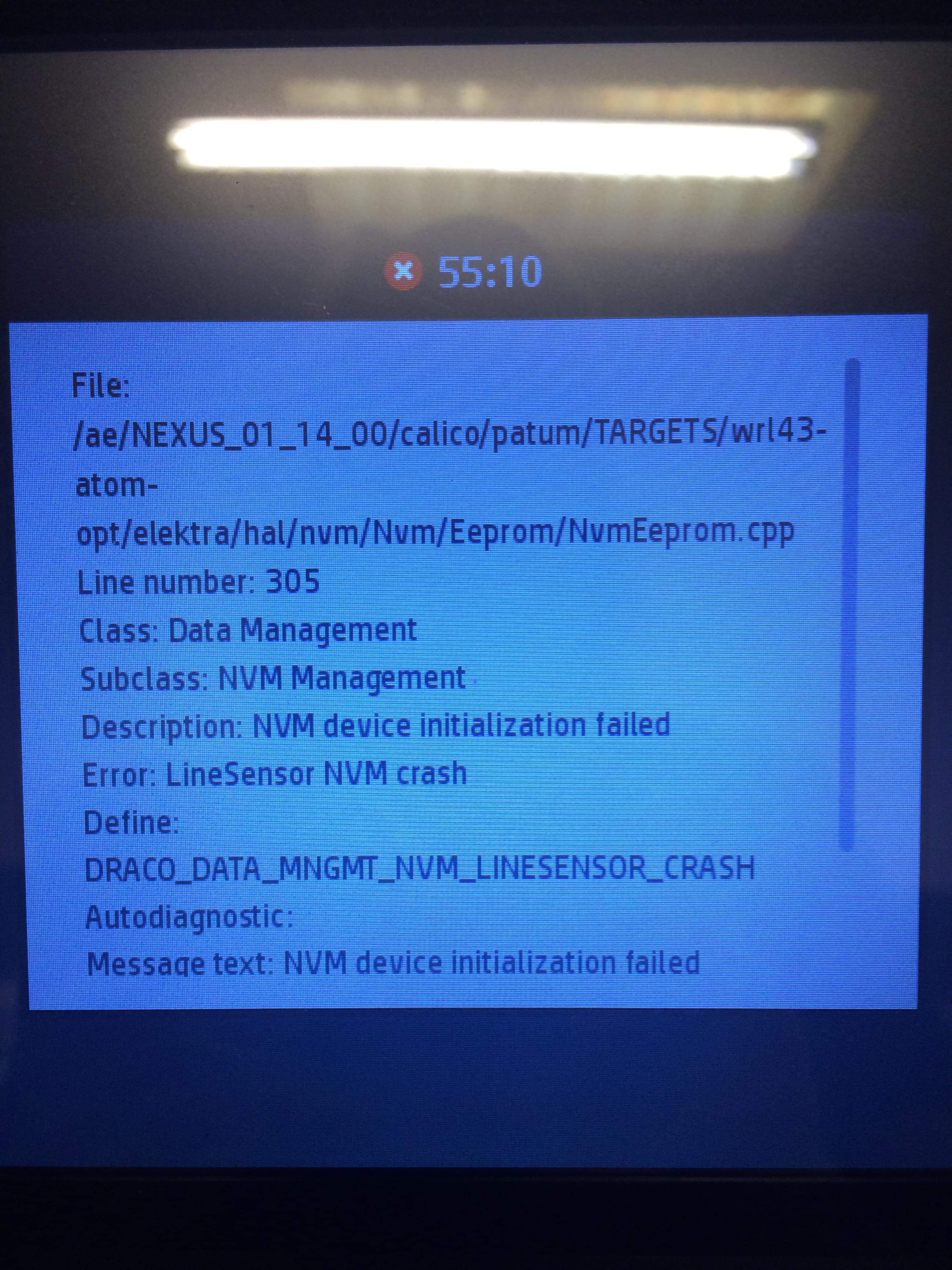

6A1F967B-9E72-483B-A4EB-49C0378AED53.jpeg See picture attached.
I'm getting this error (See image):
Printer was doing fine, but then stopped, tubes as changed not long ago.
A techie says it's a new Line Sensor (fairly easy replacement he says).
What say you guys, is he right?
Please help, we cannot afford a large scale repair :(
Santimus
Member
That error code is a line sensor communication error. If a hard reset doesn't work and you feel comfortable self repairing then see if you can re-seat the plug. If you can't get it or don't feel comfortable doing it then you will need to get a tech in there to replace or reseat it

Thanks guys, ending up replacing the line sensor, true story on the one screw and a 50 bucks payment.
Funny thing is, karst41 , I can afford it, but I cannot afford to pay overprices for something really simple. And yes, I can have our work made at another company in town, so that's no problem.
The problem comes when the repair guy tells me it's a $3775, repair job, when:
1. Printer was doing fine making no errors what so ever.
2. Stops from one second to the other. And suddenly repair guy, says it's a #3 service code. Wich it did not say anywhere. I have seen this code before, so naturally I didn't believe the douch.
He tells me the tubing needs to be changed also.
When I opened the side panel, tubes was clear. No reason to change those.
