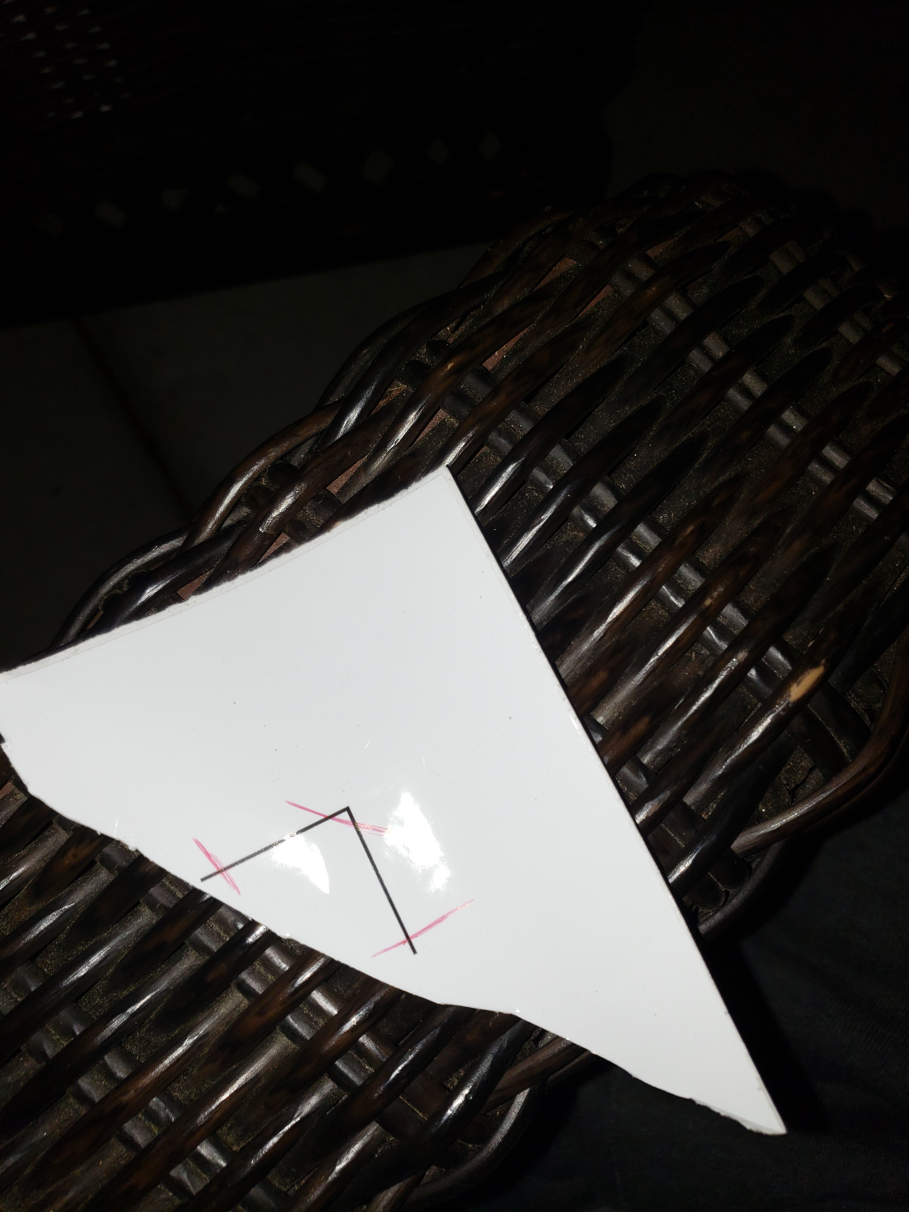

Cut marks from other white printed vinyl cut jobs (see attached photo, cut into the crop mark so you can align) and place over reflective marks. The cutter reads the inside of the crop mark.
I have done this many of times on reflective material and when I dont have enough vinyl to complete the whole decal order.
