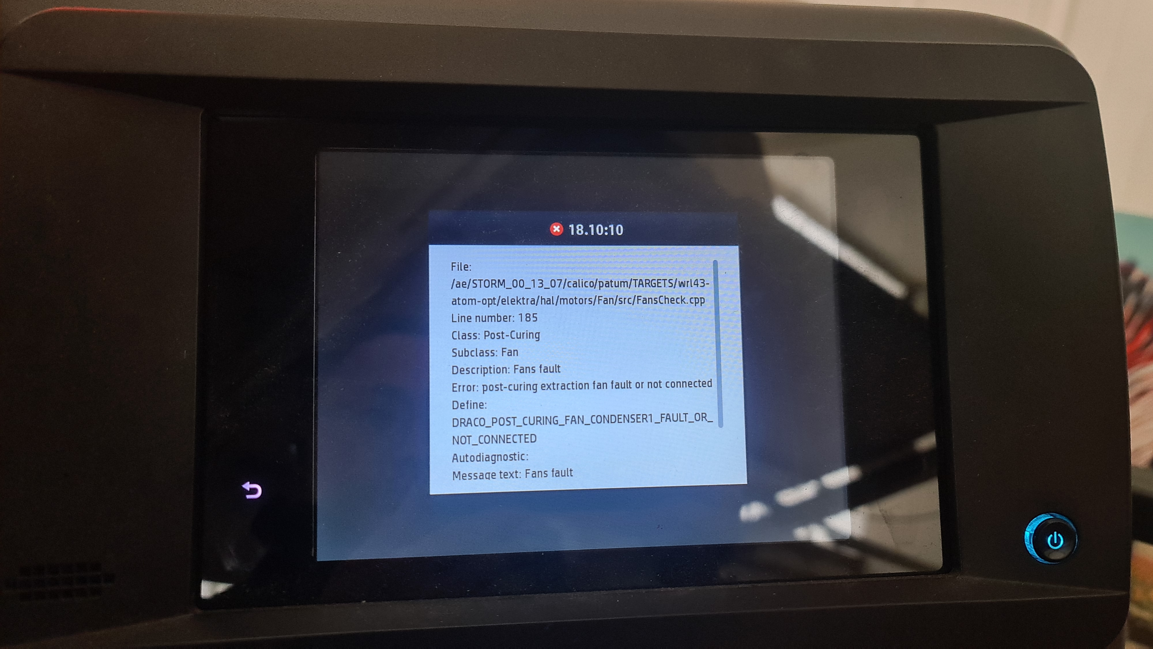

The L570 worked fine before Xmas.
However it showed 18.10:10 error anytime when I tried to print today.
power off/on doesn't solve the problem.

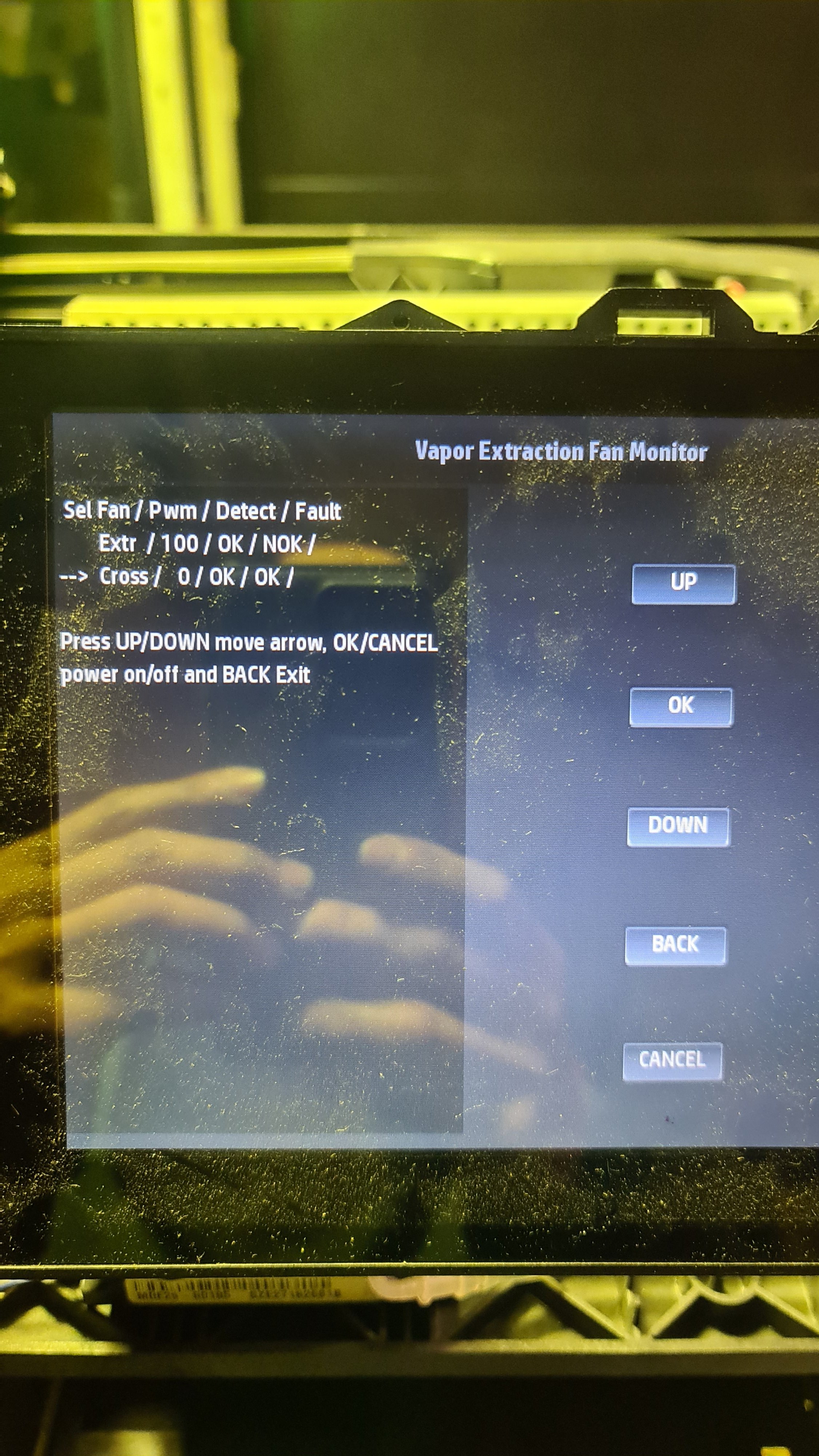

According to the menu, it is the top extraction/condenser fan.
I can activate the top fan in the curing menu and hear it running.
When I removed and switched the two fans, both fans were running before it showed 18.20:10 error.
Will it confrim that the top fan is faulty?
is it the fan or board?
Thanks.
