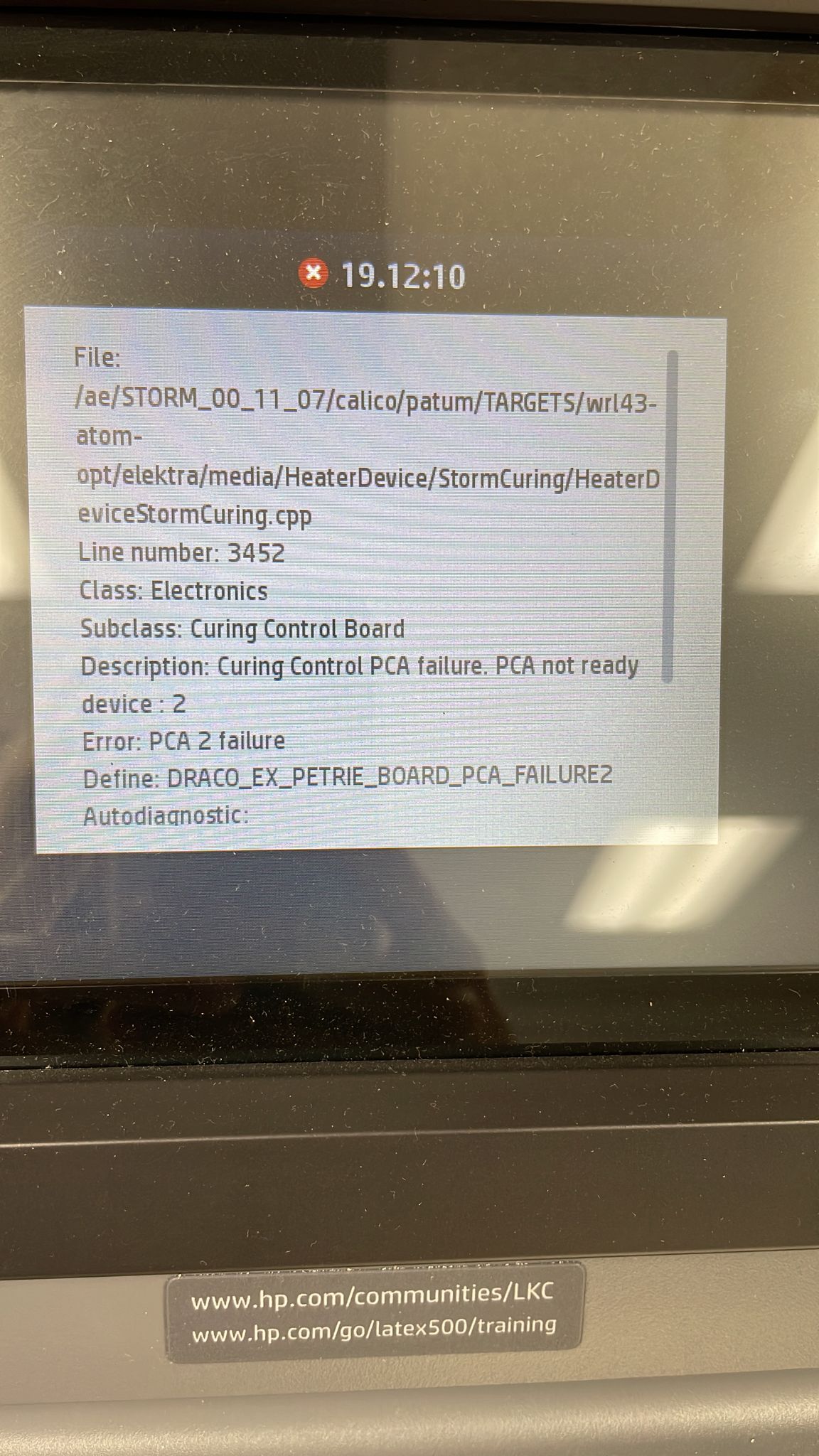

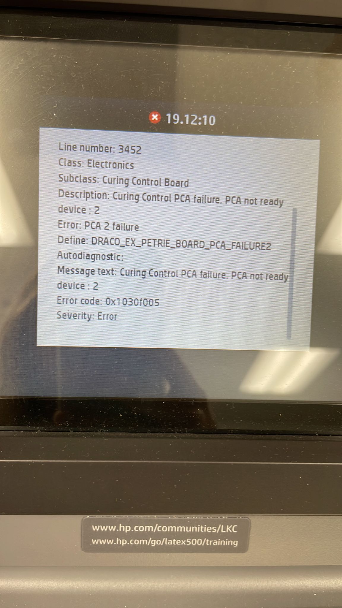

Hello,
My Machine is not under warranty and I am having this problem, I called HP support and it cost really high to have the machine repaired so I am not sure if I can have the parts ordered and do it myself, if someone here had this type of issue that could help, I will appreciate it.
I have not found any information on how to do this, also have read of some of the service manuals but have not had any luck finding it, if someone has it and can send it to me, please.

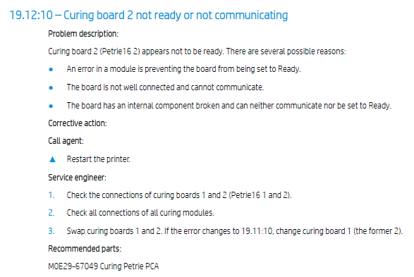

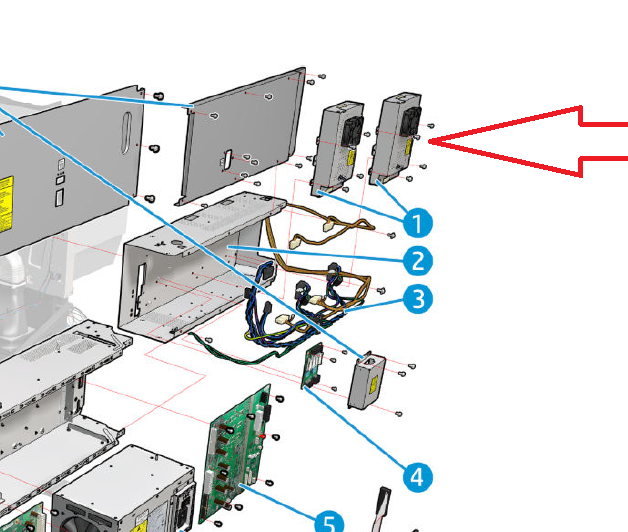

Check all the connection on these curing PCAs. Also check all connections in the curing heater.
Then swap these and if you get the different error you have a faulty PCA.
If not then you have a connection issue somewhere.
