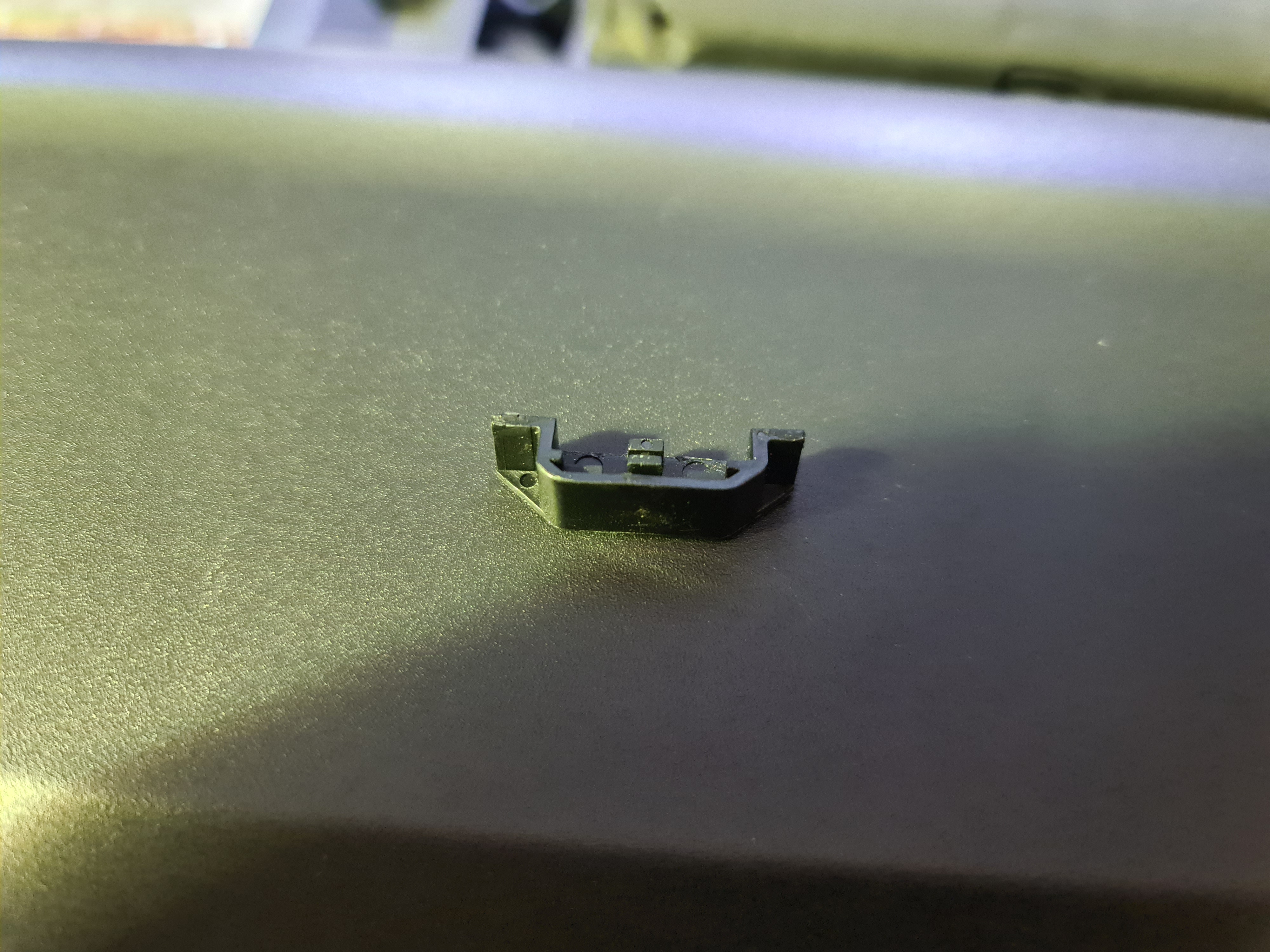

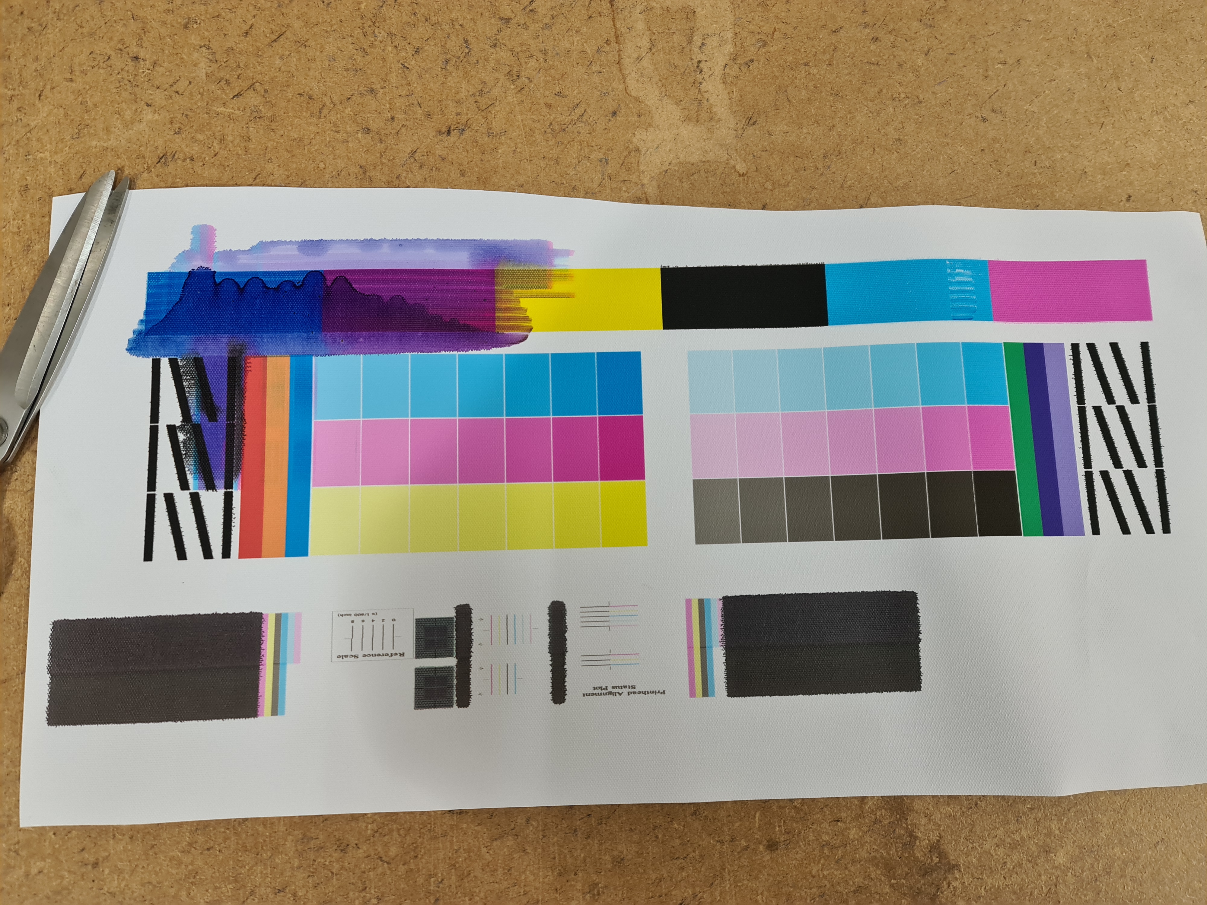

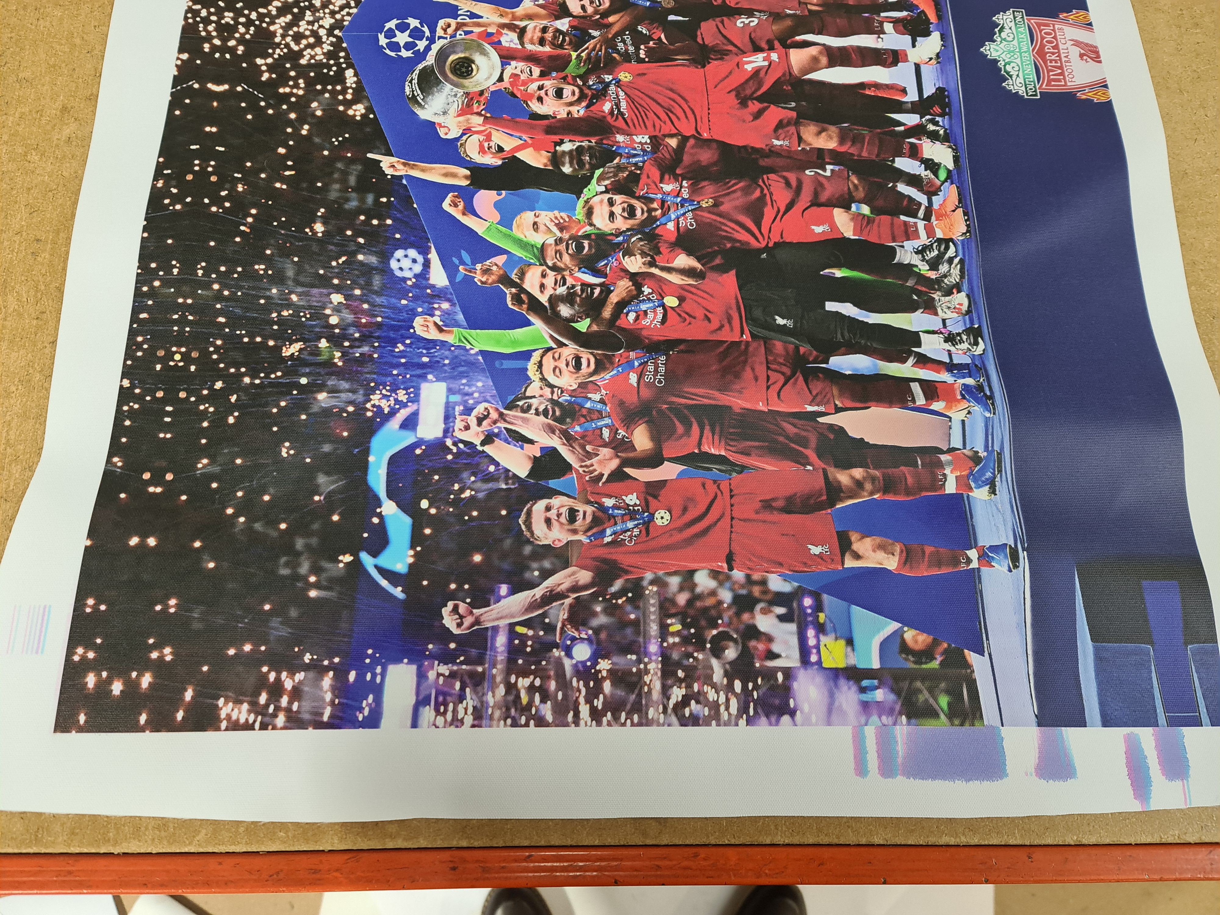

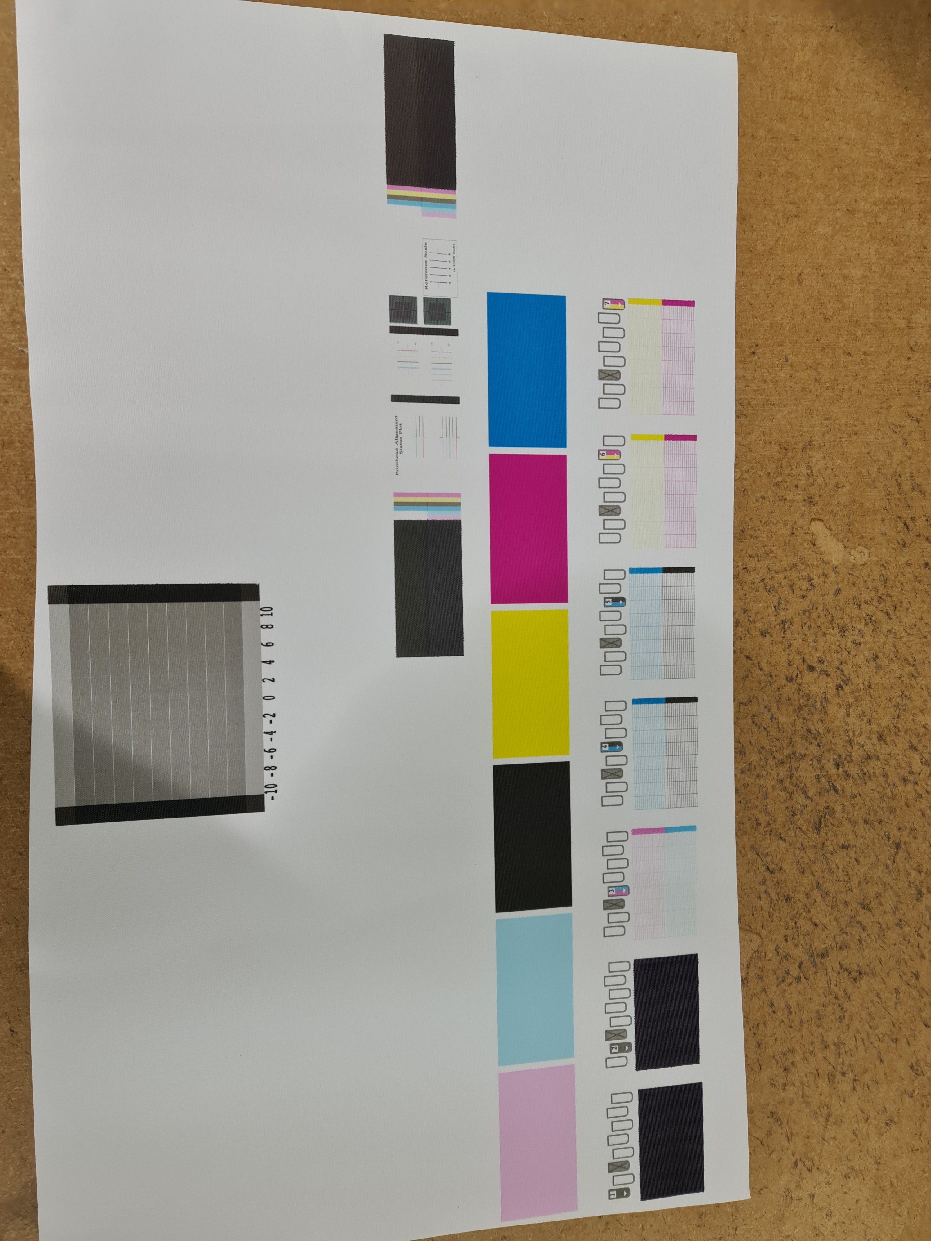

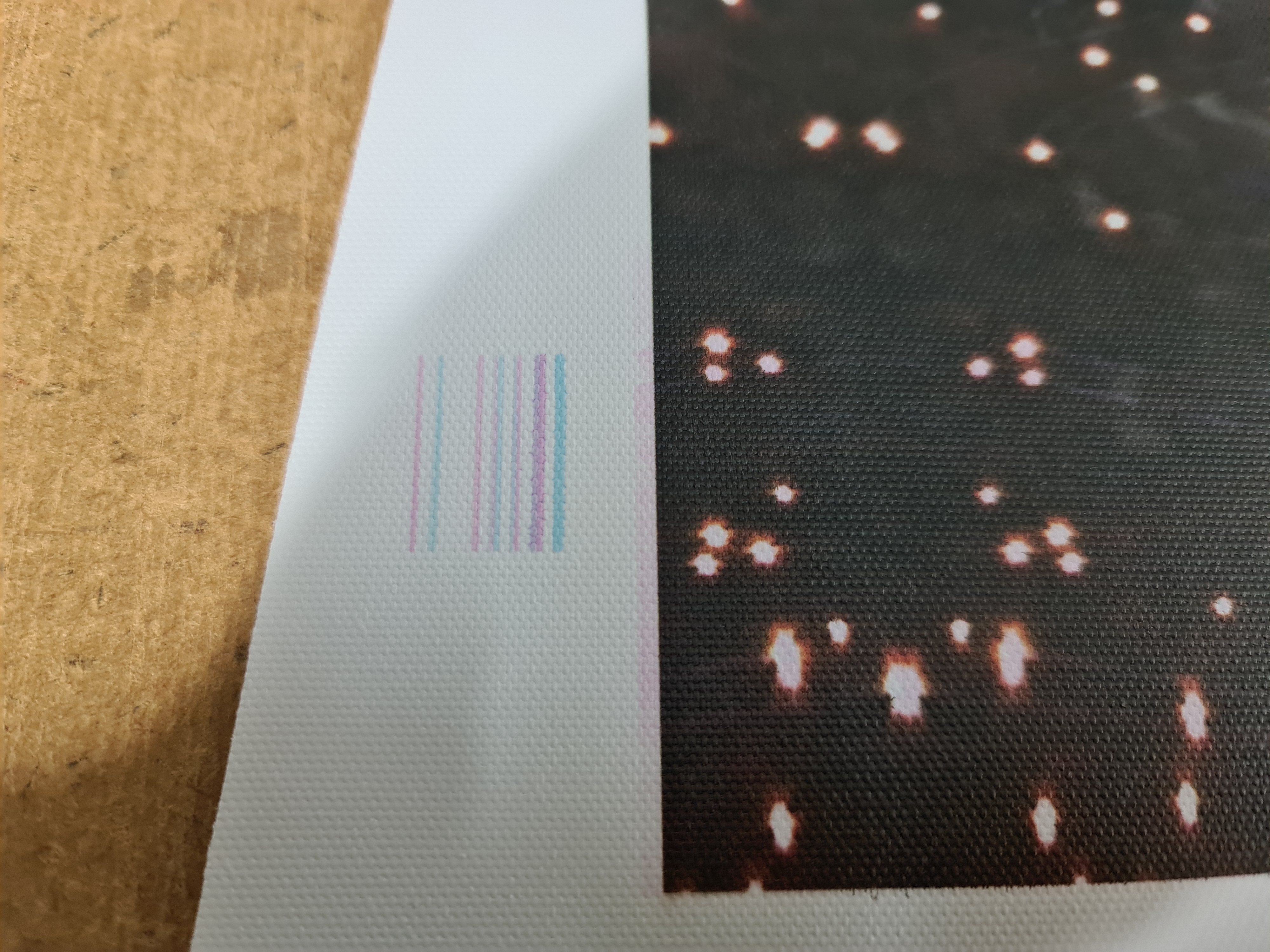

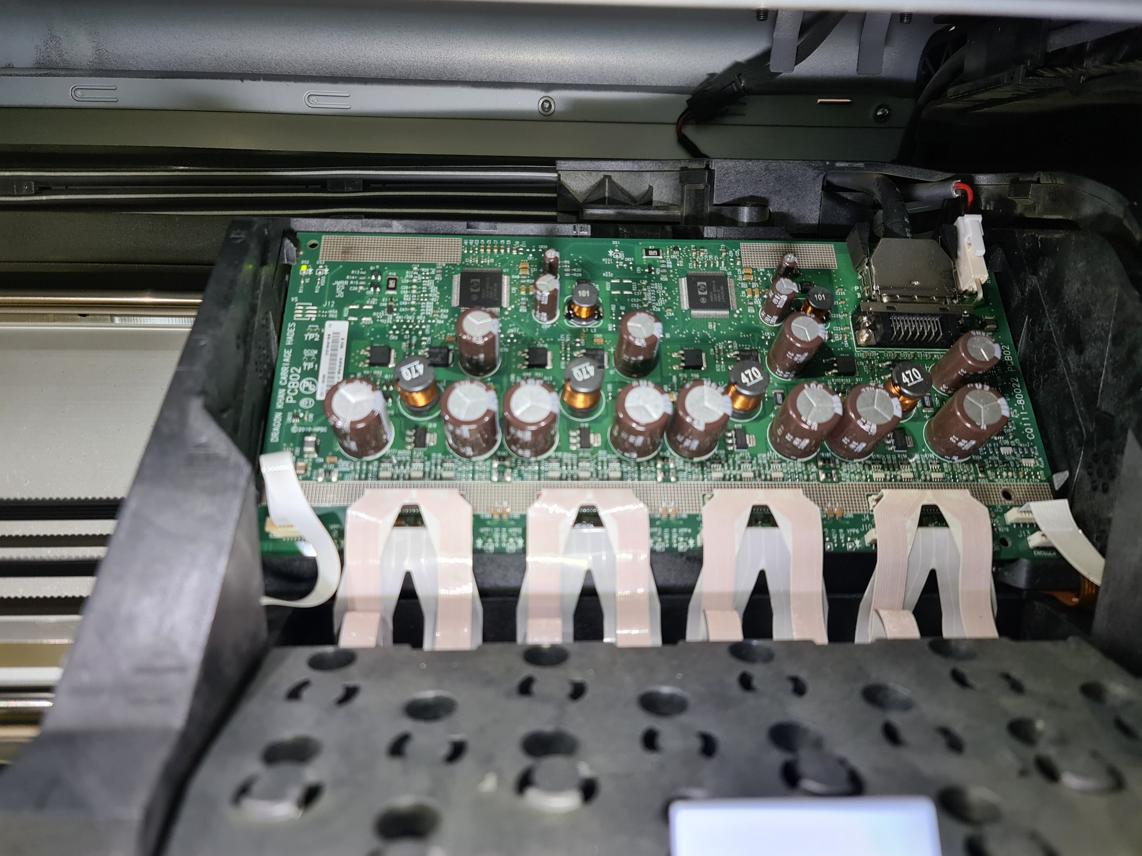

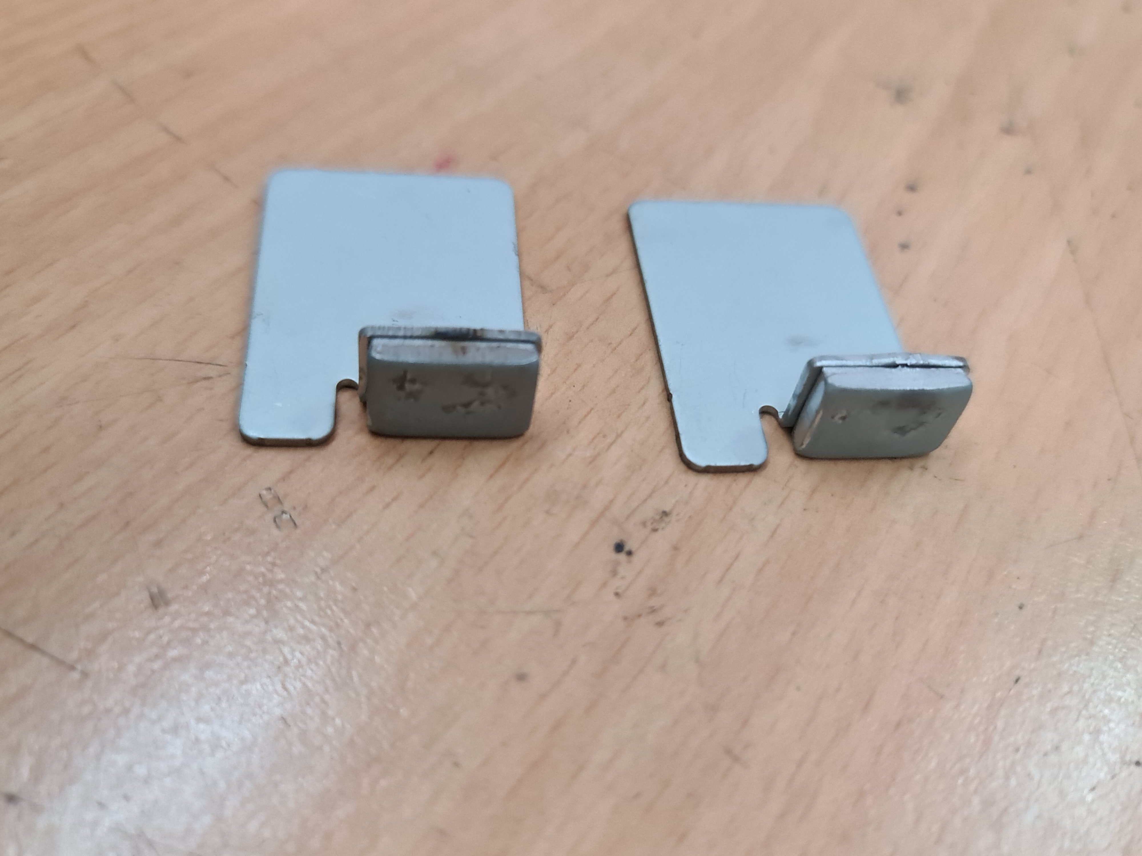

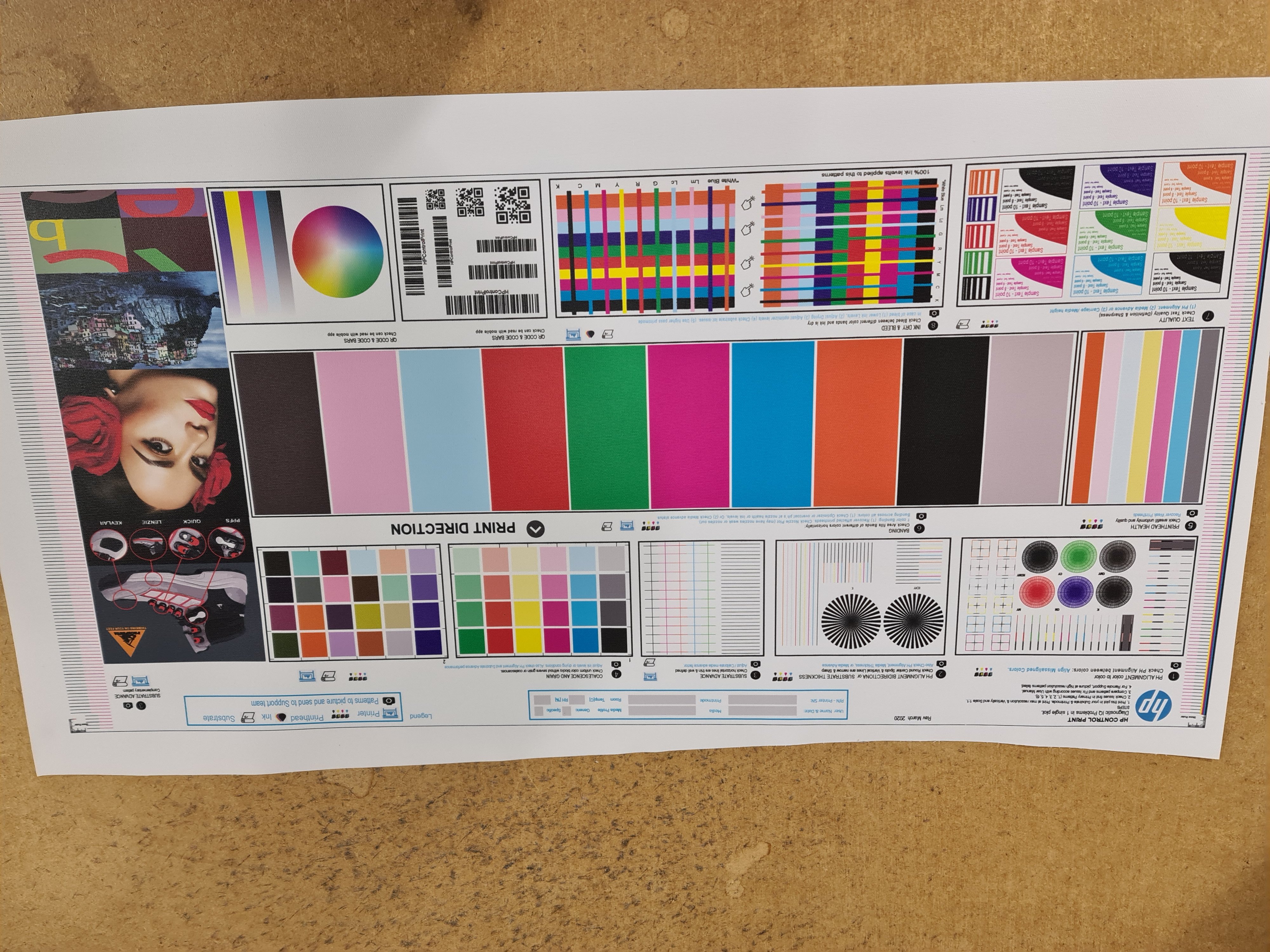

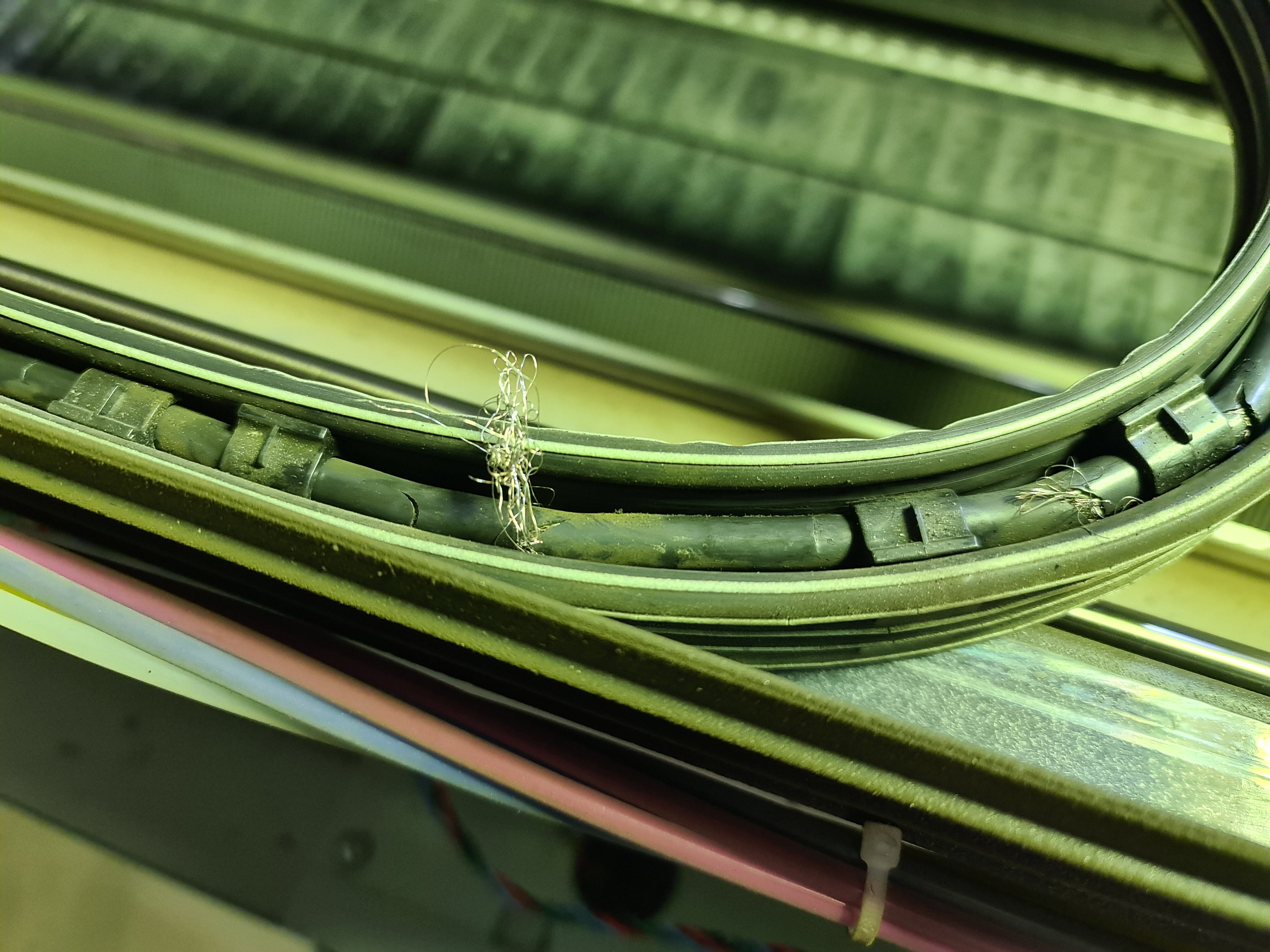

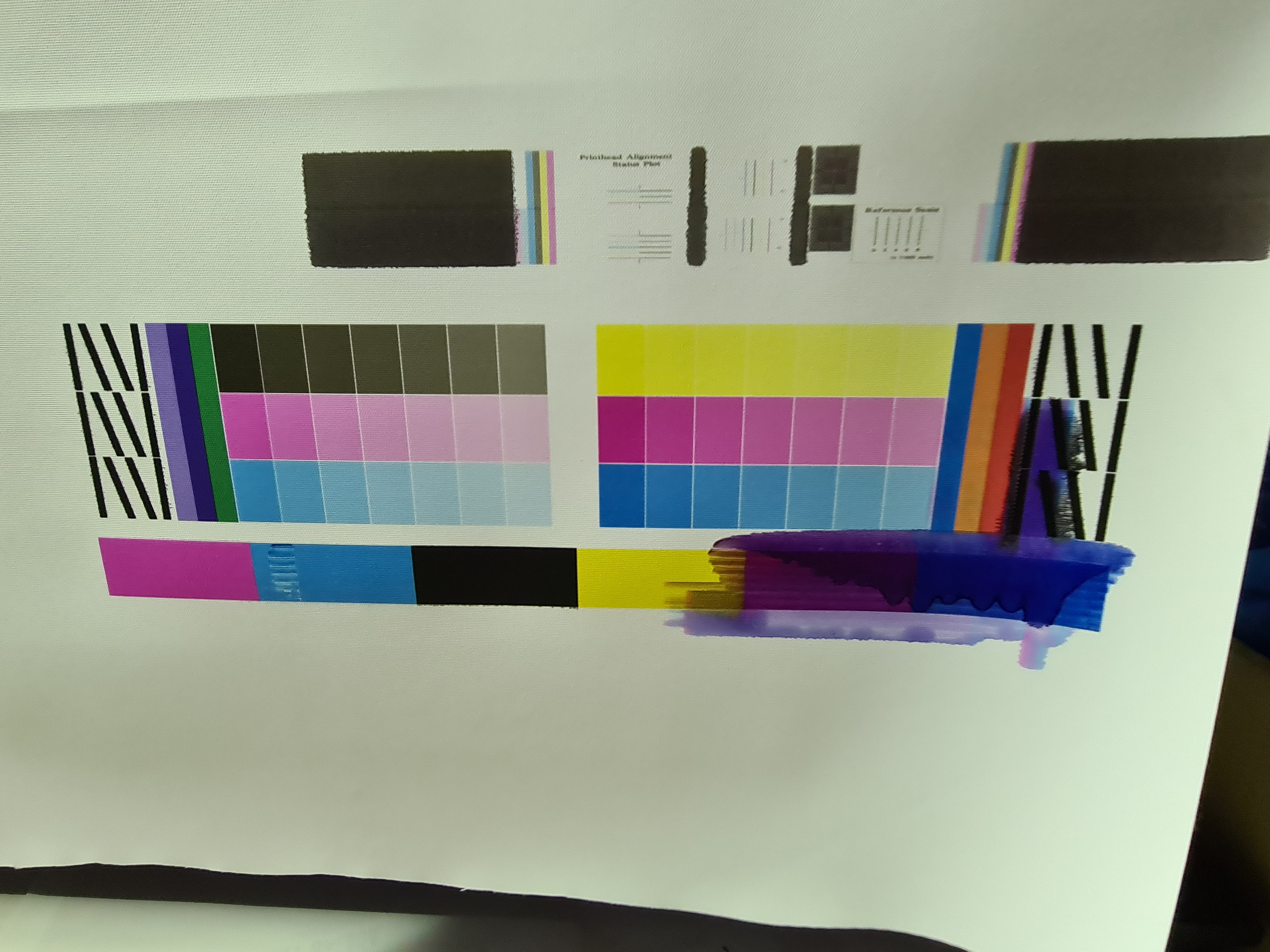

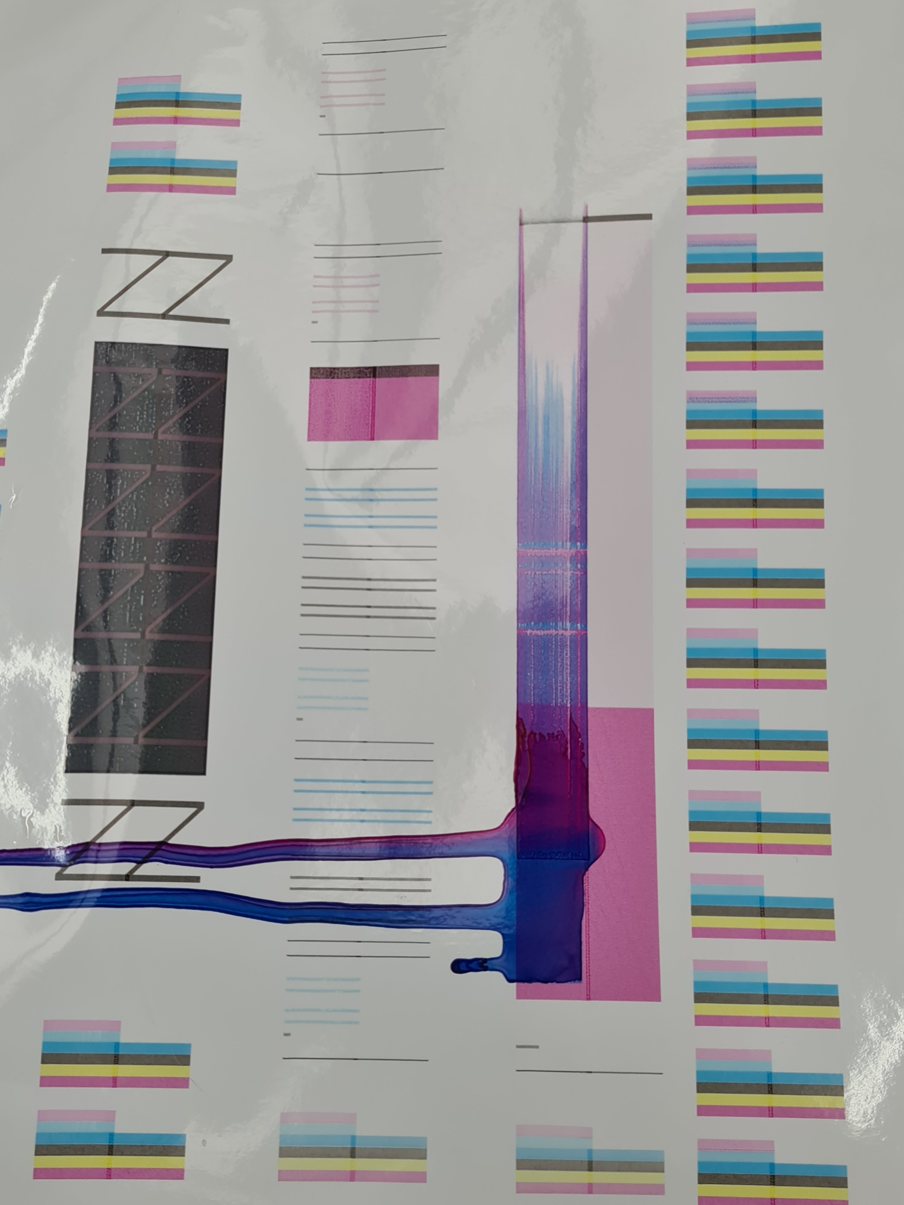

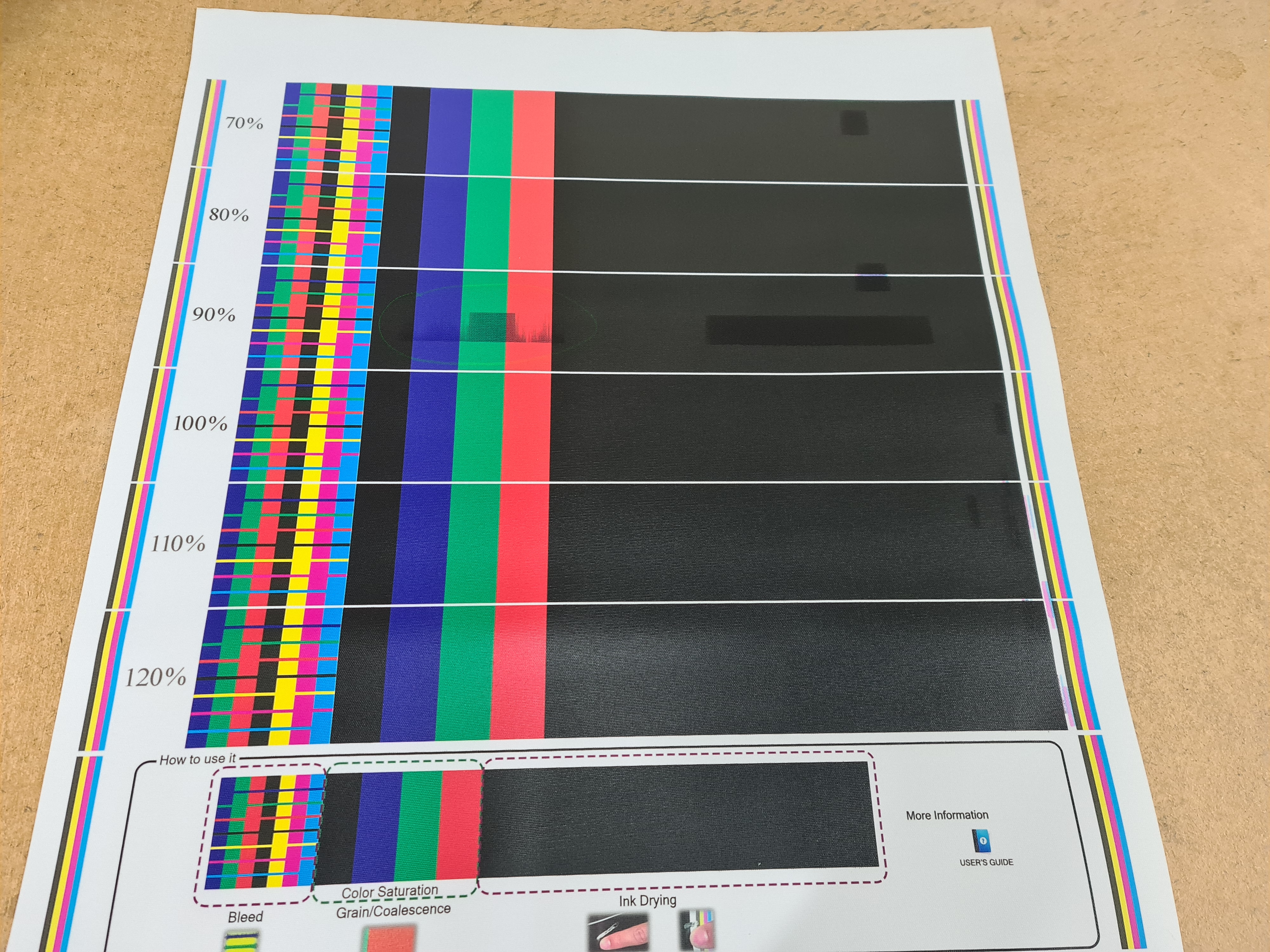

I got this used L570 last October. It worked just fine for our canvas printings until recently.
It starts to show bleeding on black colour, then It shows random colour line or colour block in and out of the prints, even in printheads alignments and colour calibration.
What i did so far:
New MK-C printheads x2, old ones fired 8L.
New M-Y printheads x2, old ones fired 4L.
New LM-LC printheads x5, 4 were refused, one was sucessfully installed. old one fired 1.5L.
New Maintenance tank x1.
M, LM, LC inks are expired. new inks will come next week.

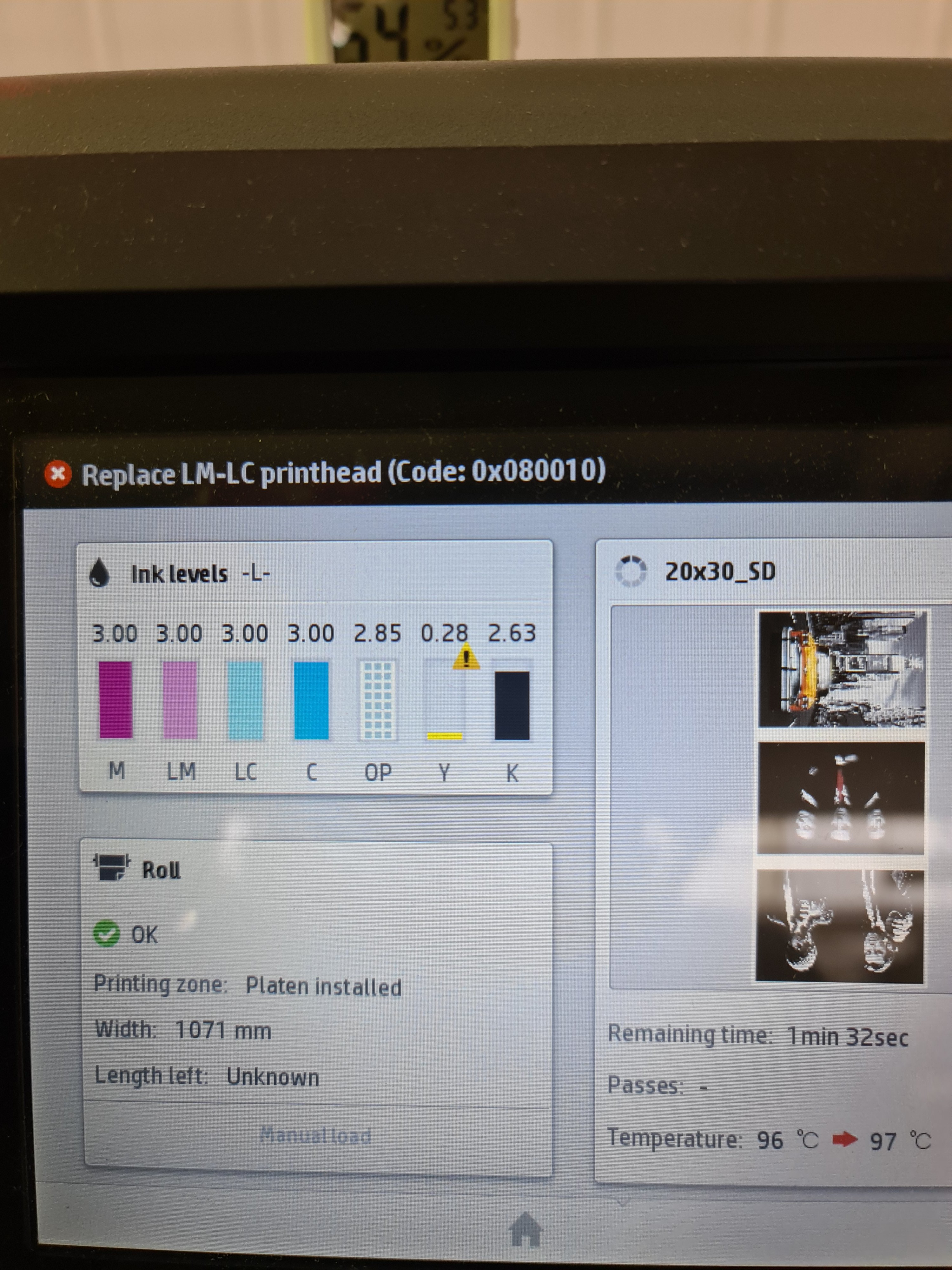

It reminded LM-LC printhead to be replaced last week after It stopped working. I had two backups, they were brand new, 2021-2022. so I tried to replace with those, but I got bleeding ink when it aligned the printheads, then failed. It showed error codes 0x080012 and 0x080010.
I thought my backup may be faulty, so I bought another 3 from different seller this Monday.
One LM-LC finally installed successful. However it will still print same random lines when i print printheads status report.
I guess I won't be that lucky to have 4 faulty printheads only. it must be something else.
The error message happened so far are:
I really appreciate any advice before I call the engineer, i run out the warranty.
Here are some photos.
- The troubleshooting process could not identity the failing part. Please contact support and provide the information appearing on the screen. Printhead LM-LC , Status: Reseat , Error code: 0x002002.
- Status: Replace Printhead LM-LC Error code: 0x080012.
