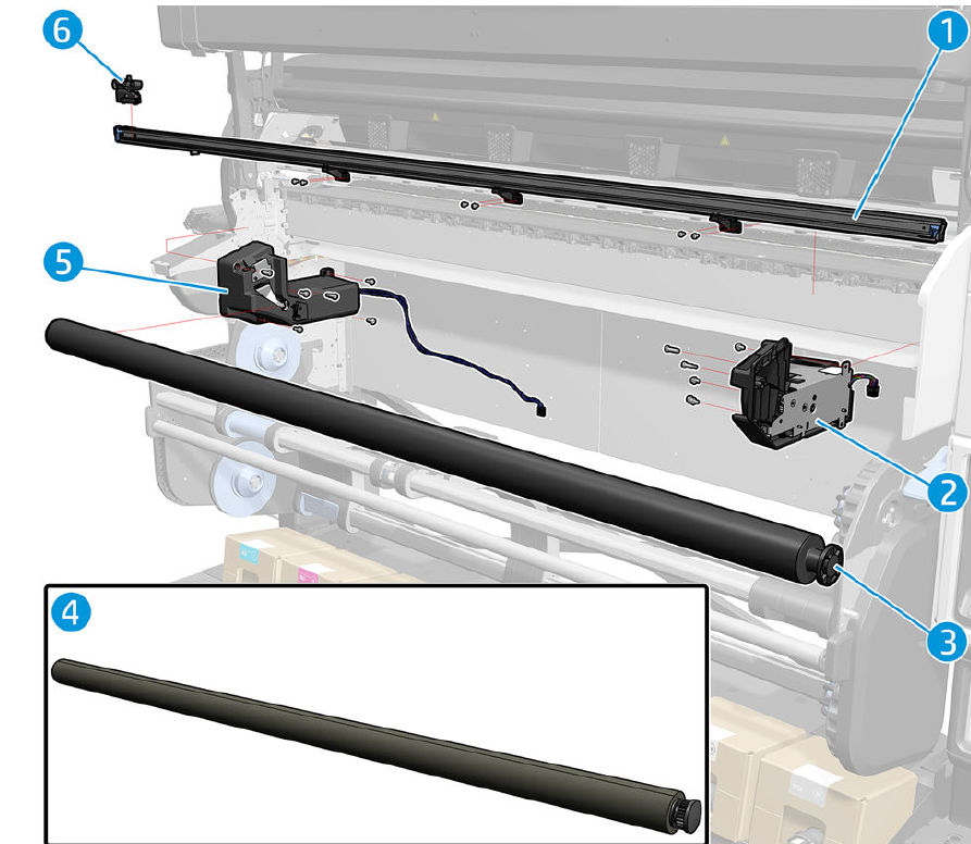

Thanks, I'm not sure I know what they look like so am having trouble locating them. Can you give me a picture or describe what they look like?
balstestrat
Problem Solver
Number 2&5. The curing unit has a metallic pusher on both sides that goes into those. You can figure it out by looking at it when lowering it.
Might be that the microswitch is not high enough or something.
