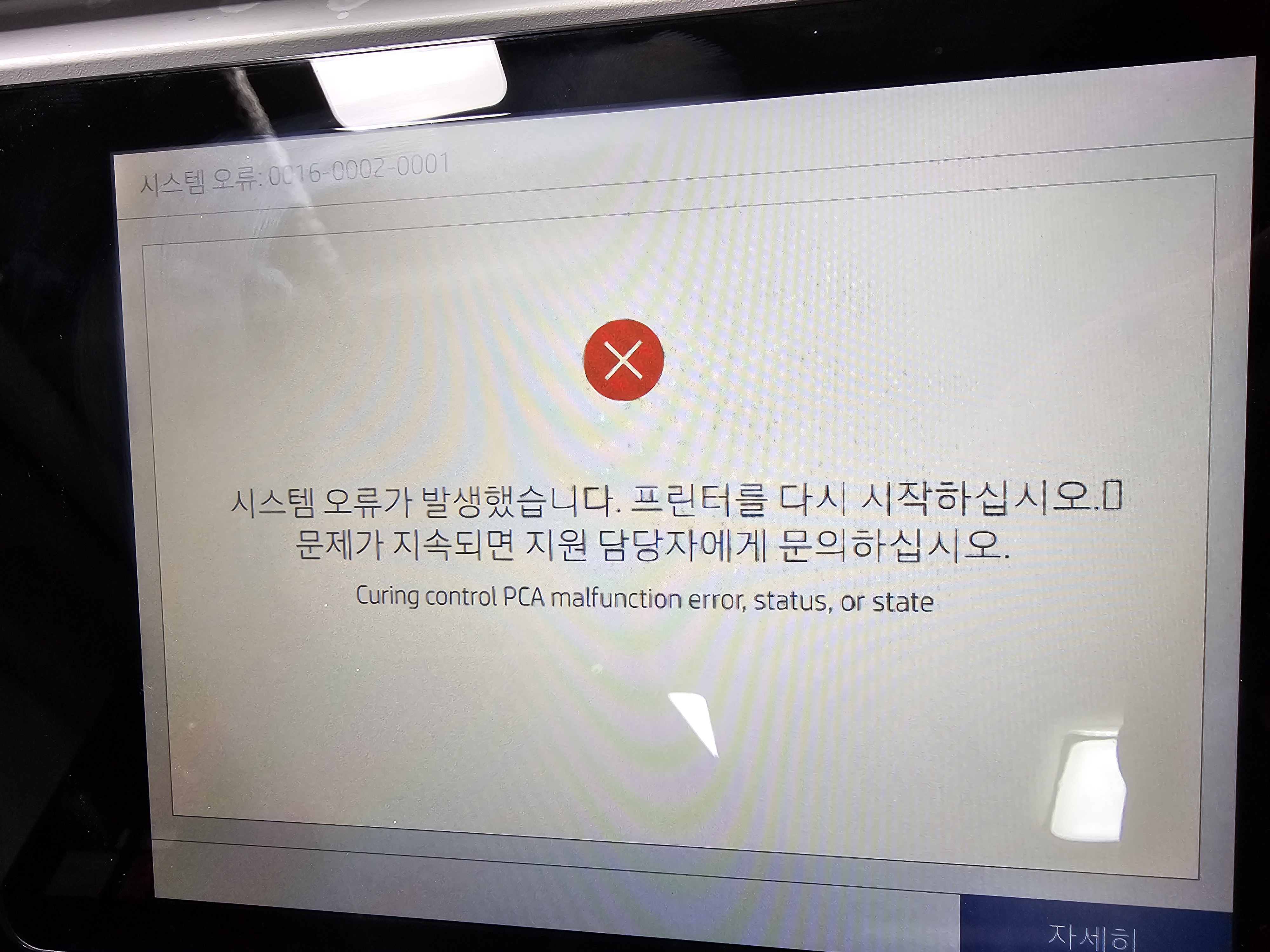

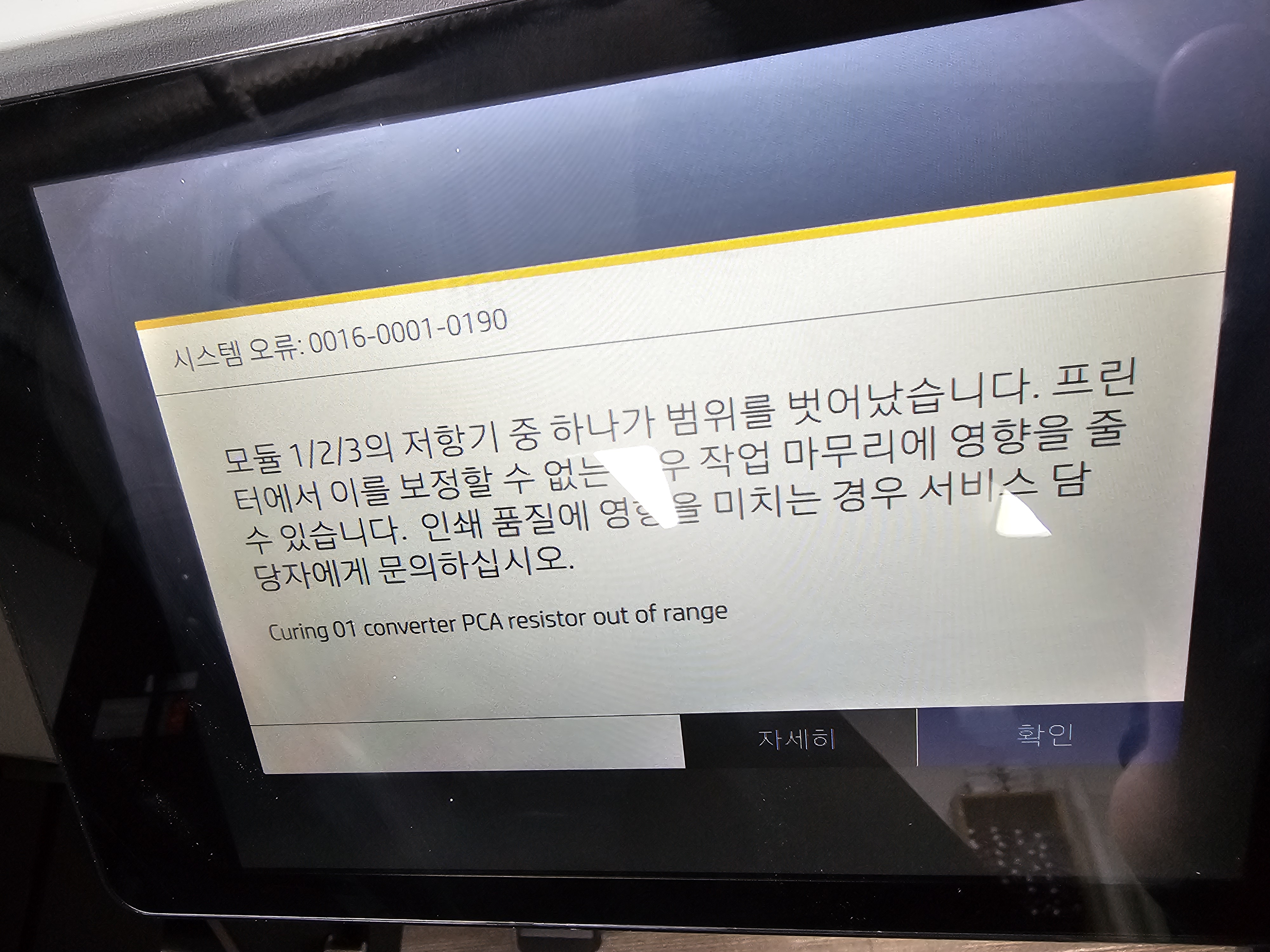

Initialization Loading 55% Warning
System Error: 0016-0001-0190
One of the resistors in module 1/2/3 is out of range. If the printer cannot compensate, it may affect the completion of the job. If it affects the print quality, please contact your service representative.
Curing 01 Converter PCA resistance is out of range.
Initialization Loading 80% Warning
System Error: 0016-0002-0001
A system error has occurred. Restart the printer. If the problem persists, please contact your support representative.
Curing Control PCA malfunction error, state or status

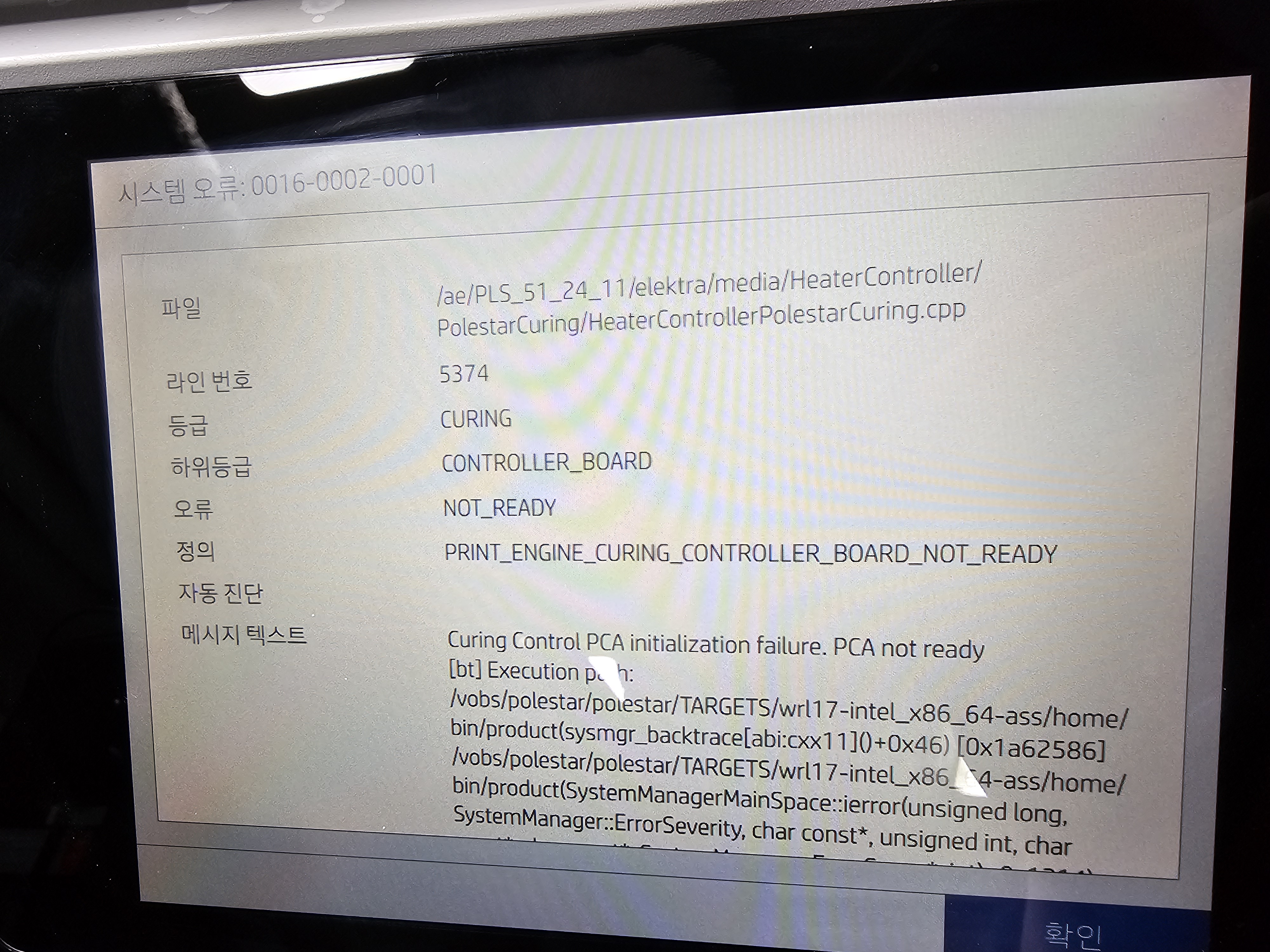

System error: 0016-0002-0001
File /ae/PLS_51_24_11/elektra/media/HeaterController/PolestarCuring/HeaterControllerPolestarCuring.cpp
Line number 5374
Class Curing
Subclass CONTROLLER_BOARD
Error not ready
Define PRINT_ENGINE_CURING_ControlLER_BOARD_NOT_READY
Automatic diagnosis
Message text Curing Control PCA initialization failed. PCA not ready
[bt] pah run:
/vobs/polestar/polestar/TARGETS/wrl17-intel_x86_64-ass/home/
bin/product(sysmgr_backtrace[abi:cxx11]0+0x46) [0x1a62586]
/vobs/polestar/polestar/TARGETS/wrl17-intel_x86_64-ass/home /
bin/product(SystemManagerMainSpace::ierror(unsigned long,
SystemManager::ErrorSeverity, char const*, unsigned int, char

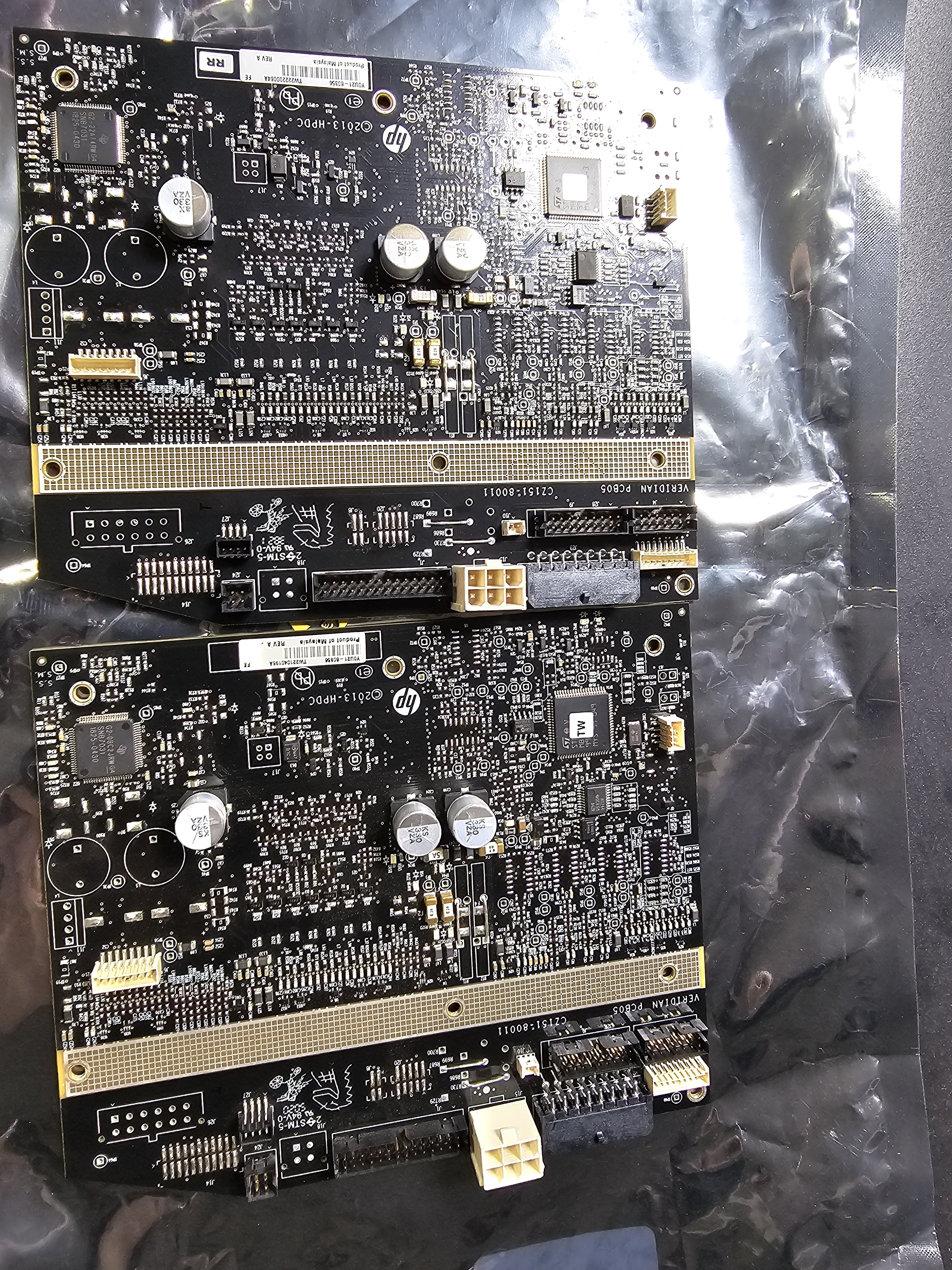

I got the above warning message and the authorized HP dealer replaced one of the two main boards(?) installed in the back of the computer, but it didn't work, so I borrowed another board from another company and tested it, replaced the power board, borrowed a cable and tested it, but it didn't work, so I'm going to contact HP headquarters. It'll take more time. Talk once Let's see.

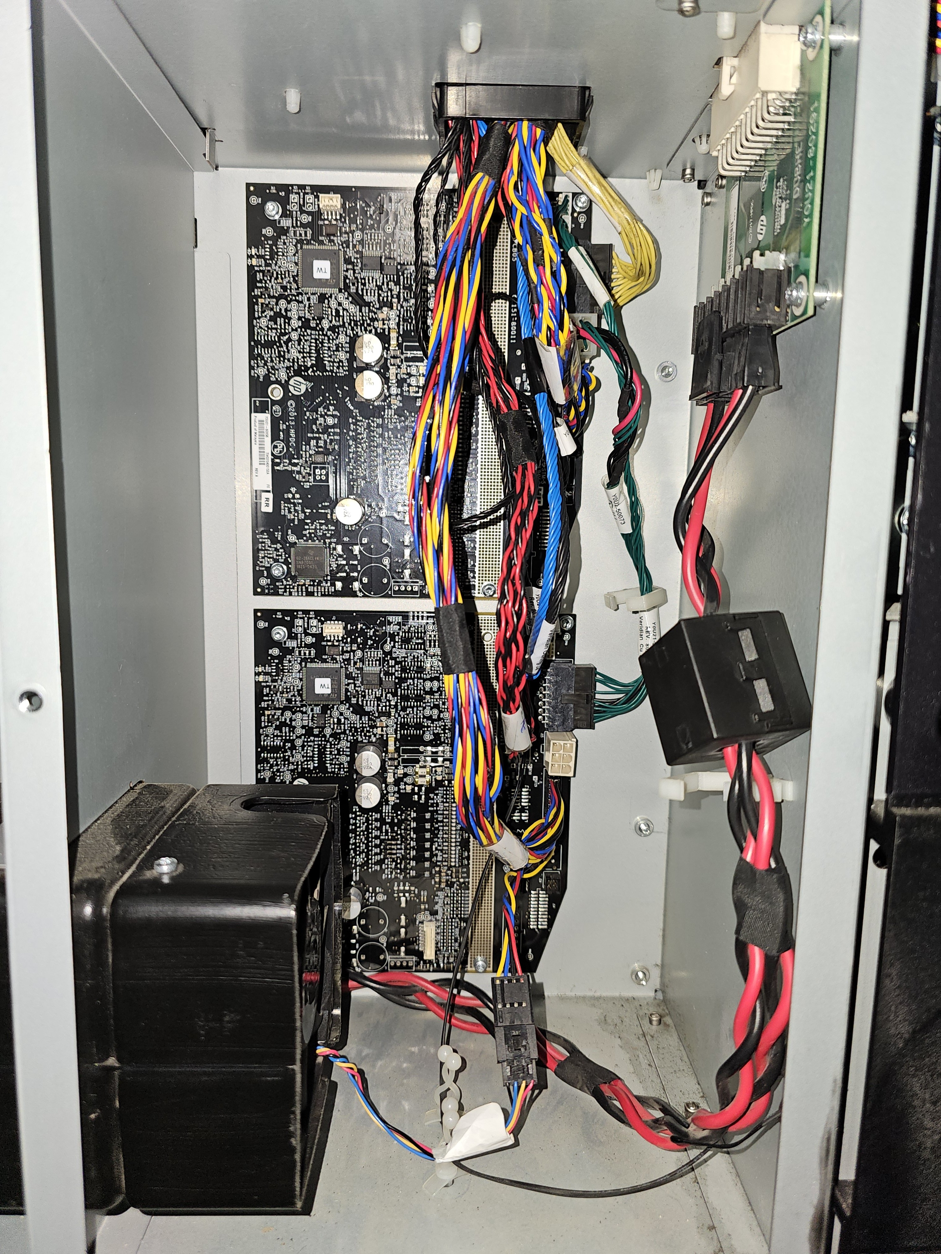

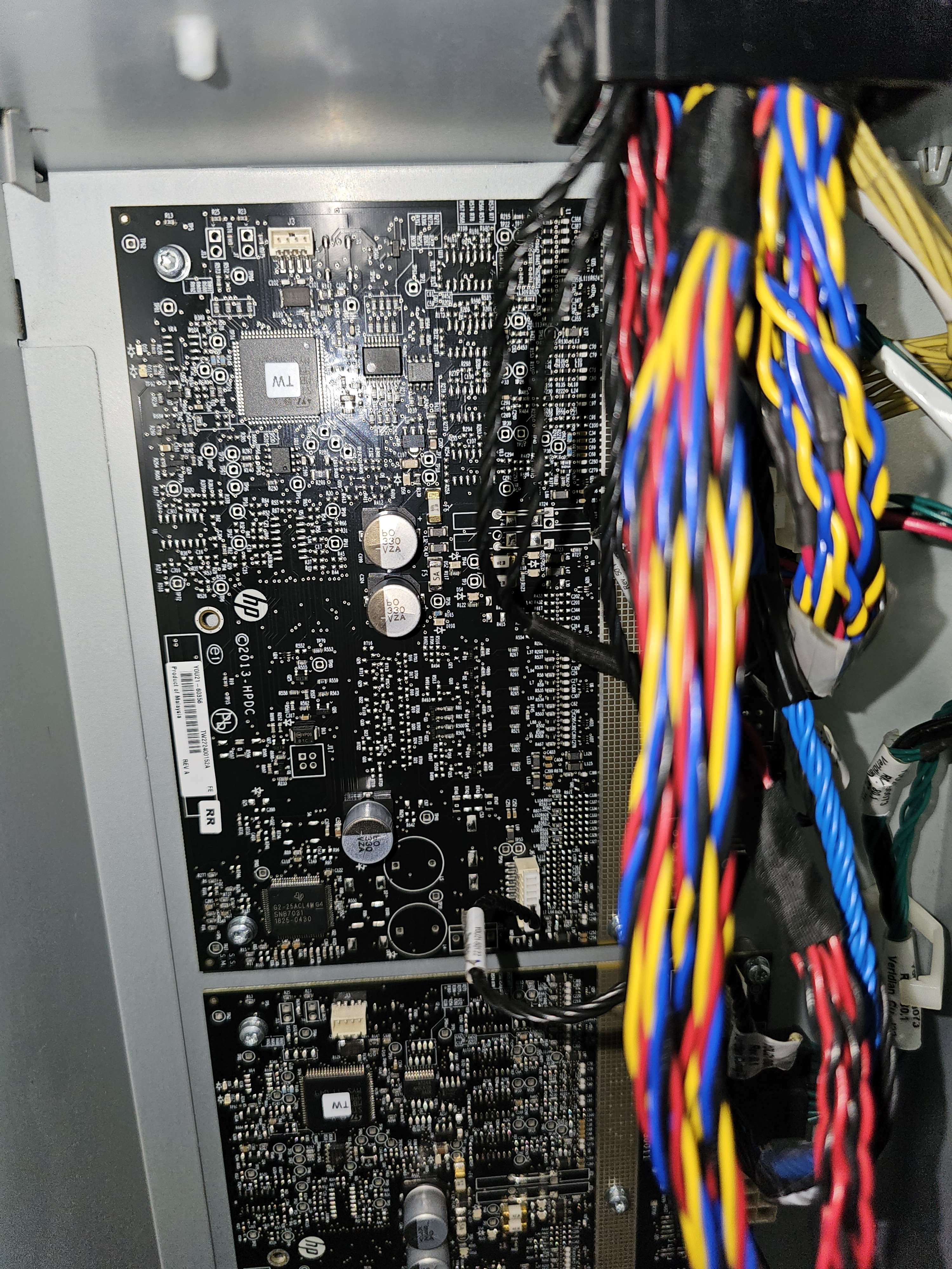

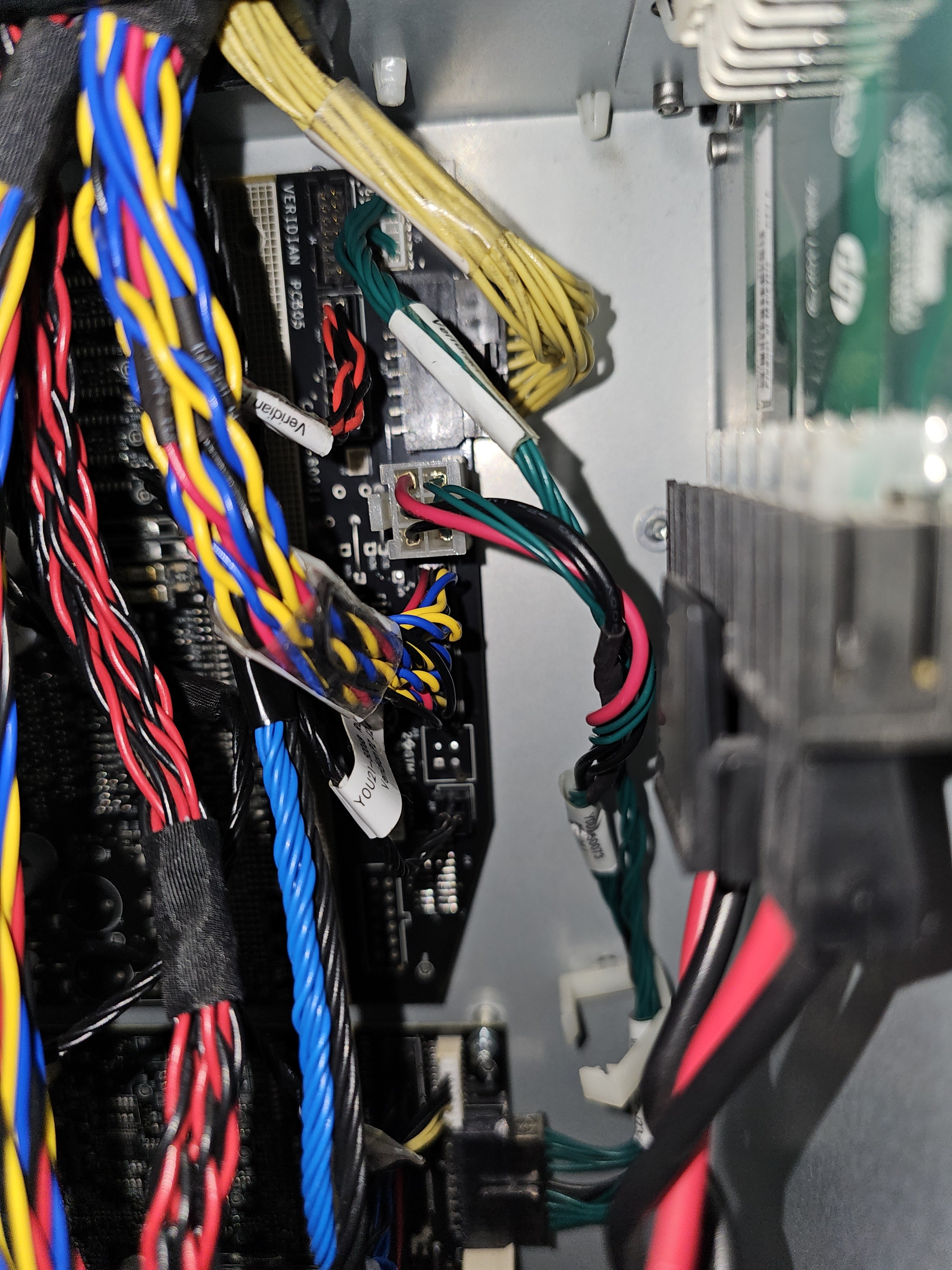

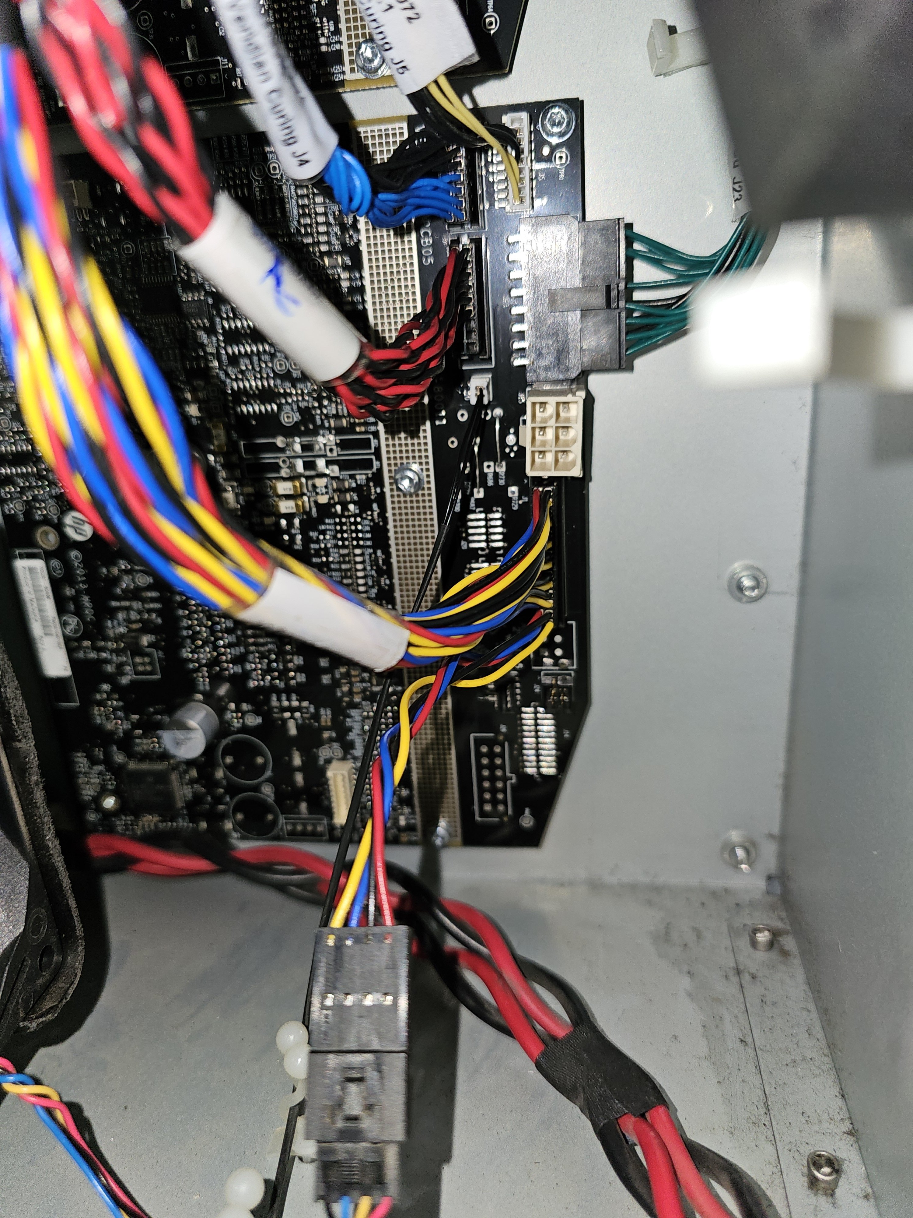

2Is the attached photo below the Curing Control PCA? It seems to be the same board, but the connection code is connected differently. Is it connected correctly?
