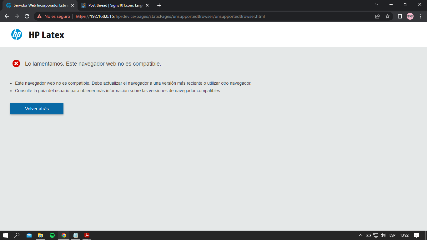

I'm having an issue regarding the EWS on the Latex 800W. Whenever I try to connect to the web interface on any browser its says that the certificate is not valid and then an HP web comes up saying my browser is not compatible with this interface.
I try every common solution (cleaning cookies, reinstalling browser, different browsers, etc) but nothing seems to work. Im hoping someone with knowledge on this matter can help me out.

You have to revert back to older version of your browser. Next firmware will fix it and let "newer" browsers in.
I think someone fucked up and didn't think browser version could go over 99 so fast...
Downgrade the web browser to any supported version:
• Microsoft Edge 82 to 99.
• Apple Safari 12 or later for OS X 10.13 and later (web kit major version 605 or later).
• Mozilla Firefox 77 to 99.
• Google Chrome 83 to 99.

The current release of the Firefox browser (99.0.1) is compatible with current firmware. As mentioned, all current browsers will be supported in the next firmware release.

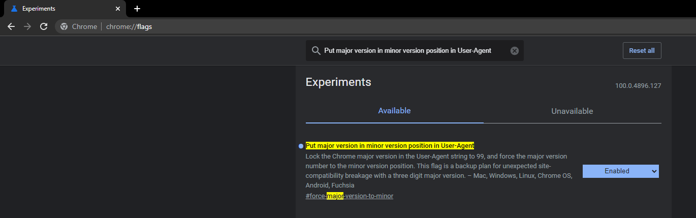

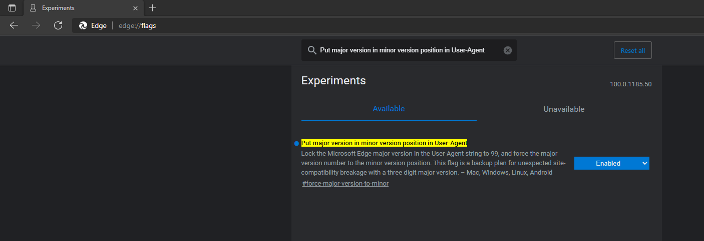

Another work around is to use a built in function in Chromium based browsers. Below are the steps on Chrome and Edge.
Google Chrome:
type chrome://flags/ in the address bar
Find "Put major version in minor version position in User-Agent" in the list and enable it
Restart Chrome and you can use the current versions.
Microsoft Edge:
type edge://flags/ in the address bar
Find Put major version in minor version position in User-Agent in the list and enable it
Restart Edge and you can use the current versions.

Ezek0
Google Chrome:
Microsoft Edge:
Good info, thank you
