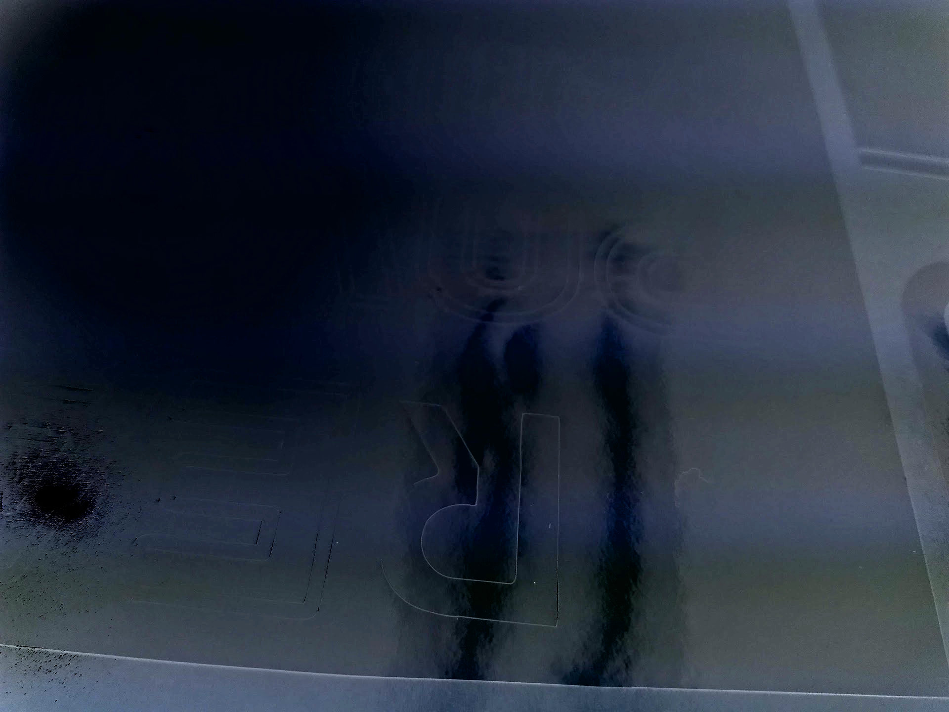

But today it did not finish my cut (attached image, colors are inverted to be easier to see).
Software: Flexi Print&Cut 12
Cutter: HP Latex Cutter Basic 54 - ethernet connection
It was file for my shop, so no biggie, file size around 650kb. - lot of small stuff, paint to weed.

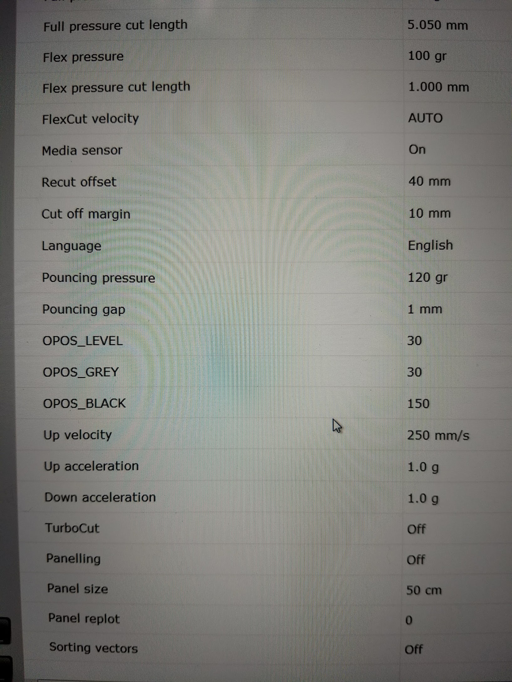

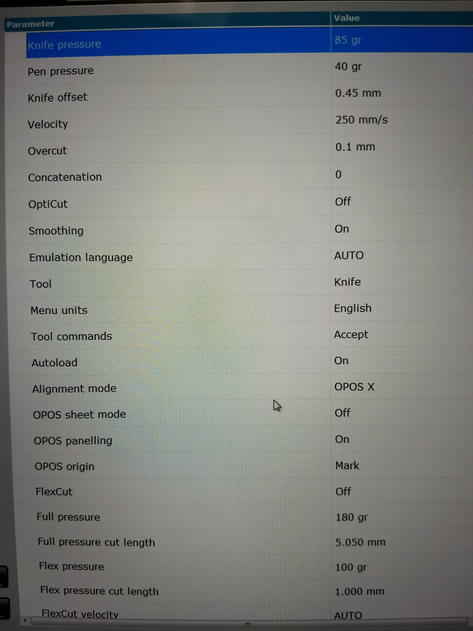

Does anybody know how do I need to change something in HP Cutter Control?
Also I uploaded picture of my settings.
Any idea?

i've had something like that happen before, IIRC I think it had to do with my paneling setup in my plot/cut dialog, but i would expect it to move and make the finishing cuts in another place on the roll if that was the case.
