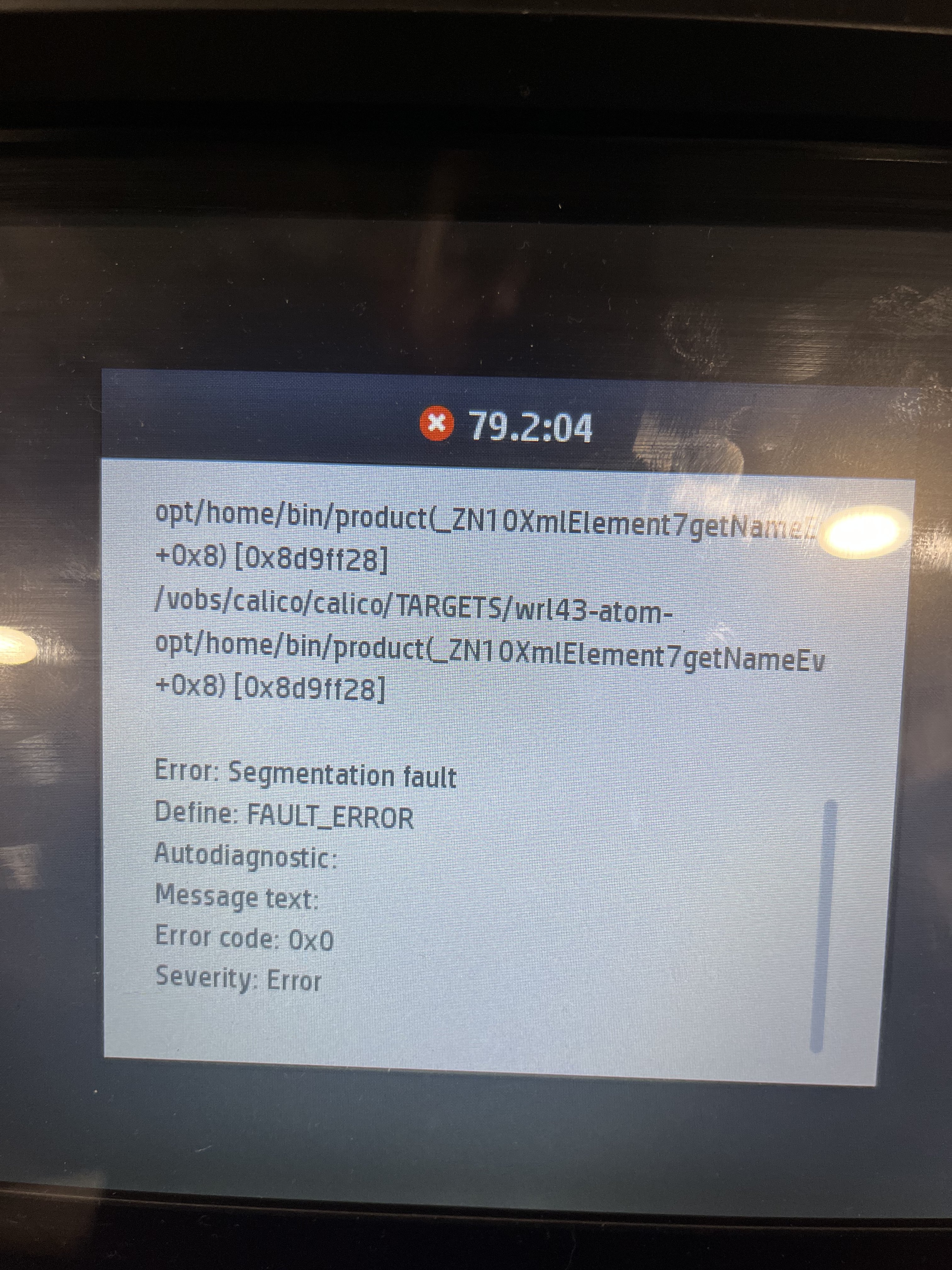

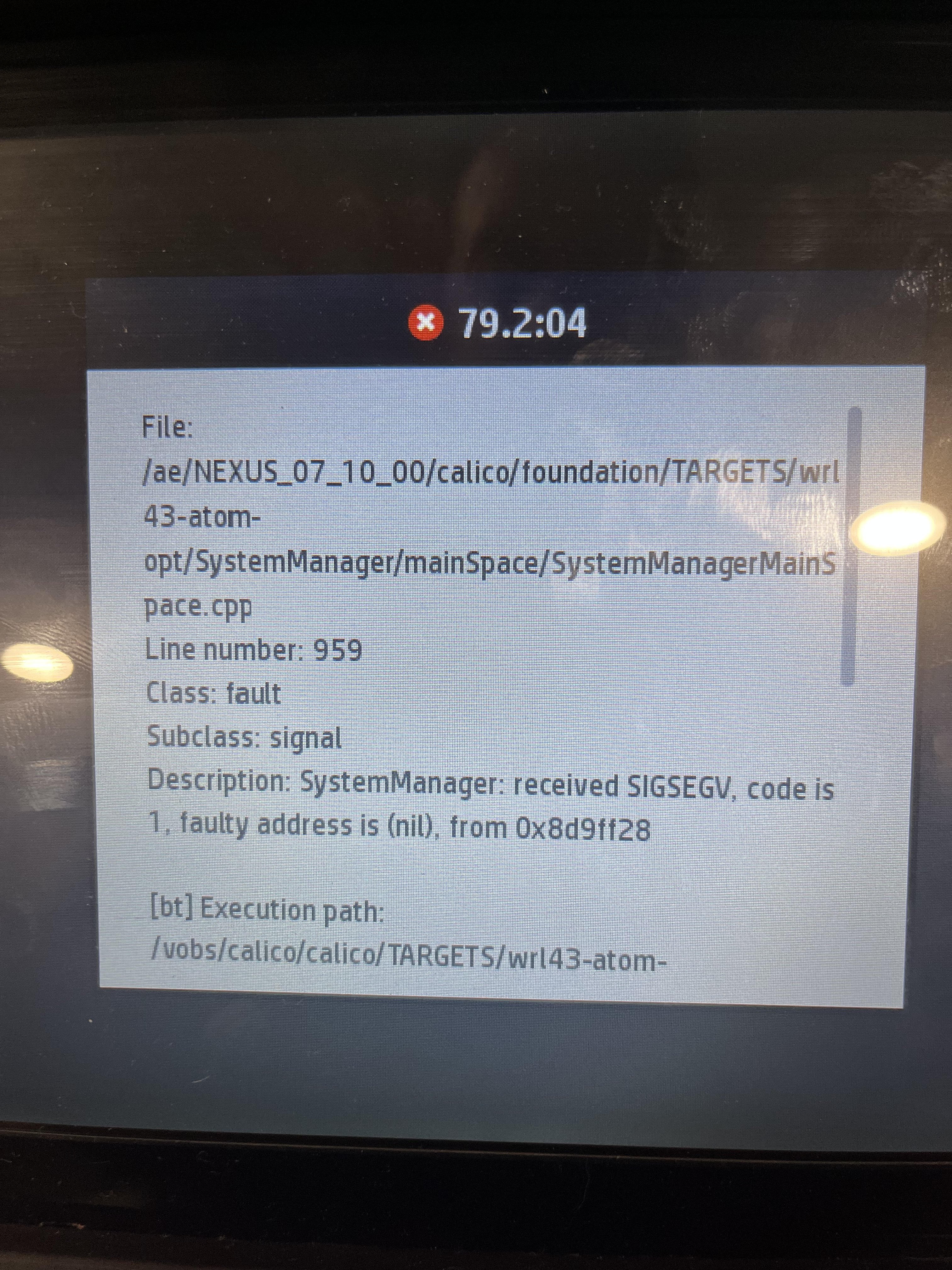

I’m having an issue with my 365 and need help. Getting a general error code. See attached photos. Any thoughts?

Would you care to show how you submit job from the EWS? Take a screenshot for me pls.
Update the printer firmware to current version, either through a USB stick or via the Embedded Web Server interface. Here is a link to current firmware:
In the event that the firmware update fails, run the Hard Drive Recovery and then install the current firmware.
