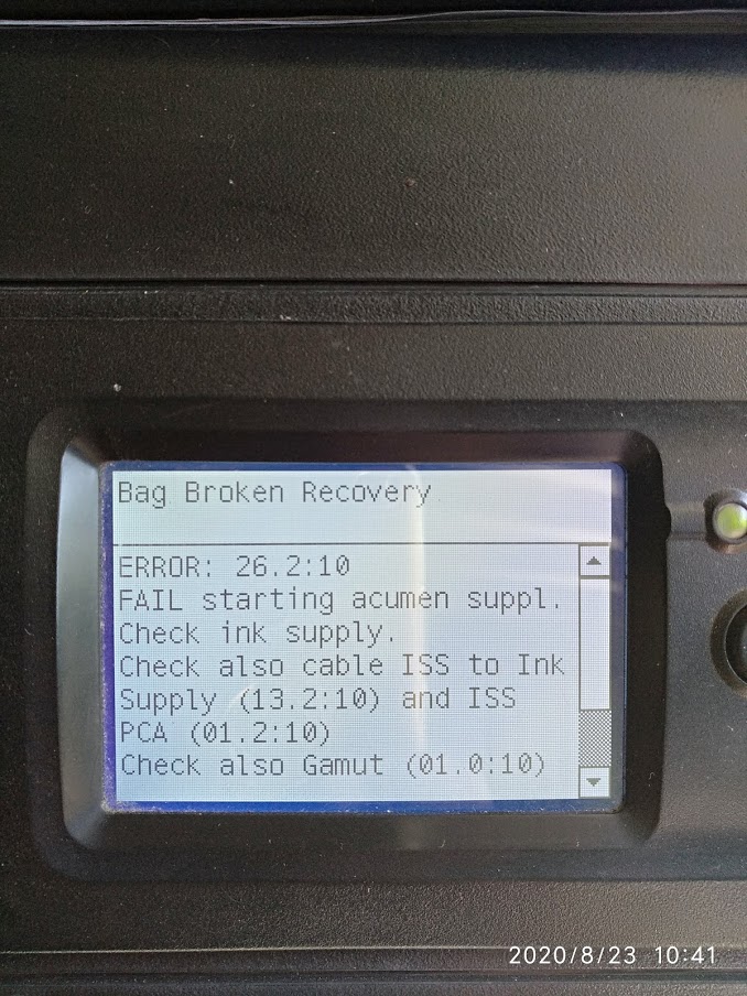

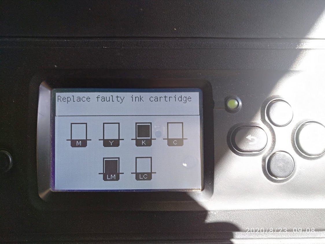

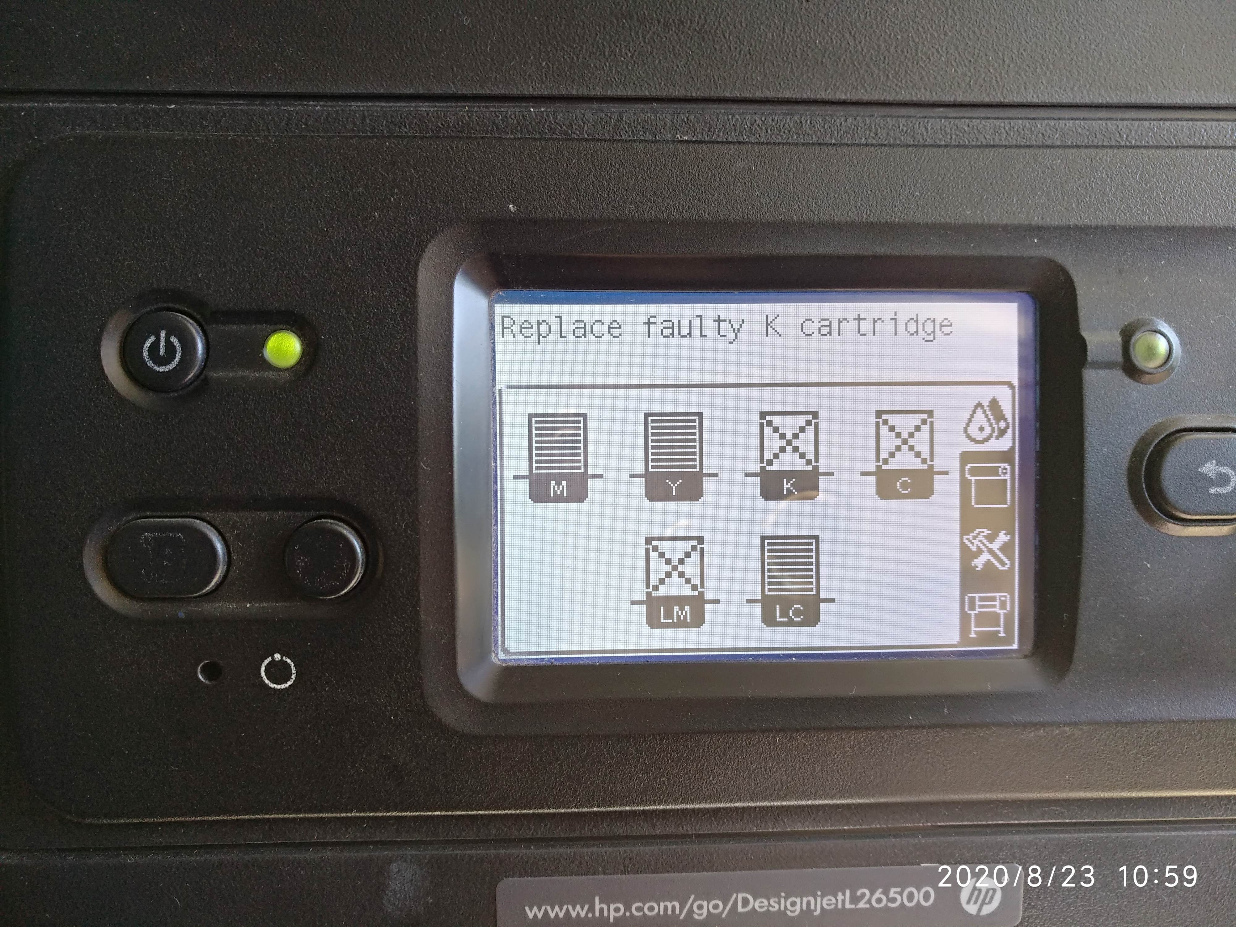

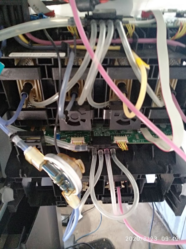

I have HP Latex L26500 printer. In my printer Light Magenta keep rejecting cartridge after replacing to new cartridge.
It show me broken bag and ink went to Light Magenta air tube back of printer.

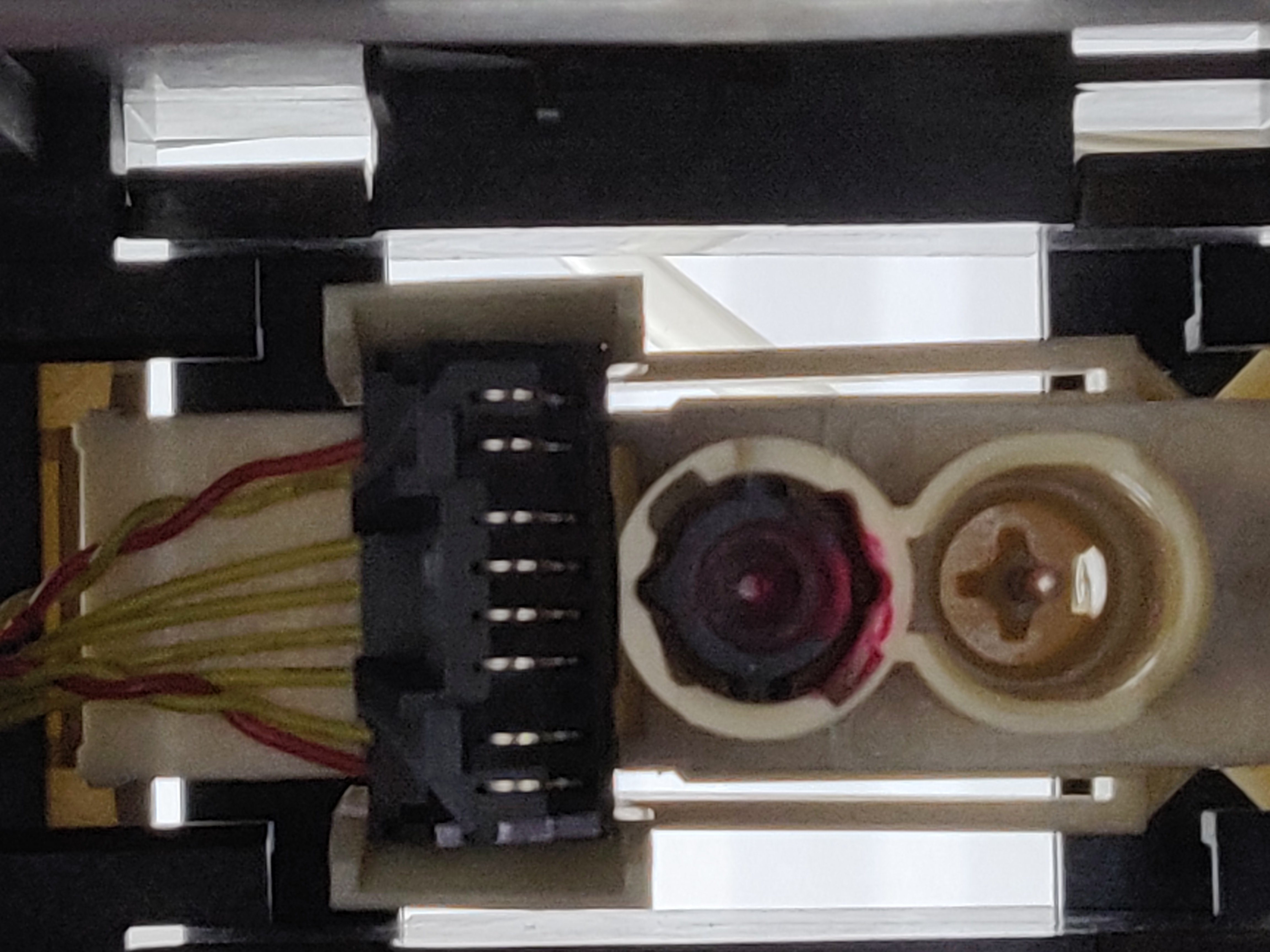

I have replaced to new cartridge after cleaning all ISS contacts & ink supply cartridge contacts with Petrol but keep rejecting new cartridge. I did following steps.
I have same problem.
After replacing Light Magenta to new cartridge got broken bag error.
What I did.
1) Try to recover broken bag from service menu no luck.
2) Replace new cartridge no luck

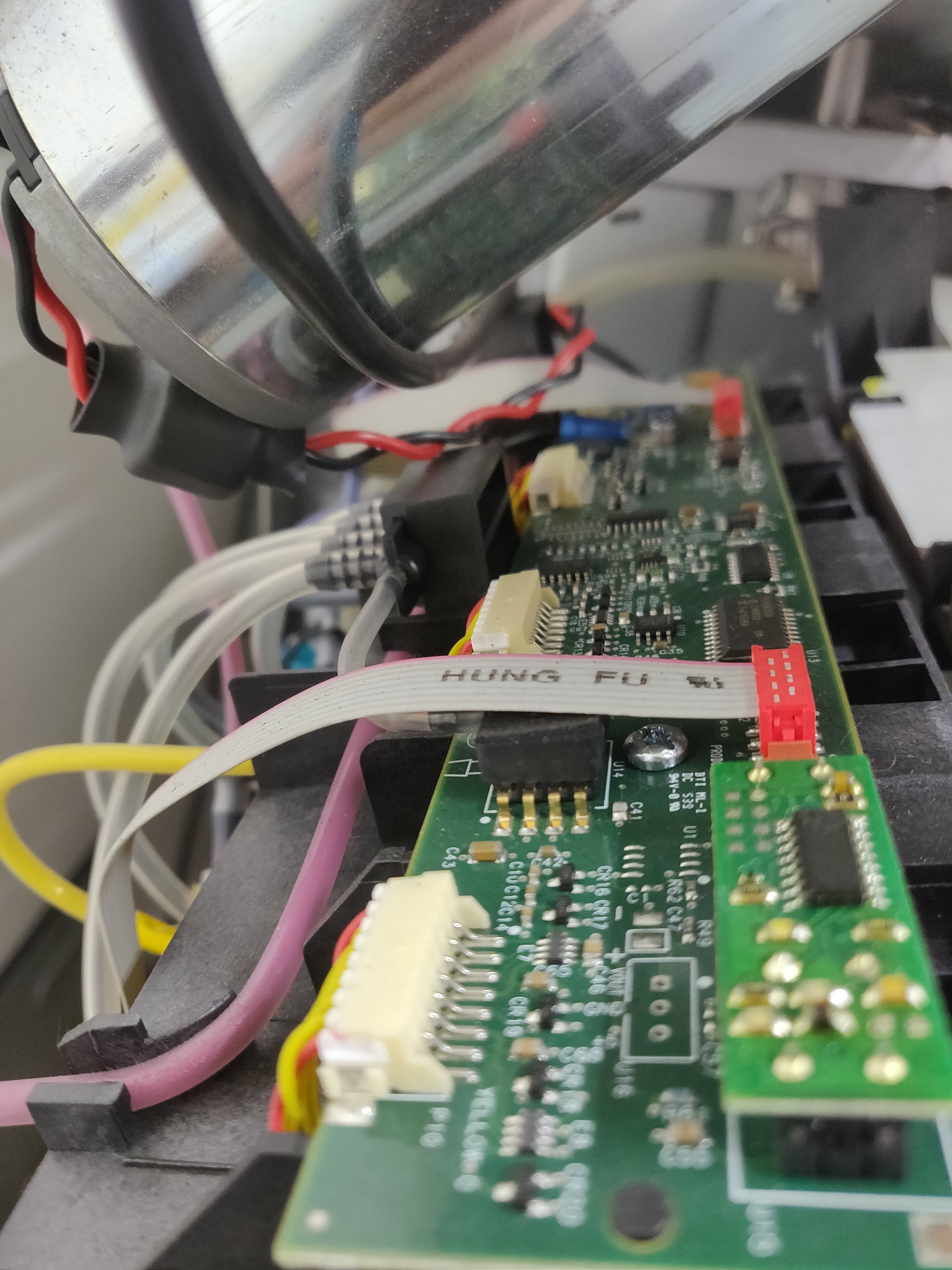

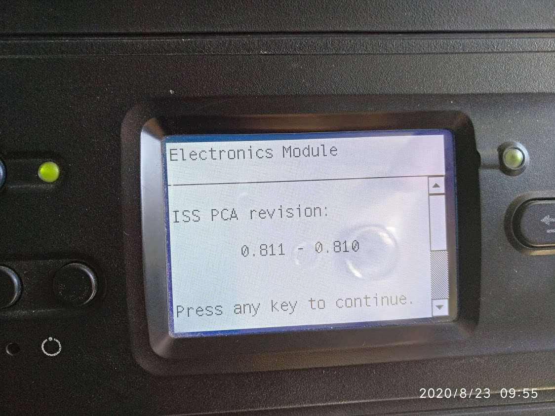

3) Replace bottom ISS no luck
4) Replace cartridge connector no luck
5) Reset EPROM no luck
6)Recover Hard Disk no luck
7)Force restore firmware no luck
8)Force install firmware no luck
9) Purge ink by injecting air in cartridge by locking cartridge & suck ink from carriage. To clear any air. (YouTube method)
10) Replaced 3 cartridge brand new but no luck
11) Use 789 ink cartridge in place of 792 & it says wrong cartridge so ISS reading cartridge & contacts is contacting cartridge.
This way I verified everything is talking to each other.
Why it is keep rejecting cartridge. All cables are ok.
Please help me......

IDK if this will help but on our R1000 we had a broken bag error once, and we had to clear the error code for it to take the new cartridge. Clearing the code was done in the service menu, and after that we did a bag replace diagnostic and followed the steps. Also had to replace a PIP sensor which had gotten a small amount of ink on it. The PIP sensor was the piece that the cartridge plugged into. Again not sure if any of this is relevant since we're on the hp r series but maybe this info will help you. Sorry you went down on a Saturday- that's the worst!

Thank you so much for your reply. We already clean connector with alcohol, petrol, air it is all nice and clean. We also replaced new. All electronic test pass. No short found. Ink Supply System talking to each other & other parts. Air pump is ok. All Cartridges holding air. All air test pass.Still no 2.jpg 4.jpg 5.jpg 6.jpg 7.jpg luck. No help from HP.

Finally found solution>>>>>>>>>
Replaced faulty cartridge & it work...........I don't know why it happen. Faulty cartridge remain faulty & new cartridge solve problem.
I can use faulty cartridge as well by replacing chip on cartridge which is available from China.
Thanks guys helping.
