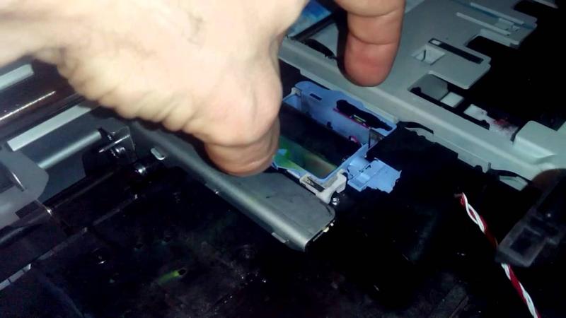

Christian @ 2CT Media
The Ink tube set also has a white strip on the opposite side of the funnels line
Here is an image I found online that shows it.
dypinc
There is a little indentation on the top surface of the MC. If it has been in the machine it will have black printed on it if not it will be white. You can cut some vinyl and put over top of where it has been printed black in that indentation if you want to try to use it again.
